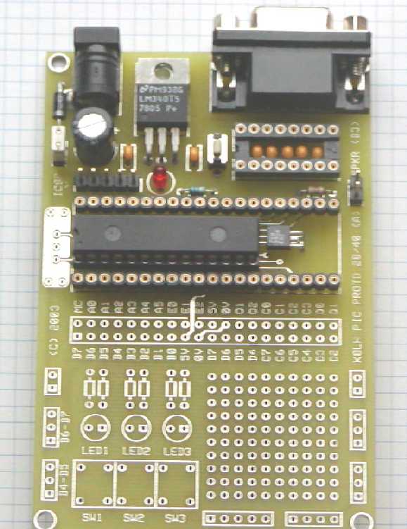

Nigel is correct... Too much "stuff" on a single board is not always the best way to go...
Here's a picture of a 28-40 proto' board I designed when getting started almost 2 years ago...
Regards, Mike

Mike,
Are the four holes at the sides of the ground plane for the crystal for caps? Looks like the middle three holes are for a ceramic resonator, with the center hole for ground. And the holes at the sides probably connect to the crystal on the underside?
Mike
Neat design Mike. Would you happen to have the PCB layout in some printable file format?
Mixing your board with Nigel's small boards and a solderless breadboard area would make an ideal all-around solution IMHO, at least for me.
Hi Joel,
I've got the ExpressPCB layout for that board if you'd like... If you download the ExpressPCB program from ExpressPCB.com, you'll be able to load and then look at the layout... I think I paid $59USD for three boards from them...
Regards, Mike

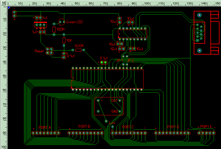

Hiya Guys,
Well it took me a few hours work but below is etching pattern for the development board I've designed. If you can take a look at the drawing and see if I made any errors I'll appreciate it as this is my first attempt at this sort of thing. With the reset circuit I got that straight from the 16f877a datasheet and I'm not sure if I have the resistor values correct. Hopefully I have everything correct.
Cheers Bryan :D

Hey Bryan! Looking good for a first effort.
I might be full of baloney, but to me the 820 ohms resistor in series with the 10K is useless. What is it for?
You sure that 7805 is hooked up correctly? My batch of 7805 uses pin 1 as input, pin 2 as ground and pin 3 as output. So in my case, your circuit would be wrong (pins 2 & 3 reversed), but maybe your 7805s are different?
Apart from that, it looks damn good!
Hiya Joel,

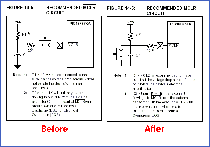

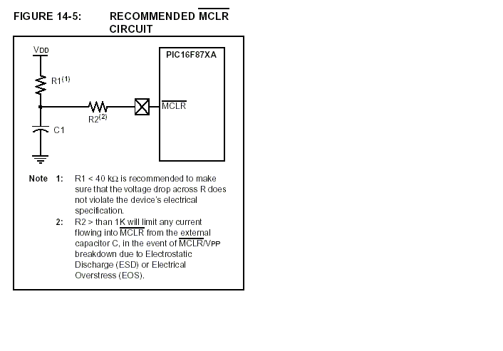

Thanks for pointing out the regulator, you are correct, silly me never checked the pinout with the data sheet I just used the labelling straight off the macros. As far as the mlcr circuit, below is an excerpt from the data sheet and I just used the first resistor under 1 K in the drawing. By the way Im using sprint layout software which is a good program in my opnion.

Hi Bryan1,
Regarding the MCLR pin:
In your layout you are connecting/disconnecting the pin from the rest of the circuit.
You should really connects the switch between junction of 10K and capacitor and ground.

Does this mean I can delete the 820 ohm resistor ? I thought I made it to suit the picture shown in the data sheet.

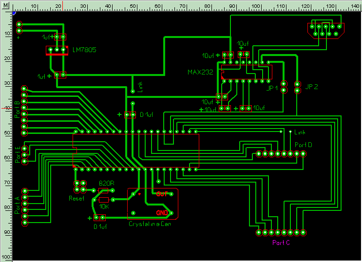

Hiya Guys,
Many thanks to Nigel for suggesting putting power and ground lines on the port output pins :D , also thanks to L.Chung for putting me in the right direction on the mlcr circuit :D . Well I started from scratch and below is a copy of mark II of the board. I've spent hours going over it and can't see any errors so hopefully it's ok.
Cheers Bryan :D

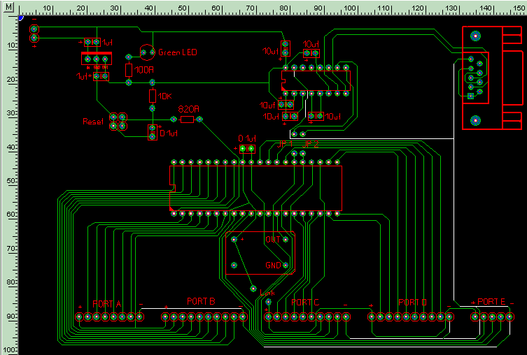

Hi Bryan1,
In you second layout, the +5V does not reach 877 and the port pins. It stops at the MAX232.
In addition, I can't tell from the gif whether you have connected 0V of MAX232 & the rest of the circuit to the 7805(note the white trace).
Also check the polarity of capacitor on MAX232 pin2.

Thanks for pointing out those errors on the board L.Chung, after spending about 4 hours working on it those simples things seem to slip through. After taking a closer look I also had a few other caps wrongly polorised and how I managed to forget the power to the pic ( well it was a long night). Anyway I'll have a go with the press-n-peel paper tomorrow and get the board made up, and thank you for the support mate greatly apprecieated. :D
