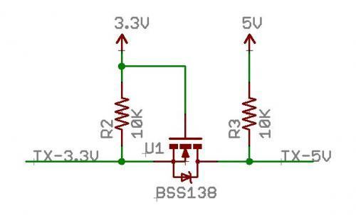

A lot of sensors will only operate on 3.3v max.
Adding an I2C 3.3v interface using a pair of bidirectional level shifters is probably a good idea.
A second pair of level shifters might be nice for other digital sensor types.
I've used this circuit many times. It's simple and compact. For an I2C interface I use 4.7k pull-ups. For general purpose use, I use 10k pull-ups. 2N7000 or 2N7002 mosfets work great in this circuit.

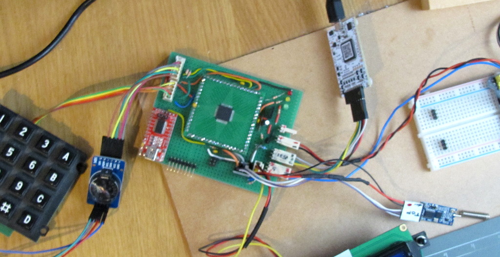

I have "developed " many ( too many) PIC boards , with various projects in mind, personally i would think BIG and fast (16MIPS) , PIC24 or dsPIC33 with at least 66 pins (53 IO) ,Go for biggest program and data memory (1024 / 32 kb) provide some dedicated peripheral connectors, I2C, Uart, SPI , PWM, ADC, even USB , Most PICs now have PPS to allow fexable external pin connections , include at least one LED to flash at startup, Vdd at 3.3v but some IO are 5v tolerant Power for the Dev board for my projects is best left external .

My project has master students as target. 8 bit PIC is ok. Max 40pins. through hole components if possible. I even think 5V is ok for the logic. It's their first "serious" approach to uC. Everything more powerful would be an overkill IMHO.

A good philosophy, the pilot of a Boeing 747 probably started his flying career by learning in a Cessna.
I agree.. walk before you run , i started like most i guess with 8 bit PIC16F84 and asm. back in 2000's , but as soon as i moved to C , i realised 8 bit is a bit restrictive, especially with Interrupts and math code .
