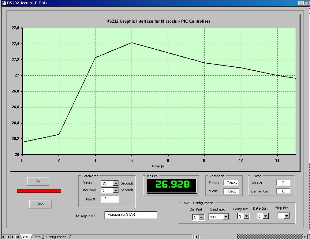

Hello,
Hope everybody is ok.
I have been messing around with RS232 and have built a temperature monitoring circuit using an 18F2420. I can send temperature data to Hyperterminal. Pretty basic stuff I know for you more experienced guys but for me it's like, WOW!
Anyway, what I would like to do is send / import the data to Excel so that I may create a graph of temp' vs time. Could you please advise if this is possible and if so give me some tips to get me going. I've not done any programming apart from simple ASM although a few years ago did do some very basic stuff with the VB that is 'included' with Excel.
Thanks in advance for any help.
PIC Data to excel
hello,
you can use PORT.DLL under excel with Vba
here is an example, how to use this dll

i tested it successfully, wit PIC16F application .. see my web page paulfjujo

a 3e solution is to use VB6 to build a data server
witch drive the RS232 link and then , use DDE link with an excel sheet.

Thanks for your replies.
I used this program to send the data to an excel file.**broken link removed** .I have just downloaded MS VB2008 Express and will play with it for a bit to see if I think it's within my capabilities to design my own little logging app'.
