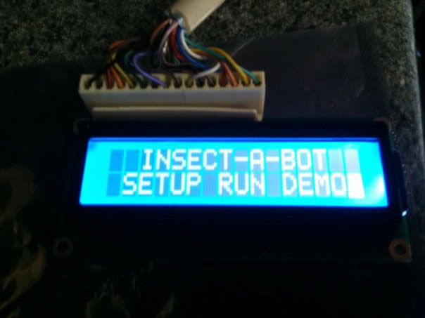

Hi all, Ive been playing around with the code again this evening. I now have the handshaking (LCD - Busy) working. The problems now seem to be
There are 'extra' spaces added at the end of the message. The loop seems to ignore that 0x00 is set and continues. This then causes and endless loop at the 'addwf 02,f' line of code. It never gets to jump to the check_switches bit. Is this the XORLW?
New code v2 attached.

Hi thanks for that Eric. I have been looking at the 4bit idea and think i'll do that further down the line if only to free up a few data lines. The marcos look interesting. I haven't done any yet but I get the idea. Infact my new code which I have attached could very much do with macros now. I have to do it this way first though to get a firm understanding of what im doing. Hopefully my step by step approach will help others too. I am now at the point where I can start branching to other sub menus from the switches. At present all switches just call a clear screen routine. I think I probably need a delay on reading the switches as sometimes switch 1 clears and then goes back to program (weird debounce maybe?). Anyway thanks for all your help im slowly getting there.
Paul.
