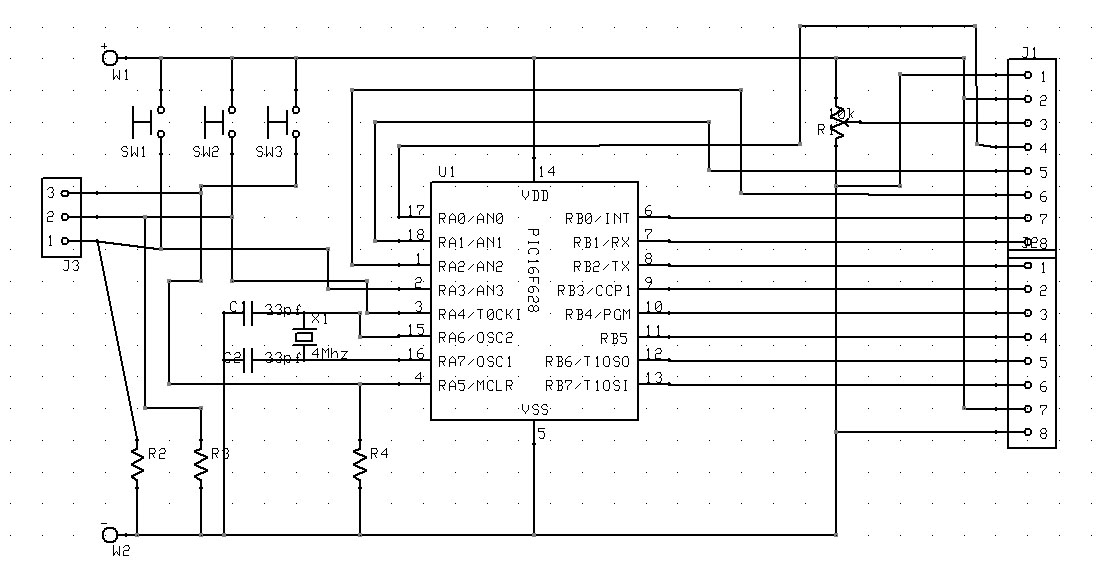

PIC 16f628A -LCD Control
SwingeyP
Hello. Can anyone tell me whats wrong with this code / circuit.
The idea will be to have a menu here and the 3 buttons select an option. (im not that clever though yet)
At present I am just trying to write to the LCD ignoring the busy lines and using a delay. I think you'll see what im doing. However nothing is happening. I have tried the pic on my test board and i would have at least thought i'd see a few led's light up on port B.
Any ideas?
Many thanks Paul
  • LCD_Paul.asm

Thanks. I have seen that tutorial before and its very useful. However I need to know what's wrong with the above. Is it code or electronics? - Nothing will be learnt from just copying the code in the above tutorials.
after i read your code I thing you should use (ORG or CODE) directors to identify the beaning
of the program, which will be written in the program memory like this:
start CODE 0x000
goto start
Interrupt CODE 0x004
goto int
main CODE 0x005
goto main
I hope that I helped you

i fear your delay loops were not in order
now i tried to change them, ( me too a learner),see the code below now works

perhaps it can be simplified further
This is a common problem for most of microcontroller fans when try to use LCD, do not worry, you will solve it after you appreciate it.
Is it code or electronics? .
try to adjust the contrast of the LCD ( for hardware ) and the initialization of the LCD ( for program )
At the beginning try to get it work even by copying the code, then take your time to study it with peaceful mind.
Many thanks for amending the delay loops. Yes things appear to be working now on my velleman board (for what I can see) but still nothing on the LCD. First off I had all the outputs mixed up RA0,RA1,RA2. They didn't match the schematic / PCB. I have corrected that and stepped through the code using 'stops'. You can see the stops I put in the code commented out. I see everything I expect to see with a logic probe at all the stops on the velleman board but when transfered to my PCB I have The following :
Pin1 - Nothing detected
Pin2 - Low
Pin3 - Low
Pin4 - Nothing detected
Pin5 - Low
Pin6 - High
Pin7 - High
Pin8 - High
Pin9 - High
Pin10 - High
Pin11 - High
Pin12 - High
Pin13 - High
Pin14 - High
Pin15 - Low
Pin16 - Low
Pin17 - High
Pin18 - High
Looks like there is something wrong with the PCB Ihave made. Can any of you gurus tell me what is wrong please? - Pull up resisitors?
Regards - Paul

Hi. Can anyone please help me with this? - Im pretty sure its the circuit / PCB. Without the LCD connected to the PCB im seeing nothing on any of the pins (except the obvious power lines) with a logic probe. Its a really basic circuit so I don't understan why its not working. As I have said before all seems ok on my Velleman programmer/test board. Agggghhhhhhh...! - PLEASE HELP
hi Paul,
Are you saying that you have never seen the LCD working with this final program.???
Hello ericgibbs. Yes thats right nothing on the LCD. I can control contrast etc from the PCB I made but nothing else. Infact when I connect the LCD the pins go as above. With the LCD disconnected I get :
Pin2 - Low
Pin3 - Low
Pin4 - Low
Pin5 - Low
Pin6 - Nothing Detected
Pin7 - Nothing Detected
Pin8 - Nothing Detected
Pin9 - Nothing Detected
Pin10 - Nothing Detected
Pin11 - Nothing Detected
Pin12 - Nothing Detected
Pin13 - Nothing Detected
Pin14 - High
Pin15 - Low
Pin16 - Low
Pin17 - Nothing Detected
Pin18 - Nothing Detected
Some clearly wrong. I can control the LCD from a veroboard tester I made up from an article in EPE Feb 1997. That works with simple switching and I see characters. As I have mentioned before the code seems right. When I step through I see the outputs i'd expect on my Velleman programmer/tester.
Is this something to do with pull up/down resistors? Can the MCRL line be used as an input and do I need to configure anything other than cmcon and mcrle?
Im sure this is an electronics problem though.

Downloaded your program, will try it later today.
Hello again Eric. I have just tried the simulator package you mentioned. BRILLIANT! - I have run the program through it and it worked. Takes a while to get through those 20ms delays even at extremely fast.
I burned the chip (with the stop in the right place) transferred it to my PCB but no luck so it has to be something to do with that. I have no idea why though. It's a very simple circuit. I think im going to try removing the 3 switches and just going with the basic data and control pins to the lcd.
Thanks again for your help so far.
Regards - Paul
Regards - Paul
hi Paul,
Look at this link, you may find some one these Oshonsoft external modules useful.
With regard to those long simulation delays, its possible to use conditional statements in your program, so that the delays are shortened in simulation.
As long as the switches are not in the program, it should not bother you, I feel. anyway simulator showing is different.
I was sure when I posted the V2 of asm, as I tested it on mplab simulator and I saw the ascii code for the HELLO" on the PORTB..
but timings I was not certain, especially a single clock cycle for E line enable /disable
Hi Sarma. I changed the code again in V3 to have a 20ms delay on all actions. It's maybe too long for many of the actions but it will do for now. The specification sheet says that timings can be a lot less. I have this running now in simulation but not on the PCB I made. Is there something wrong with the configuarion word? Do I need to switch pullups on / off. This is very frustrating. All the circuits i have seen are very similar to mine.
