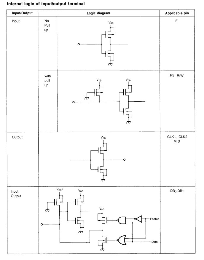

Hi Eric. Thanks for that. Very useful. However I still can't get this thing to work on the PCB. Can anyone tell me why there is no reading on PORTB with a logic probe on just the PCB. However when I connect the LCD board PORTB goes high all pins?
Something is clearly being pulled high - why?
This image from the LCD controller IC, note most pins are internally pulled up.

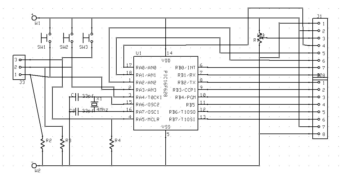

Do you have a wiring diagram to post.?
Only what I posted originally.
Here it is again.
I did find that original.
I see that you have pins 15 and 16 connected to +V and 0V, where is the LED back light current limiting resistor, you seem to be shorting out the +5V.???
Disconnect 15 and 16 and retry.
15 & 16 have a 10k variable resistor across them. This just adjusts the contrast. Surely without 15 & 16 you want see anything on the LCD at all?

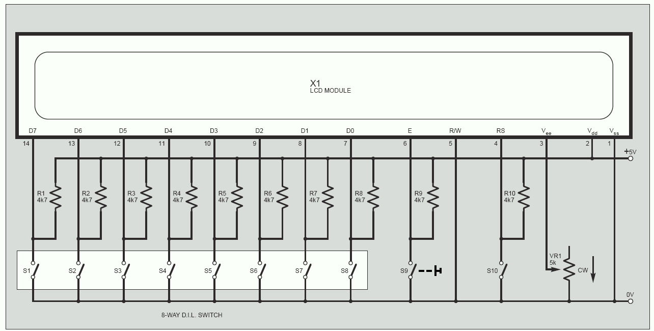

To prove my sanity I built this test rig and can prove that the LCD is working ok. I can set the control signals and data and everything works as it should. So I know the LCD is fine. ;-)

Yes I can see all of line 1. It's dark. I can also adjust the contrast.
That's an indication that the LCD isn't getting initialised correctly, once initialised you don't get the line of solid blocks on the first line. Even if you don't connect the LCD to a processor, adjusting the contrast produces the solid blocks on line one.

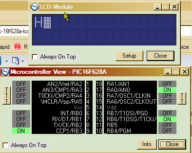

Write a simple noddy program to set PORTB high and low with a 0.5Sec delay between each high/low, connect an LED via a 300R resistor to a PORTB pin and 0V and lets see if the PIC is running.
EDIT:
This is your V3 program in Oshonsoft.
Note: 0x48 ['H'] on the PORTB output
Hi Eric. I use a Velleman programmer which has 6 led's on port B RB0-RB5. I can run the program with stops on the velleman and see everything fine. (Except the control lines). As you say the code is running on the simulator and I can see the hello message. I have stopped it after the initial setup for 8bits etc... and see 001111 (cant see the next two bits but im sure theyre ok) and done subsequent stops through the program until the letter H (48 hex - 000100 on the velleman). Everything looks fine.

I dont see any decoupling caps on the circuit diagram across the+5V and 0V, you should have 100nF and a 10uF.
