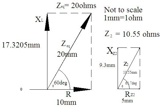

I have to be honest & say i wasn't sure if i had to just draw the phasors & angles as stated in 6.2 or if i had to try to draw the phasors just for the Impedance & to work out the impedance of Z2 from that, which is what i did--i think?.
Anyway i gave it a go & i don't really understand about the (J) in everything so see how i go, if i have no idea i would rather know about it & fix the problem.
I'll attach the diagrams--GULP!.
Thank You

That's very good.
The diagrams you drew are impedance diagrams not phasors. But they are correct.

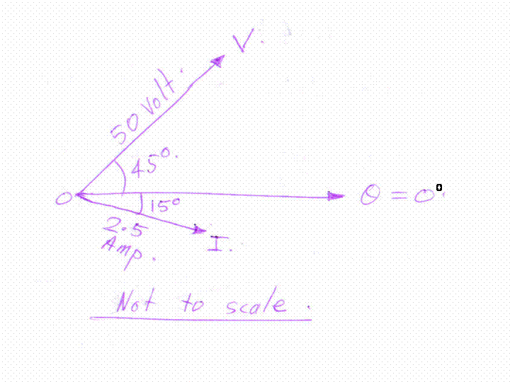

I have attached the phasor diagram.
It shows the voltage and current phasors. There is no point in drawing it to scale except for the angles as there is only one voltage & one current.
If you drew the current phasor on the same scale as the voltage phasor, it would be very small. If you were to add another voltage phasor, it would have to be scaled the same as the 50 Volt phasor.

Yes i drew the phasor diagram to start with using the values from problem 6.2 but thought it was to easy as the values etc were already stated & the problem was to find Z2. I was confused a little so i drew the Impedance as i had to work it out not knowing the math used.
I didn't know that the Impedance diagram i drew were not phasors though, i have just had a look at that & i found were someone has written that " although Z is complex, it is not a phasor as it is not a sinusoidal varying quantity."
So does that mean it is like resistance where it doesn't change the phase angle?

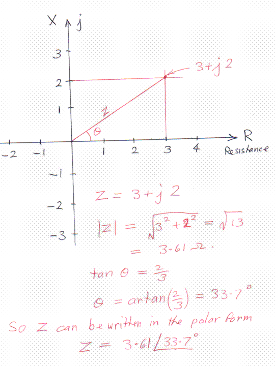

I have attached an impedance diagram for you.
In maths, they use i rather than j for the square root of -1.
They use j in electric maths since i is used for current.

It true that Z is really not a phasor. The term phasor is really just for voltage and current. This distinction is lost among many electrical engineers. They have never needed to think about it( I am not very clear about the distinction).
When using the polar form of Z, the magnitude Z comes with an angle so it will work as the go between for voltage phasor and current phasor. I think this is too much information for you at this stage . I recommend trying to be content doing the graphing and math at this stage. Deeper insight comes later.
I will try to give a beginners reason why you need the j stuff. In DC circuits, you can just add up the resistance of resistors for total resistance.. In AC, you just CAN'T add the resistance of resistors to the resistance of capacitor and inductors. You find the total with the use of complex numbers. The j keeps the values separate and reinforces the concept that you just cant add..
