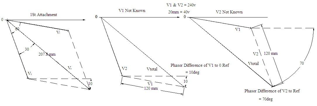

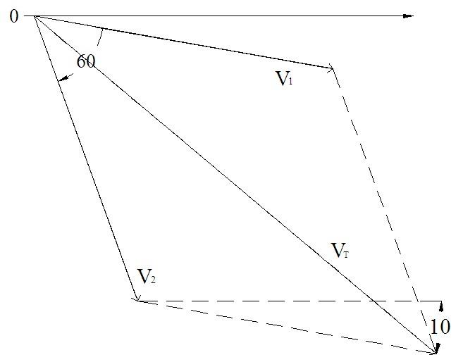

Hi Everyone,
I need to find the "phasor difference" between two voltages of the same value & differing in phase by 60deg?
I am unsure if that means the phasor difference between the two voltages themselves or the two voltages in relation to a 0 reference line or neither?
To be honest i am not sure about this as i have only done phasor addition etc.
The only information i have is that the "phasor difference" is the unknown side of a parallelogram developed from one side and the diagonal?.
I have taken a stab at it in the attachment below, i first worked out the resultant (Vtotal) of the two voltages as you'll see & then added what i think the phasor difference is (in this case 10deg) but this seems to be in relation to the 0 ref line--no idea?
I need some advice on this one?

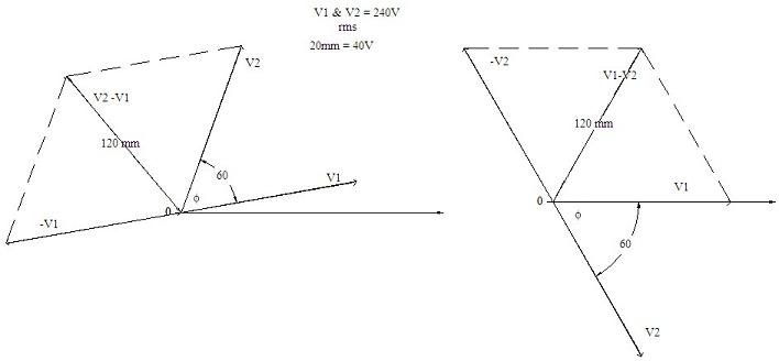

I'm not familiar with the term "phasor difference".
I assume it means the voltage difference between 2 voltages that are not in phase.
ie. V1 - V2.
If so, you would draw a line 180 degrees out of phase with V2 (ie. -V2) and then add it to V1.
Hi Len,
I have attached a couple of phasor drawings that i think are what you mentioned.
I am a little--well a lot confused about this Phasor Difference.
The Voltages V1 & V2 = 240V & the result from the method mentioned (if i have it correct) & the scale i am using also is 240V so i am not sure if i have done this correct or if the Phasor Difference is supposed to be in Degrees of the resultant angle which is 60deg but this is the original phase angle?
Thank You
Can you type out the question exactly as it was given to you and provide any diagrams? At the moment I don't understand the question.
Hi Mike,
The original question is:
Find the phasor difference of two voltages having rms values of 240v & differing in phase by 60deg. Use a scale of 20mm=40v
No Diagrams supplied.
Thank You
The question is vague. As I said, "phasor difference" is meaning less to me.
However, what the question appears to be asking is:- find V1 - V2.
So you have done the diagrams correctly.
The answer is 240 Volt with the resultant leading by an angle of 60 degrees as you have drawn.
(I checked it using complex numbers)

I don't mean to be a pain in the butt & i certainly don't want to waste peoples time but can we look at this in a different way just for a moment.
I have attached three diagrams on one sheet, the first diagram is the original attachment No1, the second is for (V1 NOT KNOWN) so to find V1 & the Phasor Difference in respect to 0 Ref.
The third diagram is (V2 NOT KNOWN) so to find V2 & the Phaser Difference in respect of 0 Ref.
The question says, find the phasor differences of two voltages, could this mean "individually" in respect of 0 Ref as i have tried to do in the attachment.
Are my diagrams correct for finding the "unknown values mentioned & the phasor difference" in respect to 0 Ref, if in fact that is what Phasor difference means, or am i way out?
You'll have to shoot me, as i find this interesting Haha!
Thank You

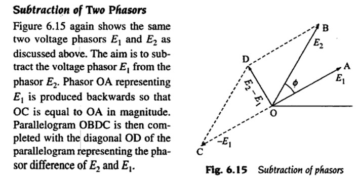

Hi Everyone,
I have just returned from a library where i found the elusive Phasor Difference-- I think!
Anyway i copied a part of a page that suggests what it is, i'll attach it.
So does this mean that the Phasor Difference is in fact the 240v resultant we had before, i'll attach it again?
Thank You

Hi mel8030
Thanks for the diagram, i have been told three times now to reference one phasor at 0 deg so i guess i should listen & do it correctly.
The phasor subtraction from your diagram gives the same result as the other method Len suggested, so i guess there is more than one way to skin a cat.
I found a phasor subtraction method, like the one i used before as suggested, i'll attach it.
