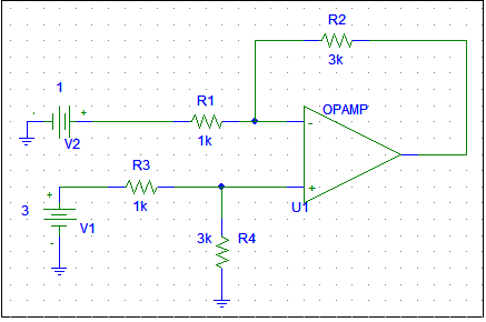

Dear friends,
Here's the difference amplifier I'm looking at, assuming the op amp to be ideal:
Its input resistance is defined as the resistance seen by Vi, as shown below, that is Ri=R1+R1.
For the right circuit below, knowing the input resistance as 2kΩ, I can tell that before the op-amp output voltage saturates, the ratio of the input voltage and the input current is equal to 2KΩ. But when I look back to its original circuit on the left, what can it tell us knowing the circuit's input resistance is 2kΩ? If the circuit's input voltage is V1-V2=3-1=2 Volts, what is defined as its input current? What is the purpose of defining the input resistance like that anyway? Thank you!

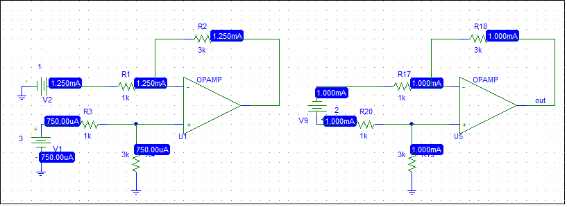

hi Heidi,
The two circuits you have posted are quite different.
Left is a standard OPA and the right is a OPA connected a Difference amp.
Not sure what your question is.?
E

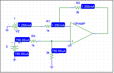

It was said in my textbook that the input resistance of the left circuit can be calculated via the right circuit, by applying a input voltage which is equal to the voltage difference (V1-V2), divided by the input current in the right circuit. My question is "what can such an input resistance definition for the left circuit tell us?"
When I think of an input resistance for a given circuit, I think of applying a voltage across the input terminals of the circuit, measuring/calculating the resulting current that enters one of its input terminals and leaves the other, then divide the voltage by the current and I get the input resistance. I can tell the input voltage is propotional to the input current. In the left circuit, the input voltage might be (V1-V2), but what is its input current? The current entering R1 and the current entering R3 are different.
Since the input current direction is into R3 and out of R1 for the given input voltages in the left circuit, a resistance calculation will give a positive resistance value for the bottom input and a negative resistance value for the top input.
Since the current and apparent resistance of the top input is modified by the input voltage of the bottom input, I don't think a resistance calculation of the top input separately from the bottom for that circuit is meaningful.
Only the differential input resistance measurement of the right circuit for a floating load is useful.
The circuit on the right has a floating input so the voltage referenced to ground has to float to a value where the two input currents are always opposite and equal.
For the given source voltage and resistor values that would be 4V.

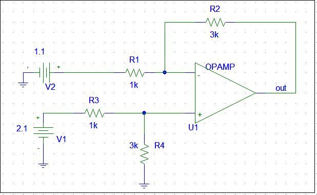

The applied voltages have both a differential component and a common mode component.
In the above sircuit, the common mode component is
Vcm=(V1+V2)/2 = 1.6
and the differential component is
Vd=(V1-V2)=1.
And
V1=Vcm + Vd/2 = 2.1
V2=Vcm - Vd/2 = 1.1
Correct? --------- (1)

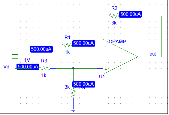

If you want to determine the differential resistance, you must apply voltages that have only a differential component such as a floating voltage.
Apply the differential component Vd=1 like this?
So the input resistance seen by Vd is (Vd/500u)=2Ω.
And by definition, this 2Ω resistance is the input resistance of the first circuit. Correct? ------- (2)

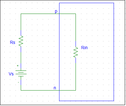

Please let me try to clarify my question a little bit.
The above diagram is showing a signal voltage source Vs with an internal resistance Rs applying across the input terminals (p,n) of a circuit which has an input resistance Rin. If we want most of the signal Vs is applying at the circuit's input terminals, then we should design the circuit to have an input resistance Rin that is much larger than Rs.
So returnning back to the first circuit (in which R1=R3 and R2=R4), what plays the role of a signal source and what plays the internal resistance and how do we define its input current? Can the first circuit be represented by a conceptual diagram like the third one?

In post #10, you made an arithmetic error. Where you have "So the (differential) input resistance seen by Vd is (Vd/500u)=2Ω.", the result is 2000Ω, not 2Ω.

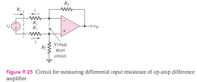

Three different input resistances can be defined for your left hand circuit in post #1.
If you ground the left end of R3 and apply a test voltage at the left end of R1, you will be determining the "driving point" resistance at that node.
If you ground the left end of R1 and apply a test voltage at the left end of R3, you will be determining the "driving point" resistance at that node.
If you connect a floating voltage source between the left end of R1 and the left end of R3, you will be determining the differential input resistance of your circuit. This is what you show for the right hand circuit.
If you connect the left end of R1 to the left end of R3 and apply a test voltage to both the left end of R1 and the left end of R3 together, you will be determining the common mode input resistance of your circuit.
So when you say, as you did in the title of your thread, "the input resistance of a single opamp difference amplifier", you have not fully specified what you're looking for. Just saying "input resistance" is ambiguous. You need to say "common mode input resistance", or "differential input resistance", or something fully specified.
