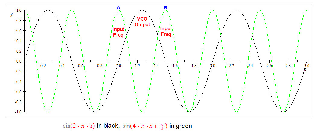

I think that what you are saying above could be related to something you said earlier; I've quoted it below at the bottom. The frequencies are not close enough; actually they are at the extremes. The phase detector output is not high or low for a long enough time that the VCO frequency can change enough to actually achieve phase lock. As you said, the phase detector output varies between minimum and maximum at around the difference between the mid frequency and the maximum lock frequency. But why is so that it varies between minimum and maximum at around the difference between the mid frequency and the maximum lock frequency?
Suppose that 90 kHz is mid frequency and maximum lock frequency is 120 kHz. The difference between mid frequency and lock frequency is 30 kHz.
It will vary between 60 kHz and 120 kHz.
The picture below is just to convey a rough idea.
For point A the phase detector thinks that input frequency is less than that of VCO and starts decreasing the voltage below mid value but as it doing so the point B confuses phase detector to think that input frequency is more than that of VCO so it starts increasing the output voltage above mid value. This results into a varying voltage. Do I make sense?

A phase locked loop relies on the frequencies being close enough that the phase detector output is high or low for a long enough time that the VCO frequency can change enough to actually achieve phase lock. It is very common to have a PLL where both the reference and the VCO frequencies are divided, to give enough time for a lock. If I have a 1 MHz reference, and a VCO that gives me 0.8 - 1.2 MHz, when the VCO is at maximum or minimum, the frequency difference is 200 kHz, so the phase comparator output will only be above zero for 2.5 microseconds, an the VCO might well not be able to respond that fast.
If both frequencies were divided by 1000, the phase comparator output will be high for 2.5 milliseconds.
