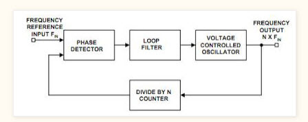

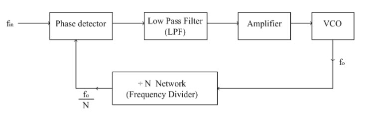

Could you please help me to understand the operation of a closed lock loop as a frequency multiplier?
Source #2 says, "Since the output of frequency divider is locked to input frequency fin, the VCO is actually running at a multiple of the input frequency. The desired amount of multiplication can be obtained by selecting a proper ÷N network.
∴Input to phase detector, fin=fo/N
∴fo=Nfin
I don't follow how the output frequency becomes N*f_in when the phase detector is fed with the reference frequency f_in and feedback N*f_in. I understand that the output of the phase detector is a voltage proportional to the phase difference between the two inputs. The low pass filter attenuates high frequency content. I don't understand how the output of the VCO is at a frequency that is N times the input supplied to the frequency reference input.
Block diagram #1:

Block diagram #2:
pll_2-jpg.117950
Source #2: https://www.electronics-tutorial.net/analog-integrated-circuits/phase-locked-loop/pll-applications/

It's ever so simple - the phase detector compares the output from the div N counter with the reference, and creates an error voltage accordingly, this error voltage alters the VCO until the output of the div N counter equals the reference. It's a basic negative feedback loop.
By altering the division ration of the counter, you can alter the output frequency.
Your problem may be that you are thinking in the "forward" direction through the block diagram ie Fin is converted to Fo.
Think of it more like this:
You have an oscillator running at some frequency, lets say 100MHz.
100MHz free running oscillators can drift due to temperature, voltage changes etc.
We want to stabilise the oscillator.
We have a good crystal oscillator which runs at 500kHz.
So lets make a phase locked loop.
We make the 100MHz oscillator so that it can be tuned by a voltage signal.
We make a digital divider, which divides the 100MHz by 200. We not have 500kHz.
We use a phase comparator to compare the divided 500kHz with the accurate standard 500kHz.
The output of the phase comparator and low pass filter is a DC signal which can tune the 100MHz oscillator.
We arrange the circuit so that if the 100MHz is low in frequency, the output of the phase detector/LPF/amplifier will tune the 100MHz oscillator up in frequency so that it is exactly 100MHz.
And similarly if the 100MHz is high in frequency, the output of the phase detector/LPF/amplifier will tune the 100MHz oscillator down in frequency so that it is exactly 100MHz.
Does that help?
The Vco goes into a divider, the output of the divider goes to the phase comparator.
The 2 freqs at the comparators input, ref freq and Vco freq are the same.
The phase comparator/loop filter generates a voltage that is comparable to the phase error (for type 2).
This voltage varies until the 2 phase comparator inputs are matched in phase.
Thats it, the comparator doesnt care what freq the Vco is, it just so happens in your case that the Vco is divided down, the chip still matches the freqs at the comparators input, it would still work if there was no divider.
Changing the division rate will change the Vco freq, the thing to take note is make sure the output freq is within range of the Vco's control.
Due to the way the complicated maths works (the function of the xor or whatever the phase comparator has) the ref frequency is multiplied by the Vco's divider ratio rather than divided.
In summary, the PLL tries to adjust it's VCO frequency so the the input frequency and the divider frequency output are the same.
All the rest follows from that.

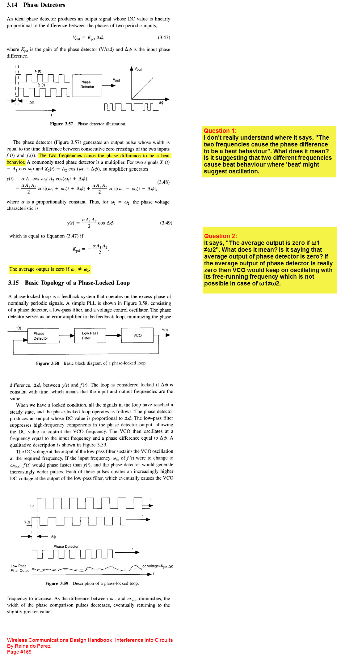

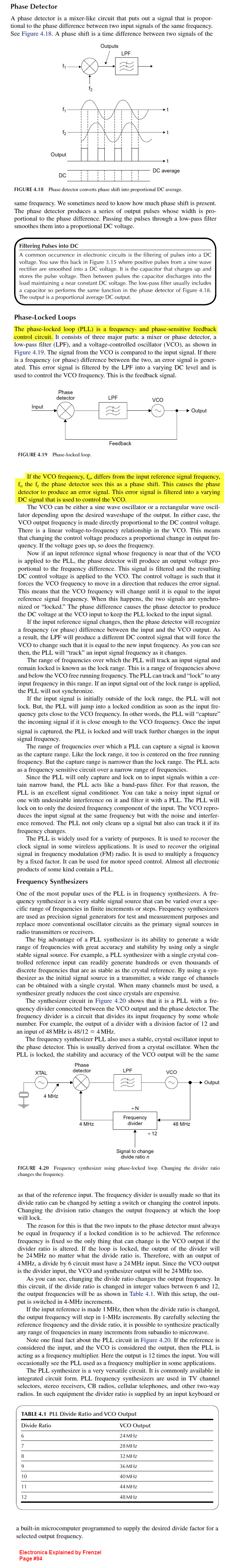

Could you please help me with the queries below? I understand that you might find it frustrating that I'm asking questions about the same topic but I'm only struggling to get a proper understanding of it. Thank you!
Please have a look on the attachment.
Question 1:
I don't really understand where it says, "The two frequencies cause the phase difference to be a beat behaviour". What does it mean? Is it suggesting that two different frequencies cause beat behavior where 'beat' might suggest oscillation.
Question 2:
It says, "The average output is zero if ω1≠ω2". What does it mean? Is it saying that average output of phase detector is zero? If the average output of phase detector is really zero then VCO would keep on oscillating with its free-running frequency which is not possible in case of ω1≠ω2.
Question 1:
Question 2:
Q1. By a "beat" frequency, what is meant is the frequency difference. In this case, if you have one frequency of 100 Hz, and one of 101 Hz, the phase difference between the two will take 1 second to go from 0 degrees (in phase) though 180 degrees (totally out of phase) and back to 360 degrees, or zero degrees, and back in phase again.
Q2. If the two frequencies continue to differ, so ω1≠ω2, then the output of the phase detector will continually vary from maximum (at 0 degrees phase difference) to minimum (at 180 degrees phase difference). If the phase detector has a maximum that is positive and a minimum that is negative by the same amount, then the average output will be zero.
A phase locked loop relies on the frequencies being close enough that the phase detector output is high or low for a long enough time that the VCO frequency can change enough to actually achieve phase lock. It is very common to have a PLL where both the reference and the VCO frequencies are divided, to give enough time for a lock. If I have a 1 MHz reference, and a VCO that gives me 0.8 - 1.2 MHz, when the VCO is at maximum or minimum, the frequency difference is 200 kHz, so the phase comparator output will only be above zero for 2.5 microseconds, an the VCO might well not be able to respond that fast.
If both frequencies were divided by 1000, the phase comparator output will be high for 2.5 milliseconds.
I think that an analogy of a phase locked loop would be good. Imagine you are driving on the highway, and in another lane there are some identical cars to your, running in convoy. For some reason, you want to get your engine speed to be the same as the ones in convoy. So you adjust your speed to match a car in the convoy, by accelerating when you are behind the nearest car or decelerating when you are in front of the nearest car.
If that works, you end up near one car, going at the same speed, and the average speed of your car's engine matches those of the cars in the convoy, so you have a phase locked loop.
The ω1≠ω2 is where the position of the other cars is ignored, and the speed is different. The beat frequency is how fast you are passing the other cars, which will be a lot slower than you would be passing fixed objects.
The phase detector equivalent is whether you are in front or behind the nearest car. If the speed / position of the other cars is being ignored, then you will spend just as much time in front (positive) of whichever car is nearest as you will behind (negative) whichever car is nearest, so the average distance in front will be 0.

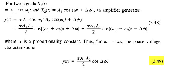

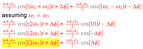

I don't understand how expression 3.49 shown below is reached in this text from my previous post. Could you please have a look at it?
pll_2a-jpg.118040
I tried it but couldn't proceed any further.
pll_2a-jpg.118040
pll_2b-jpg.118041
There is a slight mistake in the conditions for equation 3.48. The A2 term should use omega2 not omega (and I can't find how to Greek characters and subscripts).
In your equation, you get to the sum of a cosine of twice the frequency, the bit highlighted in yellow, which isn't in equation 3.49. That bit in yellow is correct, but for a phase comparator, it is irrelevant. The output of a phase comparator will be filtered to give only the low frequency components, so components at twice the frequency are ignored. What is left is a voltage that only depends on phase. The text before equation 3.49 says "the phase voltage characteristic is", so the high frequency terms are ignored.
It is typical of a frequency mixer / phase comparator to output the sum of the frequencies and the difference between them. In a phase locked loop, only the difference is of interest, and higher frequencies are filtered out.

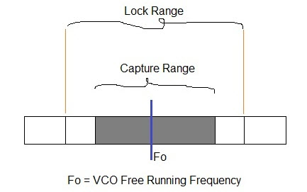

The following text is taken from this attachment. The difference between the two definitions is seemingly so subtle that the definition of Capture Range eludes the understanding.
Lock Range
The lock range of a PLL is the range of input frequencies over which the VCO can remain locked onto and track the input frequency. It is related to the maximum phase difference that can be detected. In our discussion, we are assuming that the phase detector can produce an output voltage for Δφ between -90° and +90°. At these limits, the phase detector produces a maximum output voltage, either negative or positive.
If the input frequency is too low or too high, the phase difference is outside the range of -90° and +90°. Therefore, the phase detector cannot produce the additional voltage needed for the VCO to remain locked on. At these limits, therefore, the PLL loses its lock on the input signal.
The lock range is usually specified as a percentage of the VCO frequency. For instance, if the VCO frequency is 10 kHz and the lock range is +/-20%, the PLL can remain locked on any input frequency between 8 and 12 kHz.
Capture Range
The capture range is different. Assume that the input frequency is outside the lock range. Then, the VCO is free running at 10 kHz. Now, assume that the input frequency changes toward the VCO frequency. At some point, the PLL will be able to lock onto the input frequency. The range of
input frequencies within which the PLL can reestablish the lock is called the capture range.
The capture range is specified as a percentage of the free running frequency. If f_0=10 kHz and the capture range is +/-5%, the PLL can lock on to an input frequency between 9.5 and 10.5 kHz. Typically, the capture range is less than the lock range because the capture range depends on the cutoff frequency of the low-pass filter. The lower the cutoff frequency, the smaller the capture range.
The cutoff frequency of the low-pass filter is kept low to prevent high-frequency components like noise or other unwanted signals from reaching the VCO. The lower the cutoff frequency of the filter, the cleaner the signal driving the VCO. Therefore, a designer has to trade off capture range against low-pass bandwidth to get a clean signal for the VCO.
lock_capture_range_pll-jpg.118060

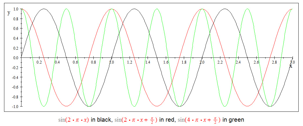

Notes to self:
1:
In the picture you can see that the signals in black and red have the frequency but have 90 degrees phase difference. Their phase difference remains constant. The signal in green has a different frequency and is phase shifted by 90 degrees like the signal in red. You can see that its phase relationship keeps on changing with both other signals. Compare the peaks. It means if the frequency is same, the phase remains constants otherwise it varies. Two signals with different frequencies cannot have constant phase relationship
pll_phase111-jpg.118061

Question 1:
It looks like, at least according to some of the references I have been through, when a PLL is locked the input/reference frequency and output frequency which is coming out of VCO are the same but the phase difference between them would be 90 degrees. In other words, when the phase difference is 90 degrees, it is said that the phase difference is zero.
"The goal is to generate a VCO output whose frequency is the same as the frequency of the received signal and phase is different from the phase of the received signal by 90 degrees."
[Introduction to Digital Communications, Ali Grami, 2016 edition, PDF page #369]
By the way, is there any reason that why the 'inherent' phase difference is 90 degrees and not simply 0 degrees? One reason might be that it's more easier to implement with 90 degrees phase difference rather than going 0 degrees.
If a PLL is being used to lock a VCO to a reference frequency, it is usual for the actual phase difference to be unimportant. It is only the frequency that matters.
A voltage multiplier, or an XOR gate can be used as a phase comparator, and they will often give a maximum output at 180 or at 0. The mid output will be at 90 degrees or -90 degrees and so that will be the design point. It is more difficult to make a phase comparator that gives mid output at 0 degrees difference, and if the frequency is the only output of interest, it's pointless as well.
The phase comparator output will vary around the mid point as the input frequency varies, or temperature or other things affect the VCO. As a result of these variations, the phase will vary a bit as well.
Question 2:
Lock Range
Capture Range
Source: https://www.quora.com/What-is-lock-range-and-capture-range-of-phase-locked-loop-in-simple-terms
Let's assume that the phase detector has a maximum output at 180 and a minimum output at 0.
If the PLL is locked, and the frequency is in the middle, the phase difference will be 90.
Now the reference frequency increases. The phase difference increases, so the phase detector output increases, the VCO frequency increases and lock is maintained. Now the phase difference is larger, say 120 degrees, and the phase detector output is above mid, but below maximum. So far, so good. It's being a PLL.
Now increase the reference frequency more. The phase difference increases, the phase detector output increases. Eventually the phase will approach 180 degrees and the phase detector output will be near the maximum. The PLL is still working, but it's on its limit, and it is at one end of the lock range. That is the maximum lock frequency.
Now turn off the reference frequency. The phase comparator produces a mid voltage and the VCO moves to the mid frequency. Now turn on the reference frequency again, as the maximum lock frequency. The phase comparator will start producing a sine-ish wave, varying between minimum and maximum at around the difference between the mid frequency and the maximum lock frequency.
Although the VCO frequency is changing, it never quite gets to the maximum lock frequency because the phase comparator output is never stable at the maximum voltage for any length of time, and any filtering at all will stop there being a lock.
The reference frequency needs to be reduced a bit, to give the phase comparator and VCO a bit of time, in the cycle of phase comparator output waveform, to get to the right frequency. When that is done, the top of the capture range has been found.
Another way to multiply or divide the frequency is to use a second PLL. The first PLL is still used in the same way to lock the feedback loop. On the second PLL you just use the VCO portion and level shift the voltage from the output of first PLL with an Op-Amp to the input of the second PLL so that the desired frequency is obtained. This avoids the digital step from the divide by N counter and provides a more dynamic response if the input frequency changes which may or may not be desirable.
