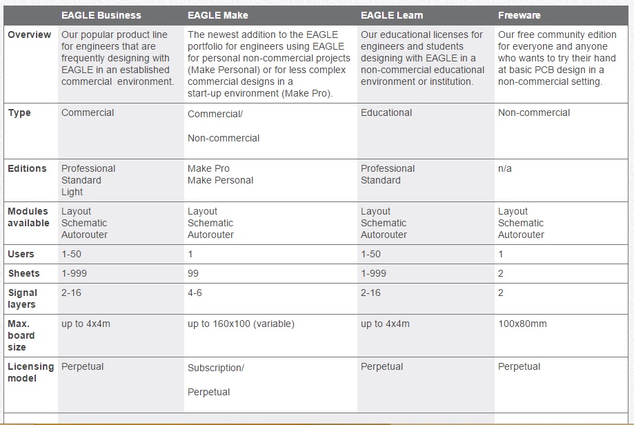

I´d recommend CadSoft EAGLE. Version 7.5 was just released and "In recognition of the ever expanding needs of EAGLE’s large community user-base CadSoft has also added a second schematic sheet to the free edition of EAGLE v7.5". That comes in quite handy. On the website you´ll find a lot of tutorial stuff and a FAQ section... In the image below you´ll find more information about the free trial version. Also check YouTube for video-tutorials. Couldn´t find them on the website.
Source Image:
My license for Multisim Blue is coming to an end, so I think I will be making the switch to Eagle. Most likely Eagle Make Pro, as I do some commercial use work. Not sure what other diff there is between Make Personal and Pro. Actually the price for Pro is just slightly more than Multisim Blue Premium (which is really the NI Multisim Base version) but the Multisim is a annual subscription price.

I should have looked at the website prior to posting my question. One thing I did not see is how to get this added feature as it was not listed under the price list.
