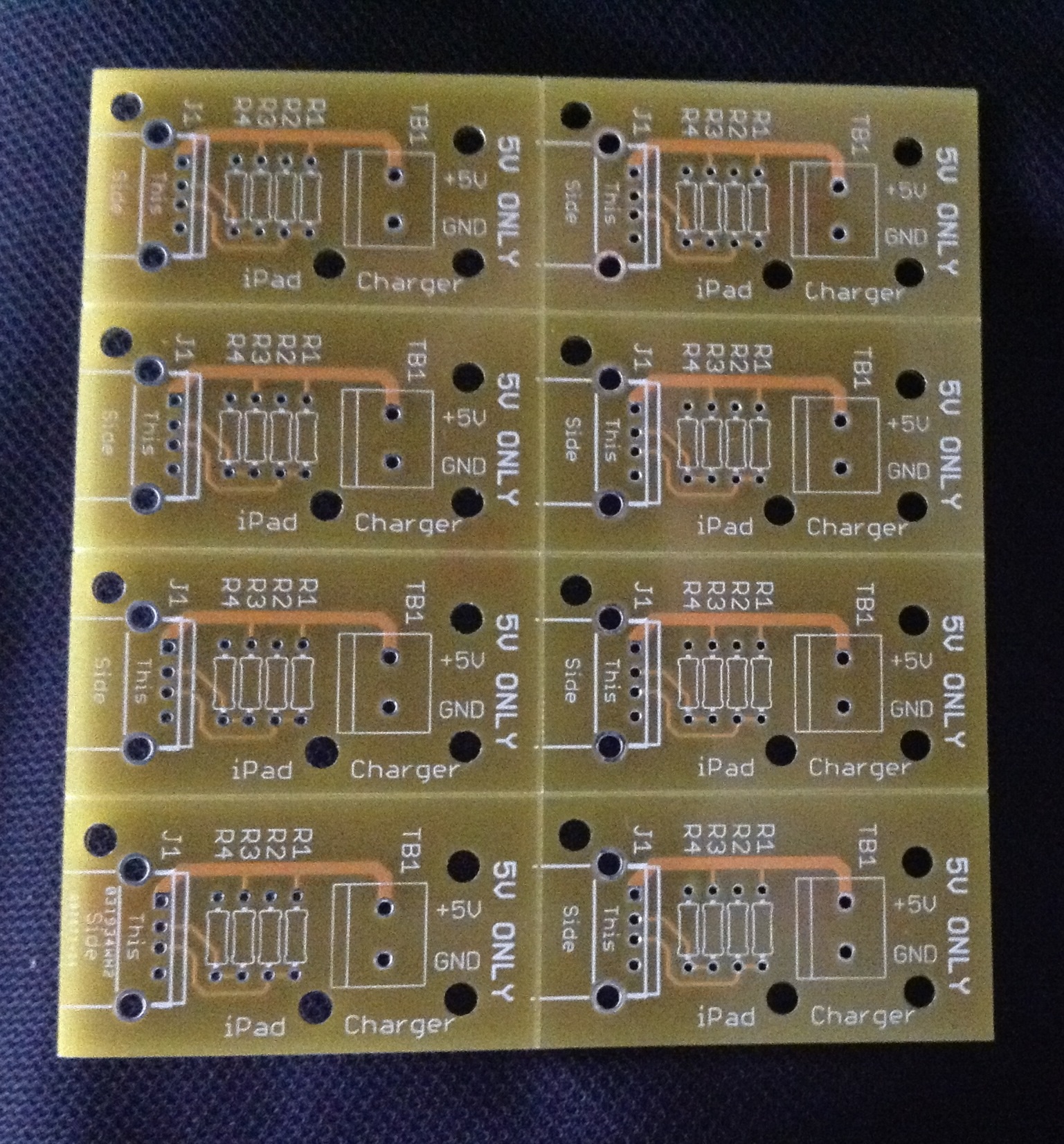

I've made a number of orders with Elecrow now, for about 10 boards and I'm extremely pleased with the results. V-score is available at Elecrow too, which is unique among low-cost providers. One of the attached photos shows a v-scored panel that can be snapped apart into several boards.

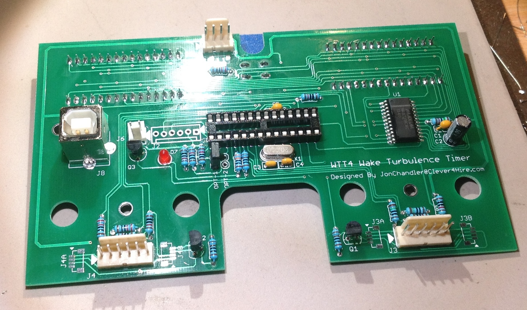

The only problem I've had with Elecrow (I think is was them) having an issue about the board outline, which was shown on one or two layers only, and somehow they missed it (a format that had worked a good many times before with many vendors including them), so now I include it on every layer along with a note just to be sure.
Here's an example of my typical ReadMe.txt file:
AS1106-LED-DISPLAY
Size: 98.1mm x 60mm
2 Layers
Silscreen on top and bottom
Soldermask top and bottom
Board outline is included on all layers.

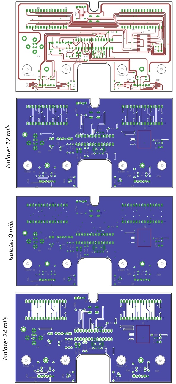

MrDEB, your comments still make it sound like Elecrow screwed up your boards, but reading between the lines, the problem is a poor layout, correct? Not enough clearance between pads and ground plane, which is your fault, not theirs. I hate to see them lose business because of your unclear remarks.
From MrDEB's less-than-clear comments about his board with shorts, it sounds like he has a problem with the clearance between a ground plane and traces/pads. In Eagle, this is called the isolation distance; I believe DipsTrace calls this clearance. This is a parameter, much like line width, that must be set.
The pictures below are from Eagle and show the top and bottom views of the board I posted above. The blue layer is the bottom of the board with a ground plane fill.
The first blue layer illustrates the board as built, with a 12 mil isolate distance.
The second blue layer illustrates an isolate distance of zero. The ground plane touches the pads and traces. This is the Eagle default, so clearly, you must set the desired value.
The last blue layer illustrates an isolate distance of 24 mils. Lots of clearance between the ground plane and traces/pads, but look at the 3 dip footprints – there's not enough space between the pads to connect the ground plane between them. Depending on the board layout, this may result in breaks in the gound plane (voice of experience here).
When selecting the isolate distance, there's a trade off between clearance to the pads and ease of soldering and the ability of the ground plane to flow around components. Fab houses now often claim a 6 mil trace/space capability (the minimum trace width or space between traces) but it's best not to push the limits when there is no need. I usually use a 12 mil or even 16 mil isolate distance to prevent problems; if high voltage or high current traces are present, give them even more clearance.
