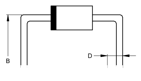

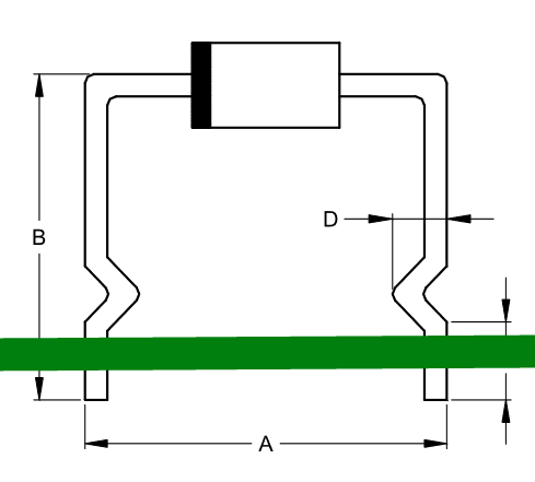

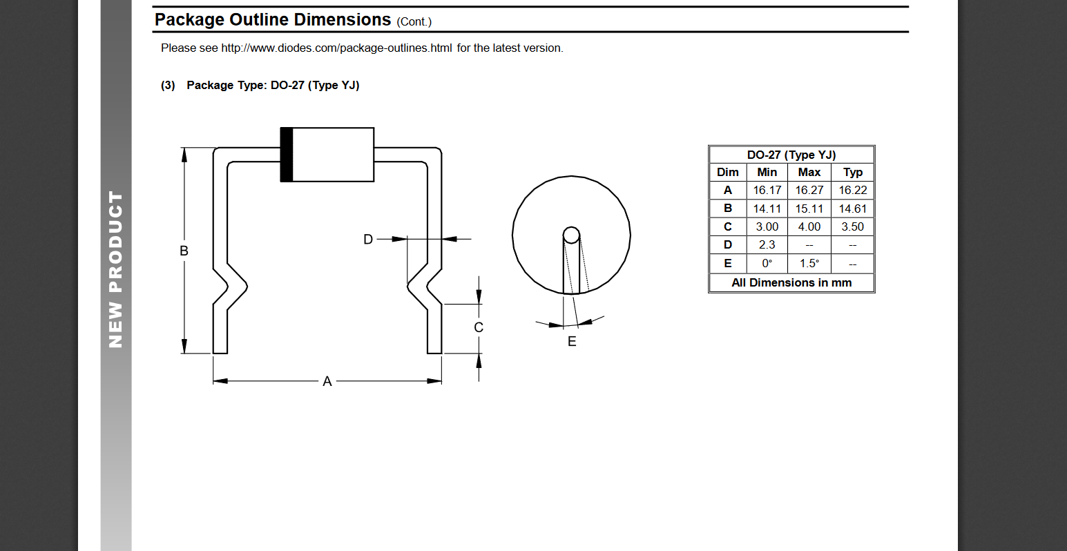

Hey guys:
When you are designing a footprint for a thru-hole component with pre-bent kinked leads, what hole spacing do you use? Do you use the nominal lead spacing or do you use the spacing of the kink?
I never gave this much though before because it never really mattered but this is going to be pick-and-placed.

The kink is above the board. Do not change the board. Spacing is "A"- lead diameter. (About A)
Are you sure about that? Because with the kink above the board, that diode sits 1cm above the board which seems pretty high to be.
Kinks are used to keep hot parts from burning the board. I see then on 2w resistors. Heat transfers to air better when the part is up in the flow.
Hmmm, I'll have to get another part then since that exceeds my board height limit.

It's being used as a flyback diode so I think it should be okay closer to the board. It's doesn't have clearance not because there is a cover, but because there is an identical PCB stacked on top of it, and another one on top of that, etc.
EDIT: Oh crap, that reminded me. I forgot to change the order on the part to be the bent but unkinked legs and change the PCB. They have different spacings. Oh well, I guess that's what trial PCB runs are for.
