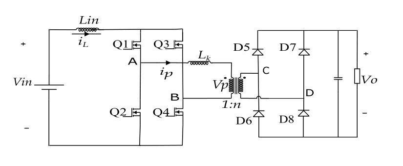

Hello People I want to make a dc/dc converter with specs given as follows:
Vout=500V
Vin=30V to 42 V
Iout=2A.
So, Input
current will go to 40A.
So, I wanted to design a PCB for the same. But I have some basic doubts.
Will PCB support such high current, or is it reasonable to give such high track width. I have chosen a topology same as given below:
Other doubt is how to place heat sink, transformer, fan(for heat sink) and input inductor, optimally so that to avoid stray inductances. Also I have to avoid use of wires as far as possible for the same reason.
Also, please help me choose the heat sink
Companies that make PCBs have online calculators to give trace width and temperature rise.
You can run copper on 2 or 4 layers to get the resistance down.

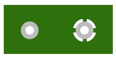

Keep the traces wide and I do not use "thermal isolated pads". You need the maximum amount of copper.
"All the drains" are only one. (they are shorted now)
Thermal pads by definition keep heat from flowing. I want to move heat from the transistor into the PCB.
But won't thermal pads be necessary? as I will be shorting all the drains of mosfets
I think you guys are talking about two different things. I think Ron is talking about thermal relief on the PCB footprints to make components on a large copper fill easier to solder, not thermally conducting but electrically insulating pads that go between component and heatsink.

Maybe I am using the wrong words.
Look at R1, R2. The top, has the trace going into the pad.
The bottom; there is copper missing so heat will not go into the large copper area.
Look at C1. Blue: heat will not flow. Red: heat will flow into copper area.
For your transistors heat needs to flow into copper.
D3 has good pads for heat.
Notice there is copper every where.

Nah, you were using the right terms. Just to thermally-isolated PCB pads sounds a lot like heatsink thermal pads.

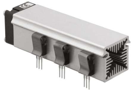

So it turned out that my guide has not agreed to use the Copper Area to dissipate the heat. He says that we are not comfirtable enough with the heat resistance it will offer, and the current may converge at some places giving rise to uneven distribution, So for the first iteration I have to go with Heat sink only. I was thinking of somethink like the figure shown below:
But again as I am a noobie I don't know whether this will be best or not, or what complications I may face. Also, I don't know the trade name of this type of Heat sink. So I was hoping that once agin you people can rescue me.

I like the heat sink. I have used what looks like 1/4 and no fan.
The spring clips are a very good idea. You will need an insulator so the drain voltage is not on the heat sink.
If you use that heat sink think about 2 transistors on this side and 2 on the other side.
Maybe you can get the fir flow to flow on the transformer.
This thermal pas is for one transistor but you can get a long pieces that cover 2 or 4 transistors. (no hole) They have sticky on one side like tape.

I understand. But it's way more effective than I thought it would be. The board I talked about was designed for only 40A but can handle much more because it runs much cooler than my calculations said it would (no real temp rise at 40A) except for the hot spot I mentioned but that's because I didn't notice the hall sensor current shunt was only rated for 20A when I was designing it so the component heats up, not the PCB. Get a plain unetched copper PCB, cut some traces into it with a knife and run current through it and see how it heats up. You might be surprised.
Part of the problem with heatsinks is finding and mounting the heatsink.
You can also get ceramic pads which conduct heat better. The thin plastic pads are just to electrically isolate and don't do anything good for heat conduction.
