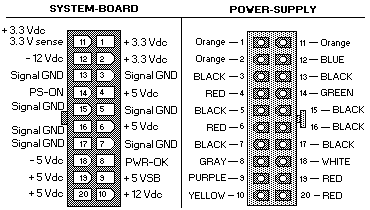

Can anyone describe to me how to make a pc power supply work without having to connecte it to a motherboard? Is it just a matter of crossing some wires to make a connection? Or is this something more complex?
Just make a shortcut between PS-ON and GND, but keep in mind: for proper work need a minimum load on +5V output (about 0.5..1A).

You are using an old AT PSU. AT PSUs are activated via AC switches. Don't fool around with AC if you are not famliar with them.
At old AT power supply doesn't need a switching signal, it comes on as soon as you apply power. As with the ATX one, you should have a permanent load on the 5V rail for it to work properly.
go to radio shack, and grab yourself a 10 ohm 10 watt power resistor. Stick that across the 5v line and you will be all set. I have been using an AT power supply as my benchtop supply for years now that way.
