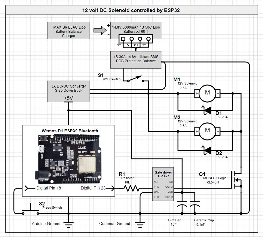

Mike, I'm not getting clicks or unwanted motion from solenoids on power-up. Before reaching the end of my tests I had unexpected solenoid activation or solenoid staying on upon button press but I discovered that it was due to a bad grounding: all components were connected to common ground but gate driver's ground pin was not connected to Uc's ground, which in itself was a dumb mistake since the circuit loop between Uc and gate driver was not close (see in my schematic the connection between common ground and uc ground). That drove me mad for days--seeing the motors behaving erratically without knowing why-- until I added that simple connection. After that the whole system became very stable. But I'll try your suggestion of using GPIO 4/5 instead of 23 and placing resistor between connection to IN A and ground. It'll surely be more suitable in the long run. I also burned my Wemos Uc during one of my latest tests when I did the plug-out phase of my final pcb with parts soldered. I inadvertently let the Uc's pin 23 2V wire end touch a 12V connection on the pcb and it fried the Uc's chip. Current seem to have found a way back to board chipset. Dumb unlucky mistake... A new Wemos is on the way. I might be incorporating the opto between GPIO and IN A after all, just to make sure it doesn't happen again.
As for the battery I'll indeed use extra caution. I heard many bad experiences after mishandling of these cells. This is why I want to triple check all the solutions. I lean towards using the Dewalt since it provides 6 amps which is what I need to drive my 2x2.5A solenoids. But this battery pack is 20V, I didn't find 12V packs that provide 6A. That means that I have to remove 4 batteries to drop it's voltage to 12 while keeping the parallel pairs to maintain 6A. I'm not sure how the pack's bms pcb will react to that since it seems to be designed for 10 batteries, not 6 (see image below). I'm not sure what is the safest route: buying 18650 batteries from known reputable source and a good bms system that we can easily find for those, or continue with the Dewalt pack and venture on a path that is uncertain.

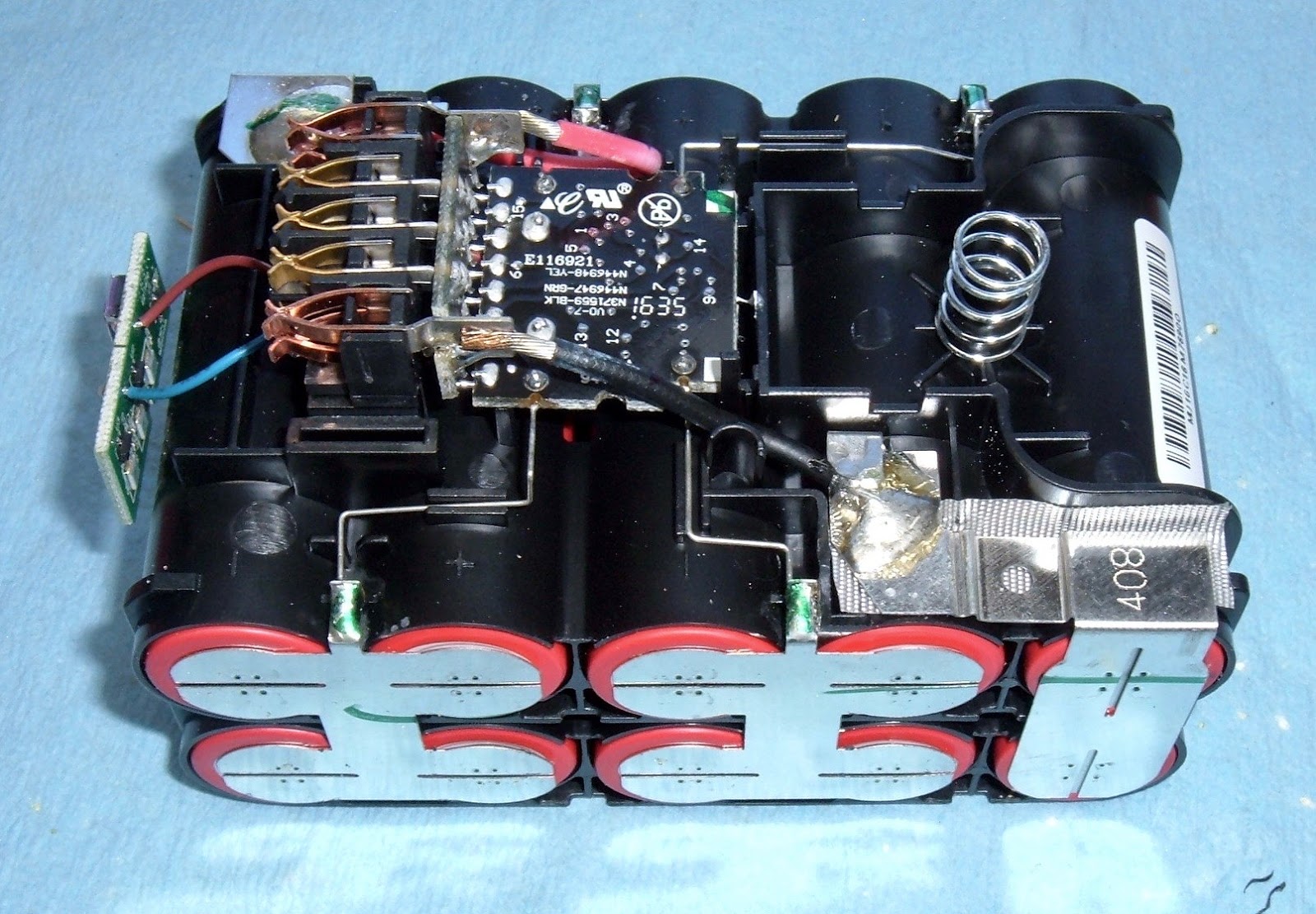

Any reasonable size power tool battery (or 18650 cells) would also be able to provide 5A without problems - if using the drill can flatten the battery in less than one hour, it's running at more than 1C current. Some only give about 15 mins runtime on a heavy load.

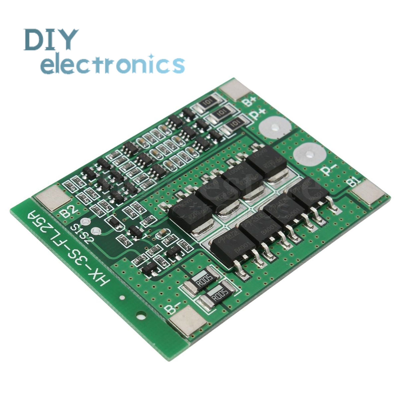

4- 4S 30A 14.8V Li-ion Lithium 18650 Battery BMS PCB Protection Board Cell Balance
(RJ, are you sure that this protection board can also manage Lipo? It is mentioned for 18650 but Amp/Voltage is the same for both battery types. So I guess it is ok).

On the other side, a simple BMS board that disconnects on overvoltage or undervoltage, connected to the load side of the system, would be practical.
Or that combined function board, with that permanently wired to the load electronics and the battery plugged in to that instead of the charger when it's running the equipment.
The only reason for that is to prevent excess discharge in case of a fault or if the system is not charged for a long period.
If the battery is discharged below around 3V per cell, the cells can be damaged or short out - the BMS disconnected the battery from the load if it is discharged too far.

A couple of comments on the circuit.
You still don't need R1.
IN B should be grounded (via a 10k resistor maybe).
To prevent problems at startup, a 10k resistor from IN A to ground would be prudent.
If you're going to keep the 12V connected then a 10k resistor from Gate to ground would be prudent. It's possible (not likely) that stray charge could turn on the MOSFET. I now see you are now switching the 12V line so this is irrelevant.

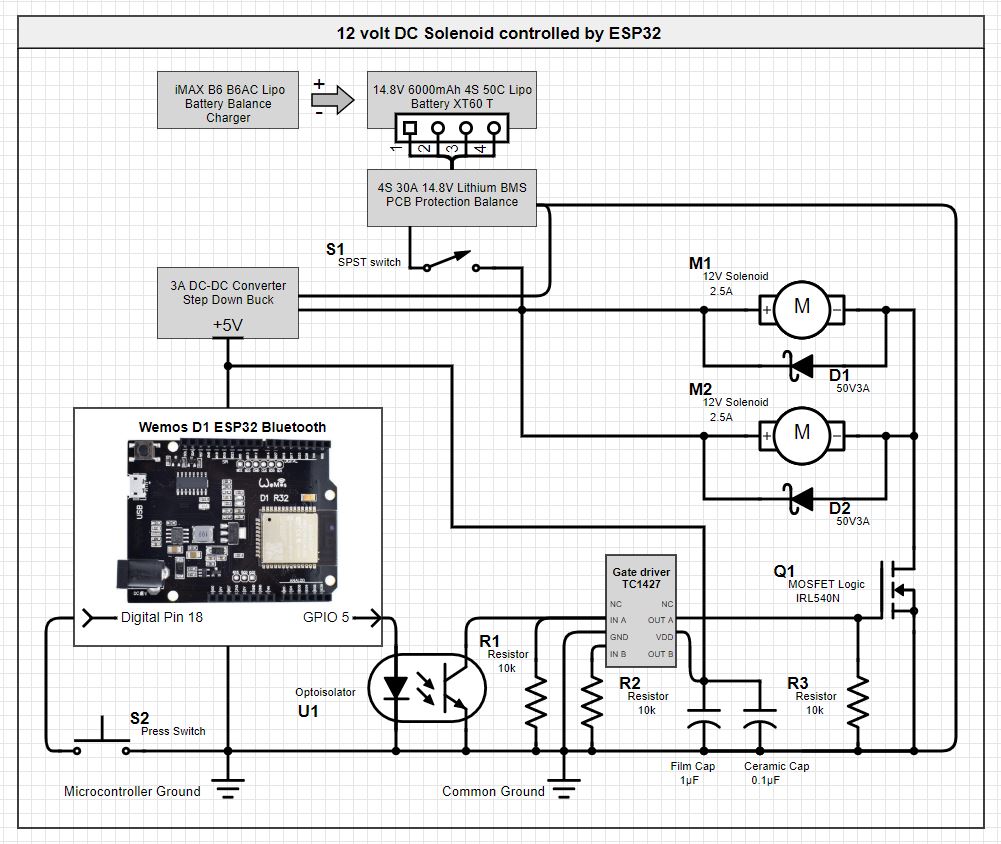

Thanks guys. Here's an updated schematic based on Mike's comments. Please note that I added an opto between Wemos GPIO pin and gate driver to avoid frying a second board! I added a resistor between gate and ground since it will help keeping the gate off when the SPST switch is on and pin18 is not solicited. I'll figure out a way to simplify the disconnecting of the Lipo's balanced cable from protection board when battery is connected to external charger. There could be a special switch for that type of cable that could be turned on and off instead of manually unplugging the cable itself. I want the minimize as much as possible the handling of connections once the project is completed and enclosed into its protective shell. I really appreciate your quick inputs.
Why have you wired the optoisolator like that? It's acting simply as a diode and not doing any isolation.
The way you've connected that opto does not give me any confidence that you understand any of the circuit. Remove it and replace it with a wire. What makes you think something will fry?

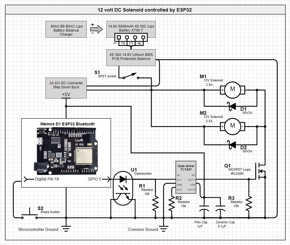

Darn, I uploaded the wrong version. It was a draft with the opto not oriented and flipped in the right axis. This one should make more sense. I'm still learning and making mistakes is my specialty in the moment. I've never done a project of that magnitude before. I still have a lot to learn from you guys, so please be patient ;-) I can't express how much I appreciate the help you've been giving me over the past months. A lot of this stuff was new to me a couple of weeks ago.
For the opto I'm not sure if I need resistor for the anode/cathode. The reason I'm using the opto is to avoid any high voltage going back to the Wemos. I destroyed my previous board 2 weeks ago when the wire's end on pin 23 came into contact by mistake with a solder running 12V near the Mosfet. I had to wait 2 weeks to get a new board. I'd like the Wemos board to be as isolated as possible from the high currents.
The gate driver (tc1427) will stop the wemos from seeing 12V unless you connect it by accident but even an opto won't stop that. The opto really isn't needed. Also, the way it's currently wired wont work - it's connecting IN A to ground when on and when off R1 is connecting IN A to ground. You are also more likely to damage your wemos as the LED has no current limiting resistor.
