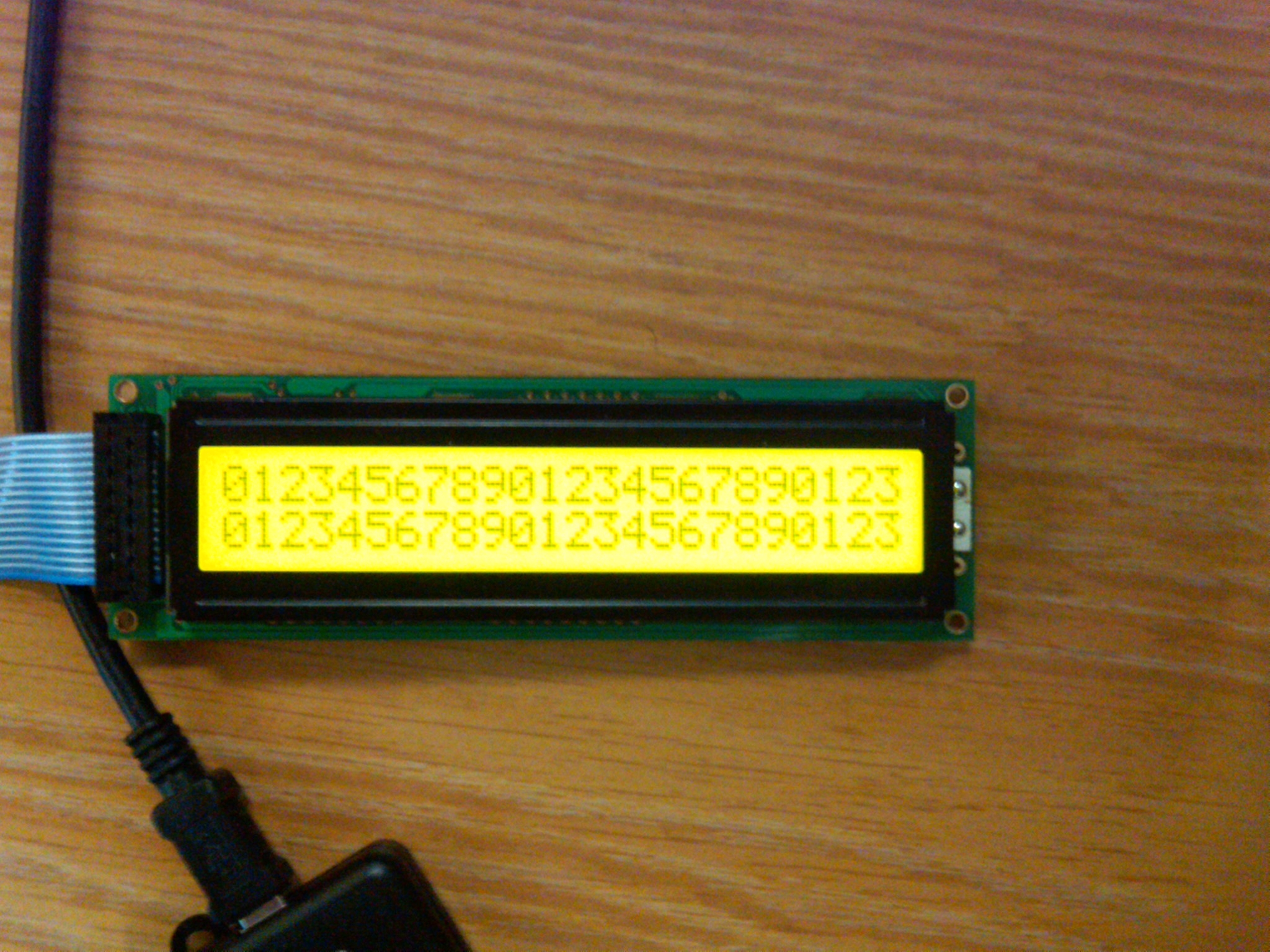

Alright boys. Sorry for the delay. No pun intended. Crazy weekend. Ne who.
I am now able to initialize and put whatever I want on the screen...send it commands...blah blah...now I'm bored :) Time to make the LCD do something useful.
Thanks for all the posts. As always you guys rule.
Here is my code and a pic of it working. Hopefully someone can learn how to fish like I did :)

Looks good nice job. boy No pun intended Just joking glade you got it working
