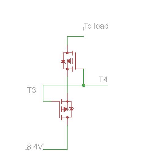

can i connect a p channel mosfet in series with both the source and gate tied?
how does the biasing of the circuit happen ? the circuit is shown in the attachment.
thank you

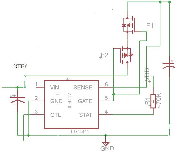

ctually i had to disconnect the load when the battery goes low which is monitored by a comparator which sends a high signal to the CTL pin of 4412, but when this happens the mosfet F2 diode conducted so to overcome that i used F1 in series,
can i use it like this ?? or can i just change the soucre and drain of F2 ??i have attached the schematic.

I m trying to build a circuit to cut the battery supply when the voltage is low.so initially i had only one mosfet F2 but the diode in it conducts even if gate is off , so the load draws current frm battery to over come that i connected the other mosfet...
or can i just reverse the drain and source of the mosfet ??

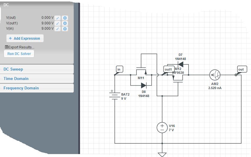

i did try using the online schematic editor and simulation using circuitlab.com ,when the battery supplied 9v and the gate s wer at 7v then only one mosfet on the left turned ON , the simulation result is shown on the left side of the attachment, the OUT node is zero even after the first mosfet is ON .In my design i use a p channel mosfet FDN306P, the symbol used in that editor is for P channel only.

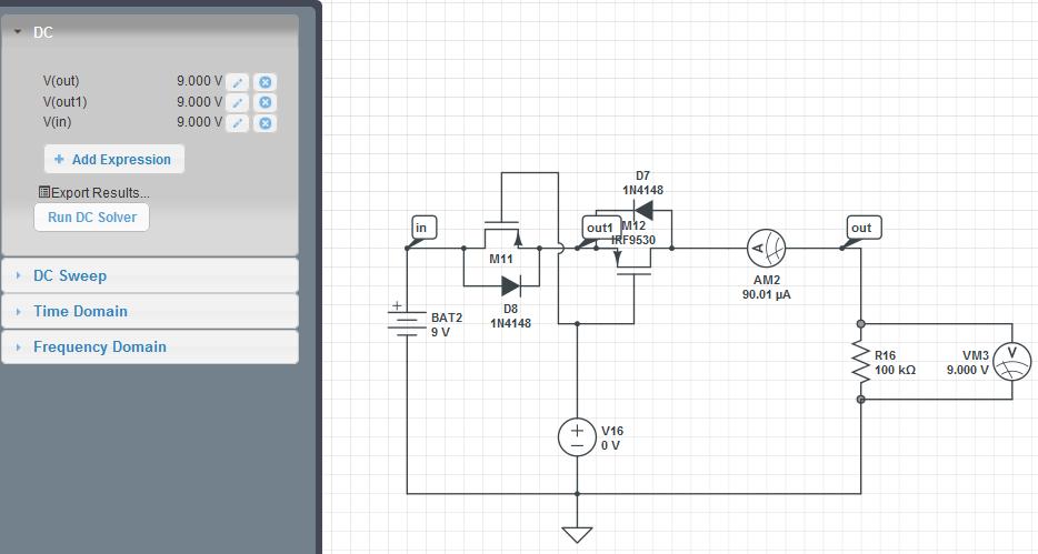

as i lowered the gate voltage it conducted well ... :) here is what i did .

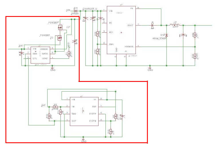

sorry i will post the schematics, and yes i wanted to use that diode to show the intrinsic diode of fet but that editor's symbol does not show the diode so i used ..but i could simulate it..the voltage drop across the diode will be more if i use a diode in place of the lower mosfet .i have attached my schematic.
So, you appear to want a dual supply (Vbatt and Vin). Why not replace everything in the red outline with a diode. Thus the battery would go to diode anode (+), and the cathode ("bar" side) would go to the cathode of the diode from Vin. In other words, the diode from Vin (D11) does the same thing as this proposed new diode from the battery would do.
When Vin > Vbatt, then Vin will supply power to the rest of the circuit. When Vbatt > Vin or Vin is absent, then Vbatt will supply the power.

i have added those circuits to cut the battery supply when it is low, that is in the absence of the main supply vin,to prevent the complete drain out of battery if the mains is not connected .
OK, but you still only need one mosfet to shut down the battery when voltage is to low. The LTC4412 datasheet shows how that should be arranged.
Where are you getting the reference voltage for the comparator? A comparator and logic-level mosfet would be pretty simple.
Have you considered the LTC1998, which is a single package designed for this purpose? I am sure there are other devices that do the same. That part number was just the first to pop up.
