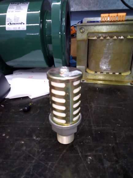

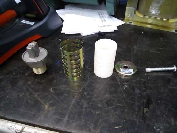

I found this in my stash of machine parts, its a pneumatic silencer for a directional control valve, the white thingy is very porous you can blow through it.
I was thinking it would make a weather resistant housing for a DHT22 or SHT05, might be a little more 'professional'.
