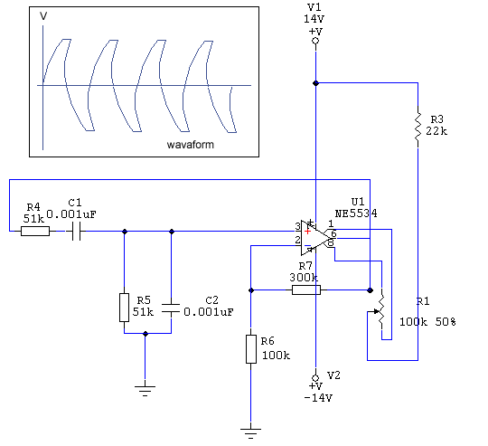

How to fine tune the output of the following oscillator?. Can I connect directly regulator circuit with the following circuit. From the experiment, it seems was a bad idea and the voltage output suddenly drop. Any suggestion are welcome.... :)

Assuming you want to prevent the massive distortion shown on your graph?, you need to add some kind of automatic gain control in the feedback path. This is commonly done using a special (expensive!) thermistor or a cheap incandescent light bulb. It can also be done using a FET circuit, or (crudely) with diode clipping.
If you google for 'wien bridge oscillator' you will find plenty of information and many circuits.

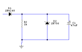

I think there is nothing wrong with my drawing. The output looks like that. BTW, the incandescent light you mean, any torchlight bulb will do? And I'm experimenting it with my own regulator ckt. check below..... :roll:

No, it has to be fairly specific, usually very low current bulbs are used.
I don't really see the relevance of that?, what is it supposed to do?, and where does it connect?. A wien bridge oscillator is a VERY old and common circuit, with many examples you can download off the internet, why not use a 'proper' method?.

Let me clarify the output, the output is like capacitor charging and discharging with +ve and -ve side execpt it kind of distort (maybe the gain to high).

Possibly, but I (yet again) suggest you simply get a circuit off the internet, which will specify whatever gain system it uses. But as you're not wanting any quality (wien bridge oscillators are commonly used for very low distortion sinewaves), a simple diode clipping type circuit would be nmore than good enough.
Yes, because you've left out the most vital part of the circuit, the automatic gain control.

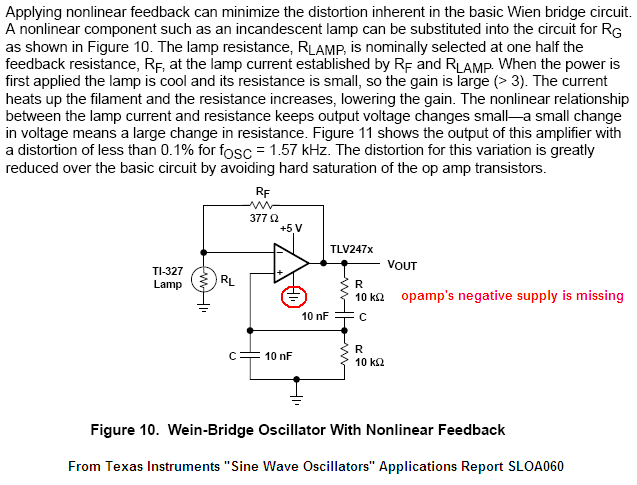

Texas Instruments has a pretty good applications note about many kinds of sine-wave oscillators. Their Wien bridge oscillator with a lightbulb for AGC has a serious error:

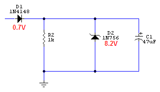

Your "regulator" is a wonderful circuit to short the output of your "oscillator".
When the output attempts to go more positive than 8.9V, both diodes conduct and short the output.
AG, that's a low-distortion, half-wave oscillator. :wink:
Ron H said:
Excellent! :lol:
TI sell ICs. They want you to make two circuits for each oscillator, one for each half of the sine-wave.
audioguru said:
Excellent! :lol:
Ron H said:
:lol: :lol: :lol:
TI was hoping you would ask. They want you to use one of their very expensive DSP chips to glue the two halves of the sinewave together. :lol:
