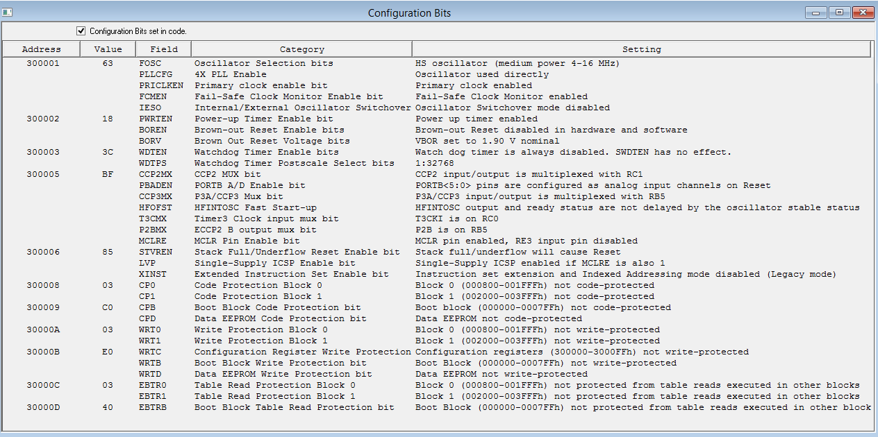

The configuration bits are in the picture. What could be the problem? Why can't the OSTS bit be set to 1?

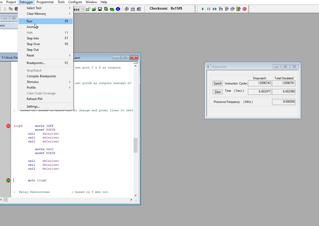

Found we still had a 45k22 chip, so just ran up some code from 10 years ago and used it to test for differences with the SCS bits set at 00 and 10.
In both Simulation and on the actual hardware test rig, it made no difference to the timing of the simple PortB 'flashing' of 6 seconds on/off.
Perhaps someone else can explain these bits and how they actually work ?

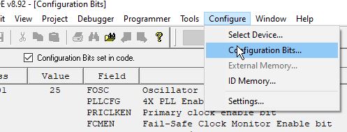

Have attached the code for you to try yourself , just needs the chip type changing, along with a screenshot of the Debugger Simulation using Breakpoints and the Stopwatch. Note that this code needs the Configuatation Check boxed Ticked .

SCS = 00 says to use the osc selected by the CONFIG words, 10 says to use the intosc.
If the CONFIG is set for intosc you probably won't see a difference.
Either way, the simulator timing doesn’t use any of these... it uses whatever you tell it the processor freq is, so you can't use that to see what the osc changes do.
If the SCS bits are set to 00, i.e. Primary clock, the PIC expects an external clock signal. But if you set an internal clock in the configuration bits, that will be the primary clock. For that, of course, the frequency must be selected in the OSCCON register.
Maybe it's just in the way you've phrased it, but when SCS = 00 the pic sets the clock to be whatever you've specified in the CONFIG1 setting... it could be either external or internal based on the FOSC settings of the config word. This is the clock that's used at power up or reset, and your program can't change that (SCS is 00 at power up)
If you've set CONFIG1 to use the intosc then it will startup at 1MHz since the poweron default of the OSCCON register is 0x30.
Once it's up and running your program can change things using the various OSCCON register settings.
