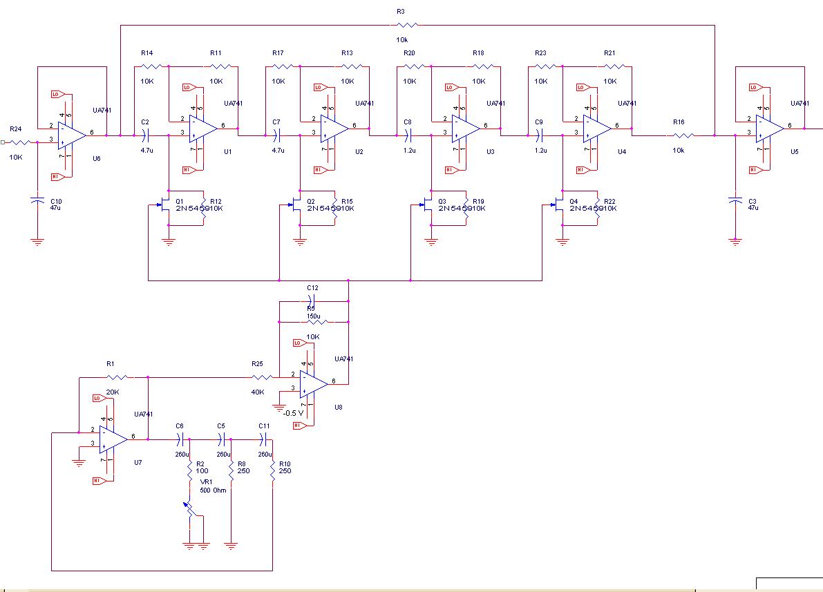

Hi, today I finished a sort of preliminary design for the phaser. I've included a picture of it in this thread. Here are some notes and things that I already know about:
1.) I haven't chosen all the values yet. Most of them are correct, but I'm still working out some loading issues.
2.) The lowpass/summer at the output is something I sort of made up. In simulation it seems to do what I want, but what do you think?
3.) The real product will have some switching circuitry that I didn't show on the schematic. I think it'll just be a simple switch. I'm not going to implement a flip flop switch or anything.
So yeah besides that, what else should I change. I know there's probably alot!
Thanks for everyone's help on the oscillator. I was able to get down to about 1% THD just with the circuit in the schematic. I did try some other things like the 555 to 8th order IC, but I don't think it was worth it in this case.
any suggestions are welcome...
thanks!

Hi Sean,
Your oscillator uses differentiating RC circuits that pass harmonics. Didn't I show a phase-shift oscillator that integrates and reduces harmonics?
I think your oscillator will produce a square-wave and the simple filter won't do much.
The 741 opamp in the oscillator is driving a resistance far lower than its minimum allowed load of about 2k ohms. It will current-limit with square-waves most of the time.
The oscillator will stop when you change the frequency pot. All three resistors are usually changed at the same time.
The FETs need an input voltage from a negative voltage for a high resistance to 0V for a low resistance. Your oscillator will drive them positive which will forward-bias their input diode then they are like a short.
Hmm I did not know anything about the minimum load of 2Kohms. I will have to fix things, then.
I tried that phase shift oscillator schematic you showed me a while ago, and I couldn't get it to work. It'd be nice if I could, though.
I've simulated the oscillator I have now in SPICE, using the uA741 subckt model I copied from my textbook. The results are pretty good (post filter), ill post some images tomorrrow. But, could the model be missing something that would mislead me?
Right now the output of the oscillator filter swings between -0.5 V and -2 V, which shouldn't short the FET, but is a pretty big sweep in regards to distortion; i think you told me this earlier.
do they make triple pot kind of things? i've never seen them.
I made a phase-shift oscillator with a triple pot I removed from something. I buffered each RC stage with an opamp so the loss wasn't high. It worked well until the triple pot got dirty and now the frequency jumps all over the place when I turn the pot.

Hi Sean,
Spice models certainly CAN mislead. And if you don't know to watch out, then it's probably typical that they mislead. I usually try to read datasheets carefully, do "sanity check" simulations, and breadboard early. I've seen opamp spice models that would happily pump out many amps of current, into a low-impedance load. Most real opamp outputs can only deal with 20 mA to 40 mA demands, at best. And most opamps don't do very well into even a 600-Ohm load. [I'll try simulating your oscillator in LTspice, to see what happens, tomorrow.]
Regarding your need for a triple-ganged pot: This might be one place where something like the H11F1M, or some Vactrols, might be expedient. You could use a single pot to set the LED current for several Vactrols or H11F1Ms (with their LEDS all in series), setting the resistances of their other terminals. (I don't know how well the Vactrols might track each other; probably good-enough, though.)
Alternatively, very low-tech: maybe you could mount three pots next to each other, and use string or twine to gang their shafts together, with multiple turns around each shaft before going to the next one.
Another alternative might be to motorize the pots. For "manual" control, you could do it with three small stepper motors and basically just a pulse generator (i.e. no computer needed, at least).
And you could also fairly-easily make one of several possible types of mechanical couplings, that would allow you to use just one DC or stepper motor to control all three pots. e.g. one threaded rod from motor, w/one worm gear on each pot shaft.
OR, to make it easy, if you use three identical pots, with values such that you only need about 1/3-turn of travel, then you could just attach an "arm" to each pot shaft and connect a mechanical link across all three arms' ends. Make all shafts co-axial and it could even be decent-looking and fairly nice to use.

THanks for your reply. I agree that I should breadboard early, I just don't have the equipment really. (scopes and whatnot).
I think I could sit here and keep tweaking and designing forever in simulation, forever, but I feel like I can't make too much more progress without sitting down and testing, so I think I'm going to go ahead and breadboard from here and see what I've got.
thanks
sean
EDIT: just one thing I'm REALLY unsure of...what do you think of the summer stage at the far right of the schematic? is this legit? Like I said, I sort of 'made this up', so I'm not sure if it'll work how I want. It's actually a first order butterworth with unity gain sort of combined into a summer. It feels like I could get into some kind of trouble with this
