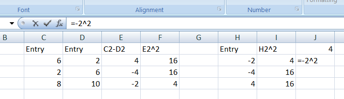

Graph says 4. EXCEL on the other hand says -4!! So does Matlab, so as AUS Dave would say 'A trap for young players!'.
Interesting stuff!
Can you show your work for that?
Here is my test on Excel 2007:
The J column simply has a -2 entered as shown in the fx line.
That version of Excel follows the old rules, -2^2 = 4, regardless of whether the negative number is calculated (presuming Excel might add parentheses) or entered directly.

That is what I was saying though, Excel does not follow the standard conventions for negative numbers. Microsoft has acknowledged that fact.

Regarding references to Excel, over the years that Excel has existed, it is possible that the order of operations or the interpretation of that order has changed. Please give the version or approximate version being used. As mentioned above, I use the 2007 Office version.
In post #11, this is said: "Graph says 4. EXCEL on the other hand says -4!! " I am confident the 2007 Office version does not do that. It would me important to me if someone can confirm that later versions come up the negative square. It woud cerainly be a good reason not to update.
