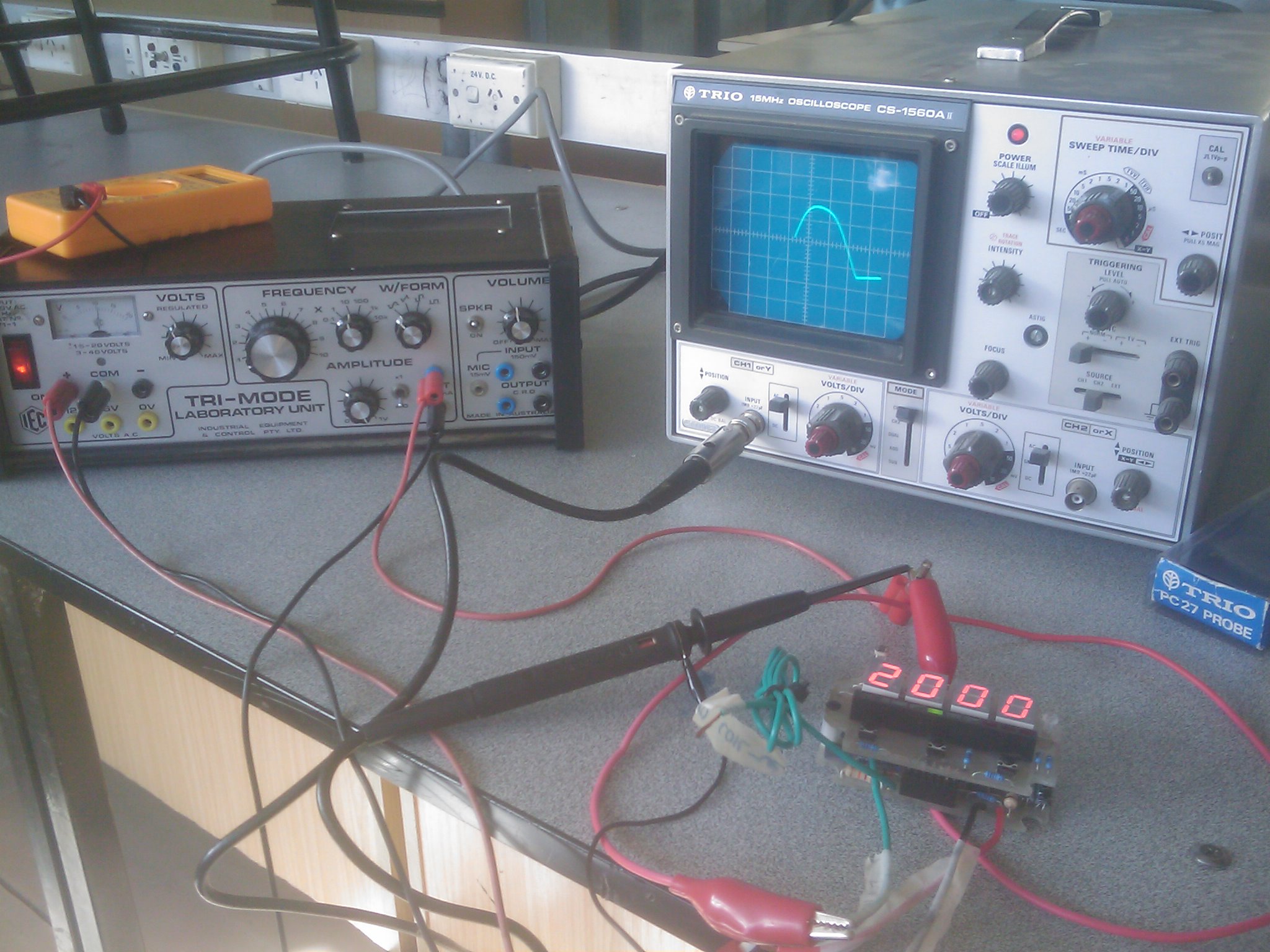

So I have finished rigorous testing and have come to a conclusion that I
believe may be feasible.
When the tachometer is connected to the sig.gen of the power supply
the tacho shows an RPM reading. But when it is connected to my Sig.Gen
output signal, the reading shows for a quick time and then disappears.
So my prediction is that the output signal of the signal generator is not
smooth enough and gets distorted so it does not show a reading.
What do people think?
If so, how do you suggest that I mend it?

In the second part of your post, are you saying that you are driving the tacho display with a different signal generator and then it fails after a short time.
If Yes, are you connecting the SG to the tacho via a series capacitor.??

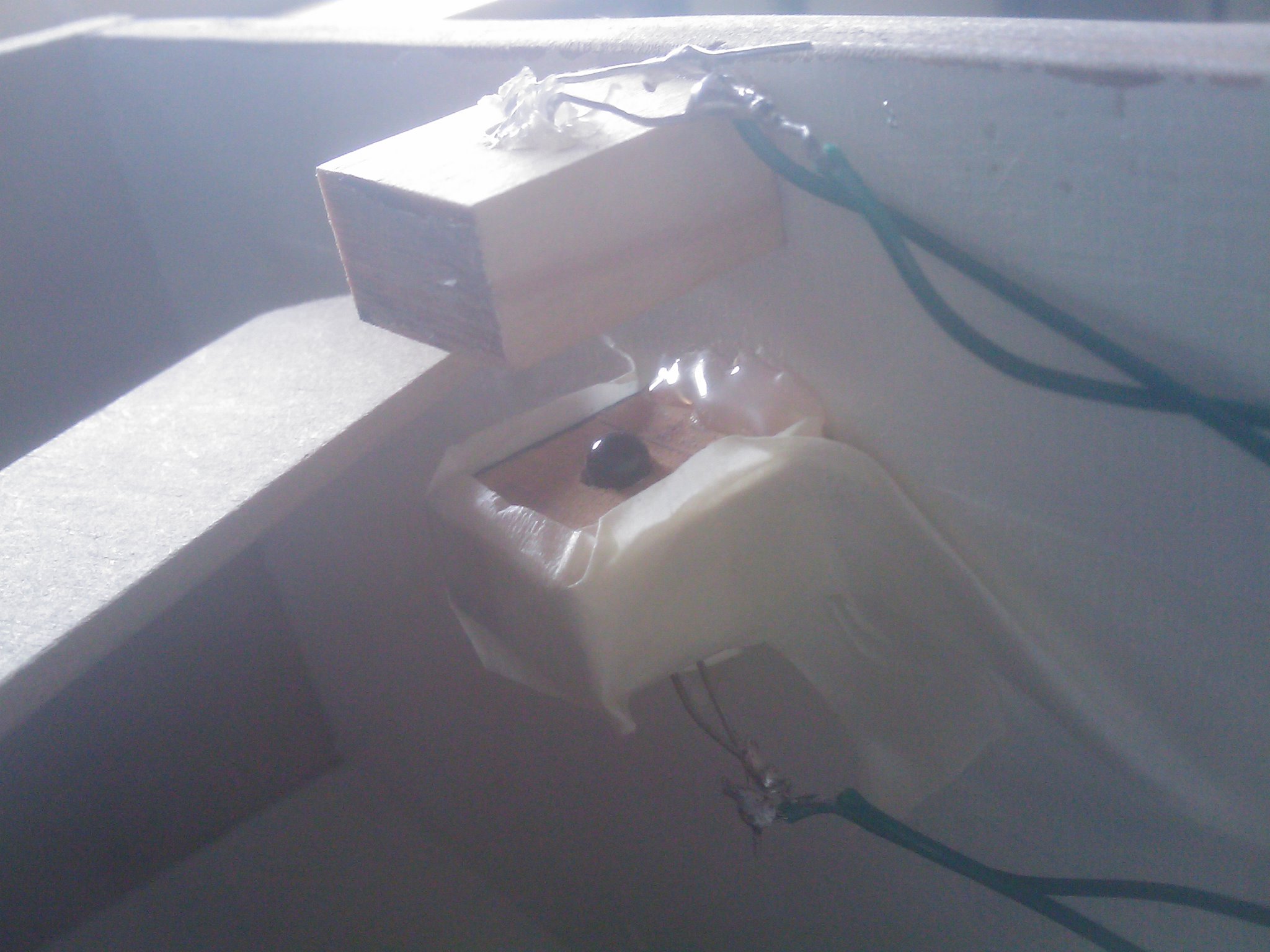

That is correct. I have made a signal generator out of a 12VDC motor
that has a fan blade connected to it. The blade obstructs the IR Beam
of the IR Opto-Interrupter I have constructed.
I do also have a capacitor in series to attempt to help smooth the wave.
Maybe increase the value of the capacitor?
So its not really a SG, but an interrupted IR beam circuit.:)
On your scope when using the IR detector, what signal to the tacho display, do you measure.?
I need to know the amplitude of the signal and is there any 'dc' offset.
If there is a 'dc' offset this may be cause of the failure after a few seconds.
The idea of using a coupling capacitor would be to remove this 'dc' level.
Post a picture of the scope display, but tell me the scope settings, mV/cm, ac or dc etc... OK.:)
Do you have a diagram of you final IR detector circuit that you could post.?

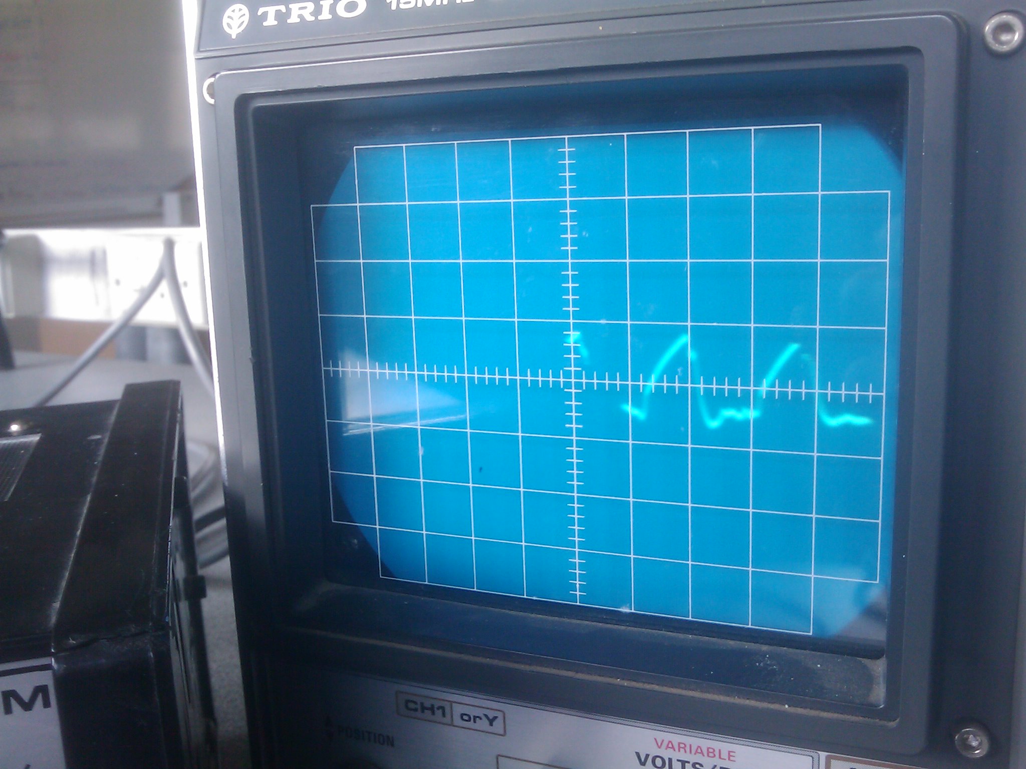

Sorry dear sir for the misconception.
The photo attached of just the oscilloscope screen is the output signal.
I will try get some schematics up shortly.
Nothing to be sorry for, I just wanted to be sure I didnt mislead you.:)
I have seen your scope image, but I cannot see the scope settings, so the waveform dosnt mean anything.
I think that unless the OP changed the scope between photographs if looks as if the scope is configured for 2V/div on AC.
hi FW1,
If the scope is set for 'ac' input, as gaspode suspects, change the setting to 'dc' input, lets see the full signal.
Do you have any info on the tacho display input,?,,, what input pulse levels are specified.?

By increasing the speed of the motor, I am not getting the desired result.
Can only seem to get the amplitude of the output wave to change
and I'm having trouble getting the frequency to change..
Am buying a photo interrupter tonight and will try again.
