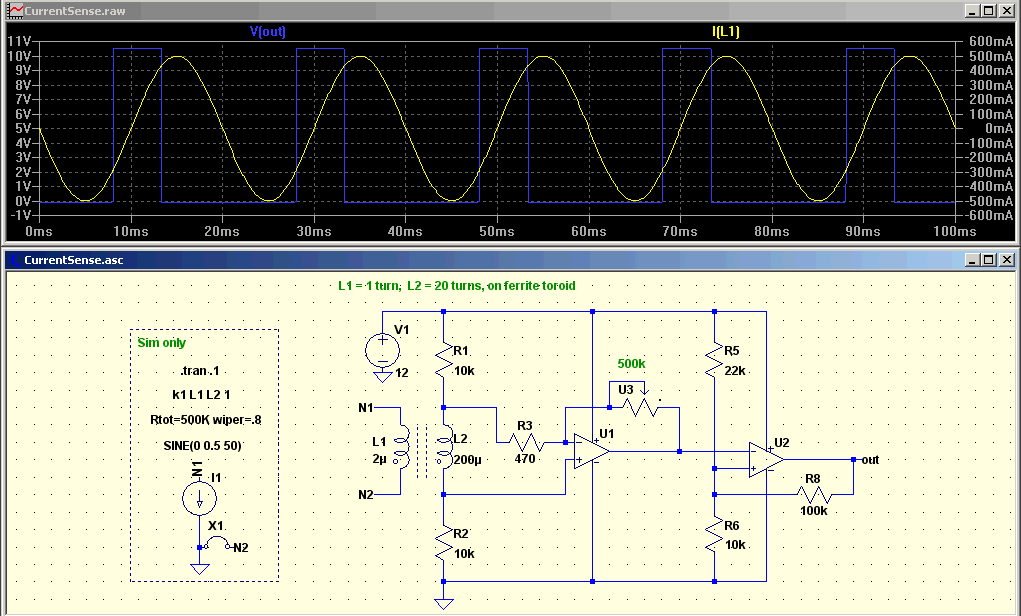

...... or, you could avoid the hassle and power wastage of a sense resistor by using a small current-transformer, instead of the opto, to give mains isolation. Something like as shown below.
L1 is one of the mains wires (line or neutral) carrying the load current. The second opamp has hysteresis and is used as a comparator. The first opamp has adjustable gain to set the trip point.
Edit: The indicated inductance values for the CT are speculative, for the sim. Some experimenting with the number of turns would probably be needed, depending on the core available.

Alec, I think there should be a burden resistor tied directly across the secondary of the CT. If there is ever a sharp rise-time pulse in the primary with the opamp not powered, there is no virtual ground to terminate the secondary. The step-up action of the CT could easily create a voltage high enough to blow the opamp inputs.
The opamp would be seeing the voltage developed across the burden resistor as its input.
Good point, Mike. What value would you suggest? My gut feeling says ~100 Ohm would do.
