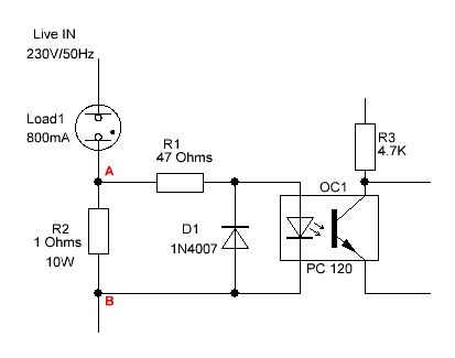

I'm sensing AC current in a Live wire of a load.The load takes 800mA.
What I want is I need to trigger the optocoupler when the load reaches 800mA.
According to V=IR the voltage across A & B is 0.8V which too low to operate opto.
Any simple modifications?
To start, you'd have to raise the value of the 1 ohm sense resistor so that more voltage can reach the LED of the opto coupler. How accurate this is going to be is questionable however.
Alternately you could try to bias the LED from the mains line with a larger value resistor so that it does not take much voltage across the 1 ohm resistor to turn the LED on and activate the opto. This wont be too accurate either because the line voltage could vary as well as the LED voltage for turn on. We could probably estimate the accuracy if you want to think about doing this.
There's also no hysteresis in those two circuits so the opto would turn on and off with the input line voltage. Better rectification would help here.
So if you dont need too much accuracy either of those above might work ok, but if you need more accuracy you have to go to a comparator type circuit with voltage reference. This kind of circuit can be pretty accurate and can be powered from the mains without losing isolation.
Do you have any source of low voltage power where your current sense resistor is? If you had 5 to 12 volts this would really help.

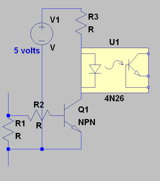

This will turn on at 0.6 volts.
Has some problems but will get you started.

You could increase the resistance of the series resistor and then protect the led within the opto with a diode string.
R2
If the led has a vf of 2.1v then if you had 4 diodes in series across it the max voltage would be 2.4, and if you put these before R1 you'll have reasonable protection for the led.
Optos LED work from 1V to 1.2V.
You are mentioning ronsimpsons circuit?I still didn't get what you mean.

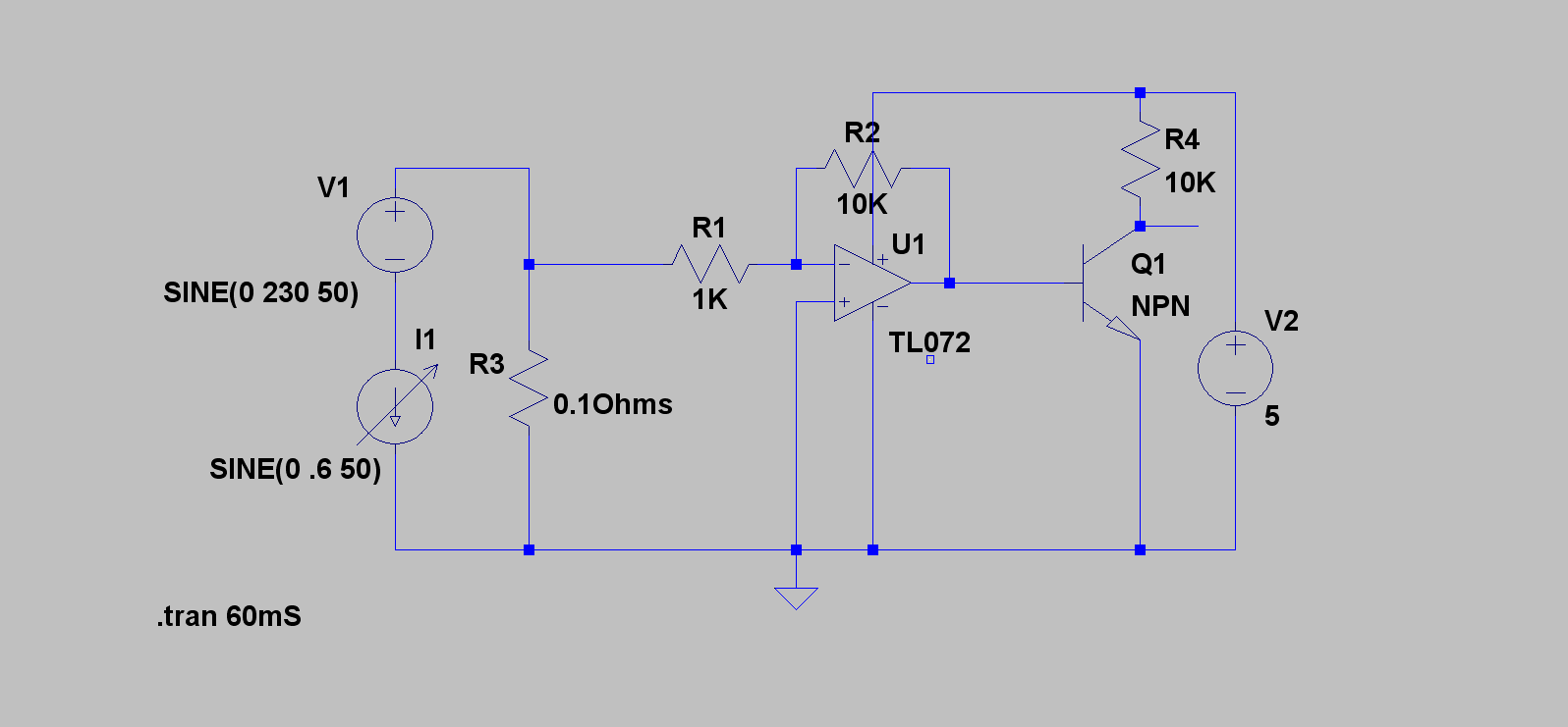

Guys I finally planned to use an opamp & share the same power supply no isolation required.This uses a new low value resistor.Note that I need to power this from single supply not from dual supply.
Here is the circuit. Modifications are welcome.
In LT spice the transistor will bias when the B E voltage reaches 7.8V..!! not when 0.6V
Simulation of that circuit shows that the transistor doesn't switch at all :confused:

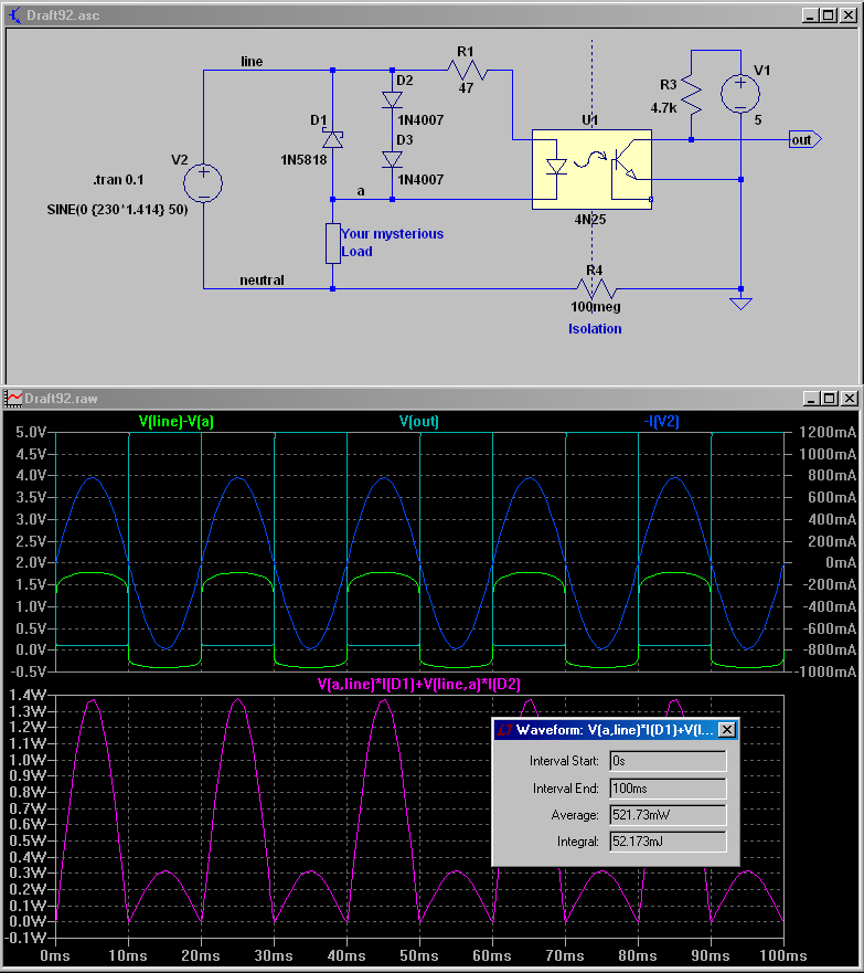

Suraj,
There is something fundamentally wrong with your original statement of your problem. If you are trying to sense the presence or absence of 800mA 50Hz AC in a 230V line-powered circuit, then why do you care what the voltage drop across the sensing resistor is???? Presumably, the source of the input voltage is the 230V line, so you must have a series circuit consisting of the line source, your mysterious "load" (which seems to have something to do with a gas-discharge device), and finally a "current sensing" resistor.
You are quibbling about a voltage drop of ~1 to 3V out of 230Vrms (325V peak)? Even if the voltage drop across the sensing element was 3V peak, that is still less than 1% of the applied voltage.
Please post a complete schematic/description of the input circuit you are trying to sense.
Here is my suggestion:
I am able to detect <800mA p-p (blue trace) through your mysterious load with only 522mW of loss (purple trace) and 1.8V drop (green trace) in the sensing network. The final output is V(out) light-blue trace.
Note how I modeled the isolation between the line side and the output side...
Works for -50C to +50C, too.

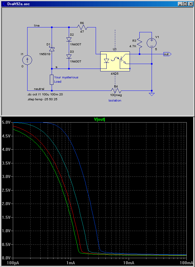

Another question that occurred to me after I posted above:
Are you trying to produce a logic output that is True if your load current is greater than 800mA and a False if your load current is 799mA? 700mA? 500mA? 1mA?
In other words, how narrow a decision band do you need?
Here is a DC sweep of my posted circuit showing V(out) as a function of sensed current at -25degC (green), 0degC (red), 25degC(lt, blue) and 50degC(blue). I fear that my circuit is too sensitive?
