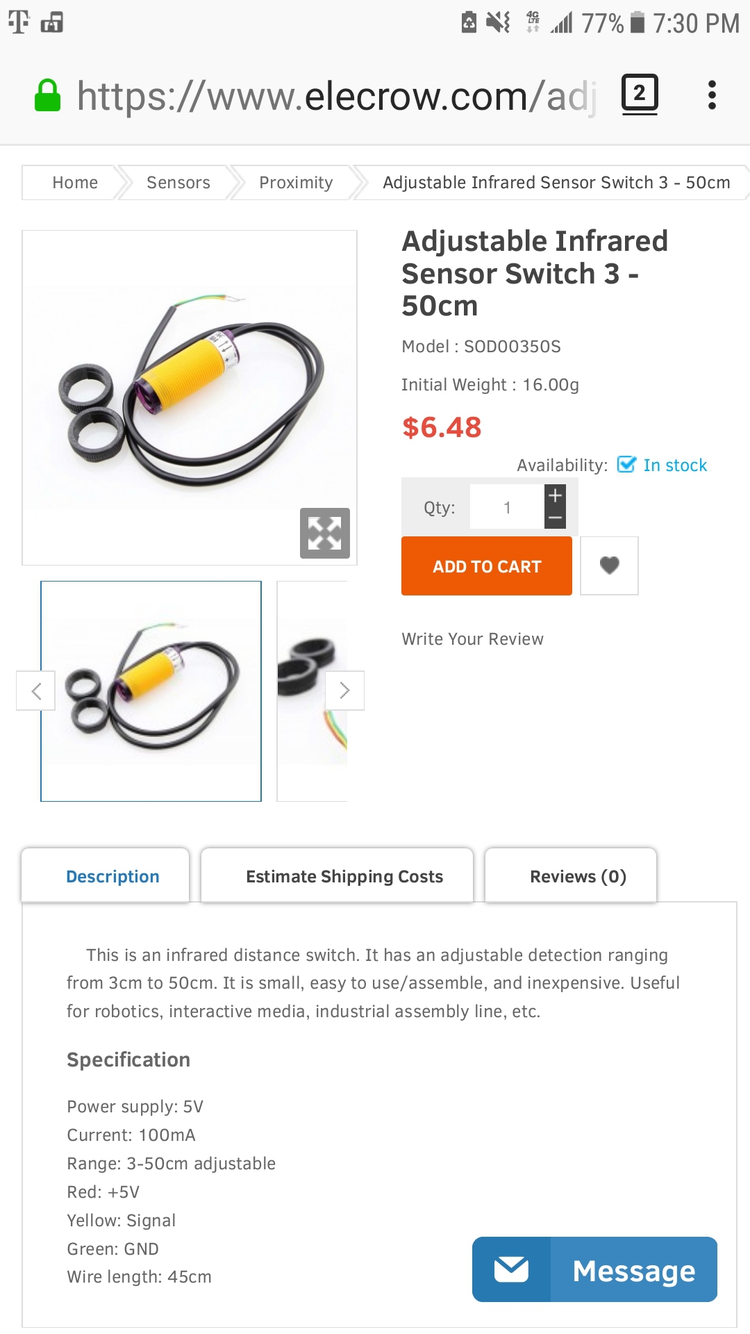

Answering your question, an optical tach sensor and a piece of reflective tape is everything you need. See the picture below. This sensor will provide a TTL pulse string corresponding to rotor position.

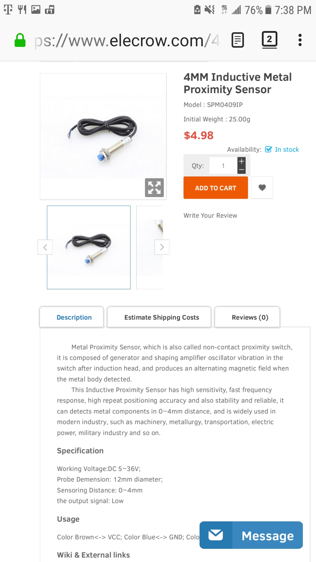

For "real world" size machinery, you can also use an inductive sensor if the shaft has a keyway. Again, this sensor provides a once/rev TTL pulse stream. Picture below.
However, there is a basic flaw in your reasoning. If you are trying to counter mass imbalance, an out of phase force equal to the imbalance could counter it.* But you will not be able to generate this force with an eccentric mass on a motor. The effect of the eccentric mass varies with speed. But you have a fixed speed to counter the force of imbalance. You have no means to vary the force produced by your motor.
