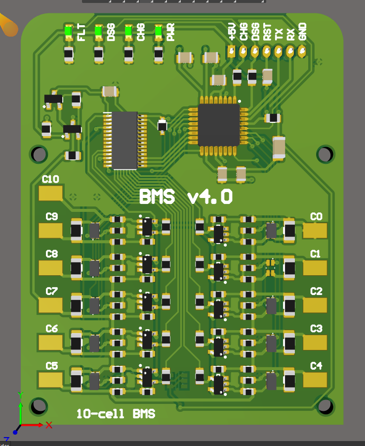

Operational Amplifier for BMS
I have tried measuring 4 cells (0-4.2V-8.4V-12.6V-16.8V) with LM321 plugged to cca 12V and all outputs were exactly correct.
Is that applicable to 10 cell BMS if i put LM321 to 7.cell (29.4Vmax), and i want to know the reason why is that good?
You see the problem, LM321's max voltage is 32V and my 10 cell system would have 42V max (and i need to know each cells voltage)
Thanks in advance

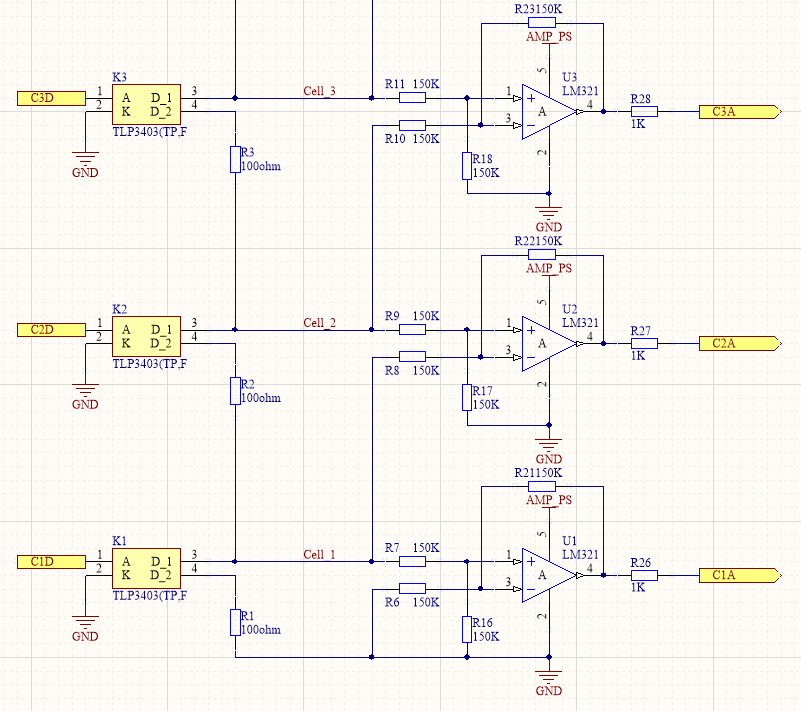

Maybe i didn't explained my "problem" very well: problem is that I have wired that on a breadboard and I can measure voltage from let's say 11-14V even though i connected VCC (LM321) to lower than that 14V, it was 9V.
I want to know is it normal that i could sense higher voltages when VCC is at cca 29.4Vmax?

When you turn on optorelay, you short cell with resistor and you discharge that cell that way.

Now you have posted the circuit, it shows you are using a differential amplifier configuration.
Wired like that, the voltage at the opamp inputs is half the cell voltage.
As long as he opamp supply is somewhat above half the maximum cell voltage, it will be fine.

As rjenkinsgb says, as long as the voltage at the input pins of the IC is less than the voltage at the supply pins, you should be OK. Look at the non inverting input. The resistors from the battery to the input form a 'divide by 2' resistive divider, so VIN/2 appears as the non inverting input. Therefore if your power supply is greater than 15V, you should (theoretically) be OK. Now, the LM321 is an atrocious op amp so its input can only detect signals up to 1.5V below the supply voltage. Higher than that and the op amp will not see the input signal. Therefore for a 15V supply, the op amp will not see voltages greater than 13.5V, so your supply voltage needs to be greater than (29.4/2) + 1.5 = 16.2V
