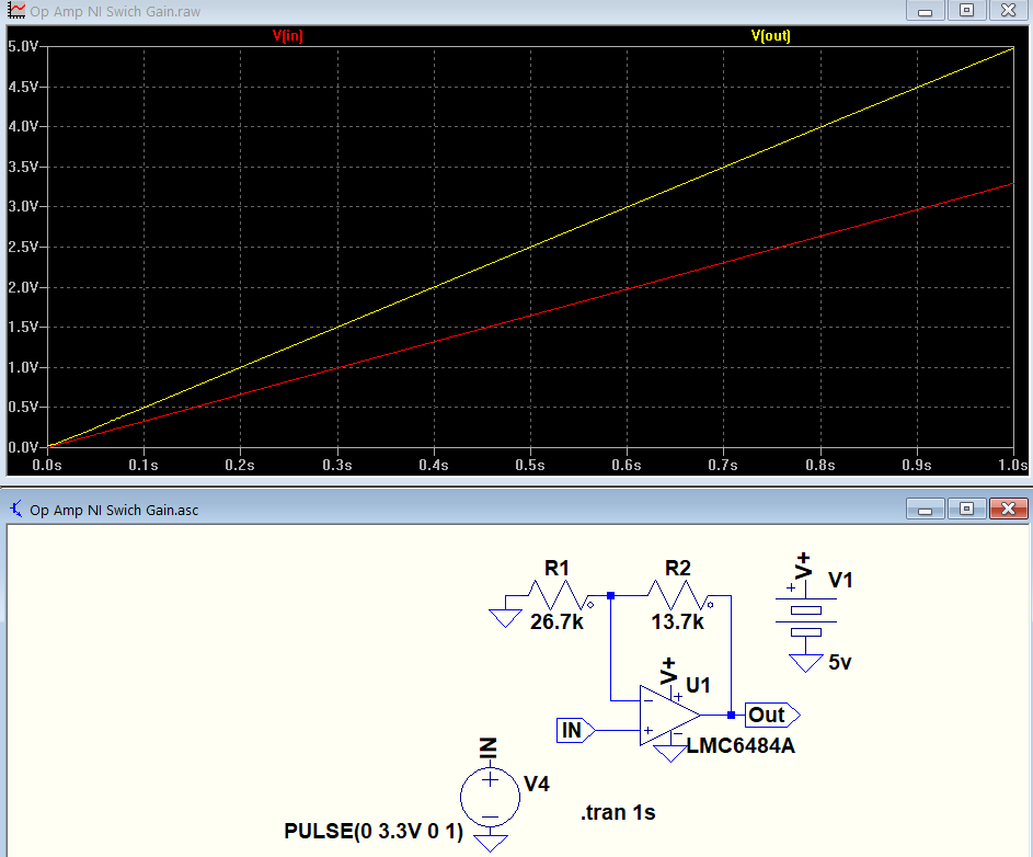

For converting 0-3.3V analog to 0-5V analog you could use a rail-rail type op amp with a non-inverting gain of 1.515 (LTspice simulation of example circuit below):
Firstly, thanks, that's a really awesome diagram!

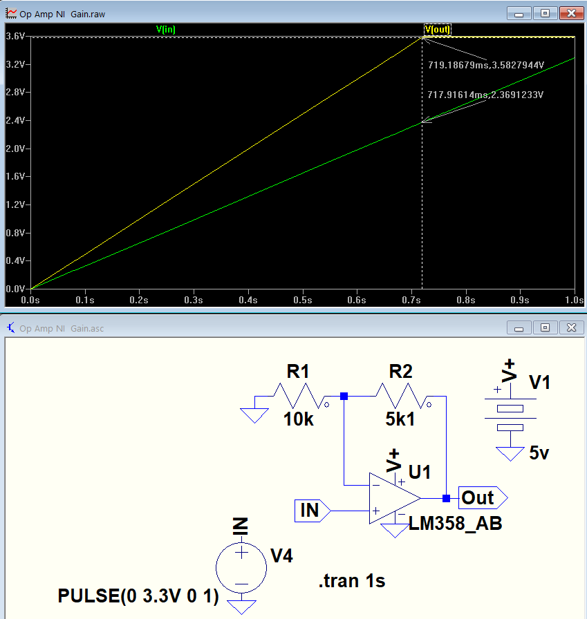

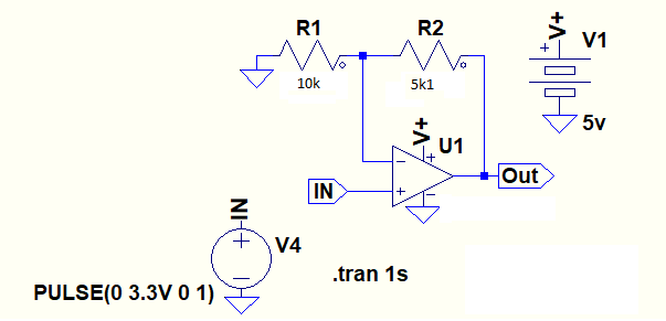

So I took your diagram and used 10k and 5.1K resistors (what I had handy), and did some more experimenting. The opamp I have is an LM358, and like this it seems to give me 2:1 output to input, and then it's saturated (stops rising) at about 3.5Vout. If I take out the feedback resistor then I get a slightly higher output of 3.9, but the positive voltage is 4.87. Why am I losing so much, and why am I getting a 2:1 gain instead of ~1.5:1 gain?

Are you saying that the one in the original diagram, the LMC6484A is fundamentally different from my LM358 in how it operates? I just read through that article you linked to and given the equation, I should have about a 1.51:1 gain, Vout:Vin with how I have it wired. Yet I was seeing about 2:1. And regardless of that, the output is saturated at 3.51V when the secondary voltage (not sure what that's called) is 4.87V. So I'm still losing over a volt for some reason.
The old LM358 (it is not rail-to-rail) output cannot go higher than about 1.3V less than its power supply voltage (yours is 4.87V) so its max output is 4.87 - 1.3= 3.57V. If it has a load then its maximum output voltage is less. It is shown in its datasheet.
Your circuit's gain is 1 + (5.1k/10k)= 1.51 times. With a 5V supply, its maximum allowed input voltage is 3.5V.

Not fundamentally, but in its maximum output voltage, as AG noted.
Below is the LTspice simulation with your resistor values and op amp:
The gain is about 3.58/2.37 = 1.51.
The reason is shown in the data sheets for the op amps.
