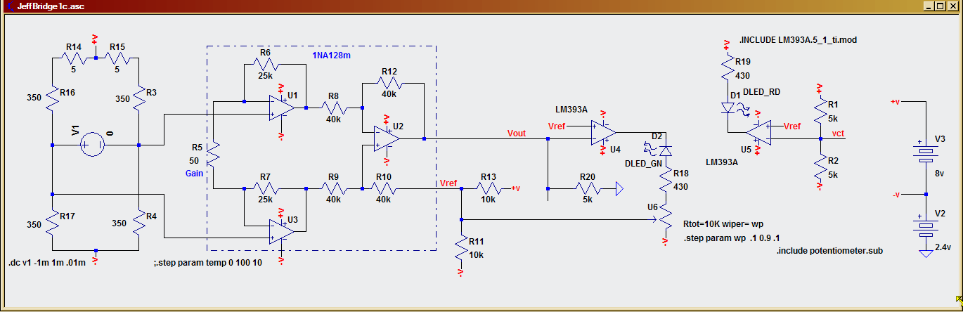

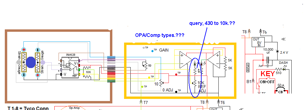

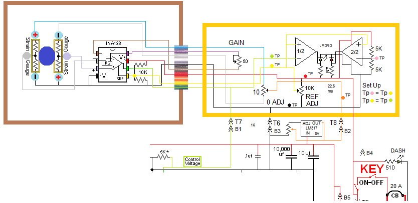

Check this clip from your box circuit, is the 430R connected in series with that 10Kpot.?? because you are showing an LED in the same path.?
What are the OPA comps types.?

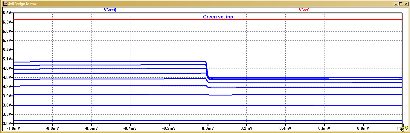

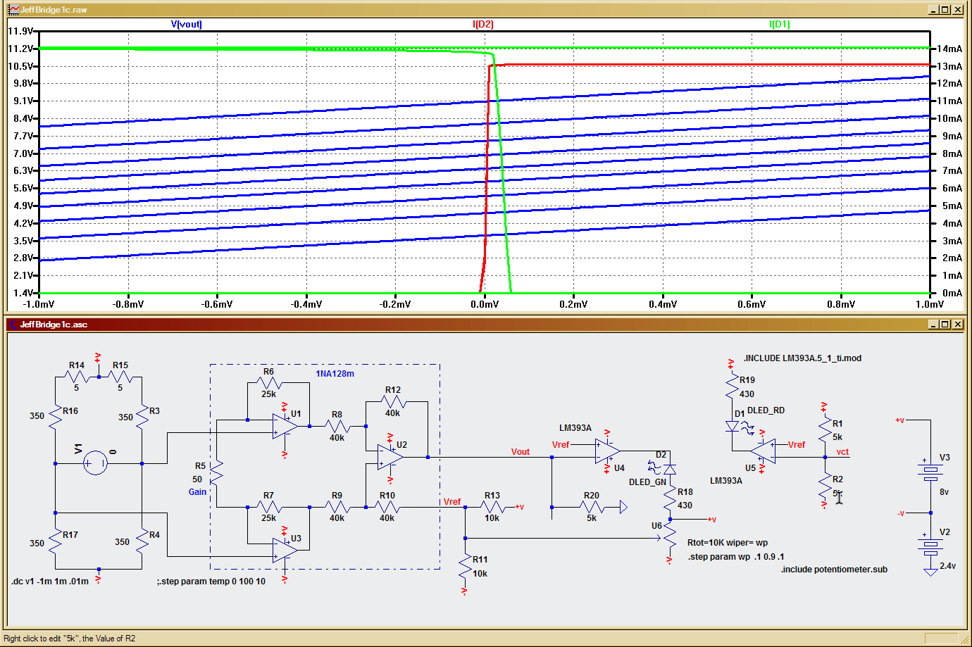

I have a working LTspice sim of the 'boxes' section and a the14v/8v/2.5v

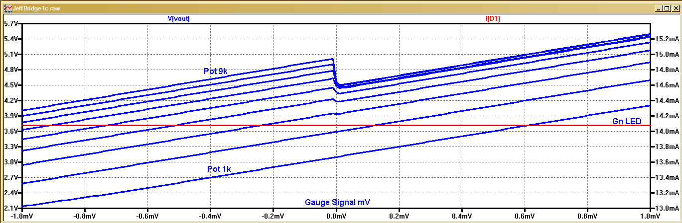

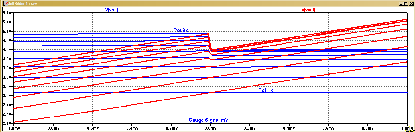

Look at these images for the 'draft' version of your 'boxes' in LTspice.

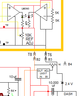

LM393 Comp, missed putting a connection there. 8v is an LM317
I guessed it may be a LM393, thats what I used.
Look at the sim images I posted.
EDIT:
Sim with the +8V added to the Red led.
All sim images in post 22 show the missing connection that was corrected in post 24, of particular interest to me would the I(V2), with the 8 V sitting on the 2.4 V zener, my mid point adjustment becomes 5.2 for the rest of the circuit and the only controlling input voltage that will vary with battery voltage will be the amplitude of the triangle wave. It's looking like the 8 v sitting on the 2.4 v zener will work, can you attach the .asc file for me, please. Still thinking, looking, changing and testing new ideas.

Attached asc file [with the +8V mod].
I would like to see any of the asc files you create.
The LM393 model is from the LTS Yahoo user group site.
BTW: R20 is to that pin on the triangle gen
  • JeffBridge1c.asc

Latest change, did away with zener, 8 volt goes to bridge only (22.65 ma).
My biggest problem was coming up with enough connector pins in the enclosure box and on the circuit board. Had to drill holes in the circuit board and replace the 8 pin socket and plug with a 12, couldn't do anything with the box so I spliced into the key wire going to the box.

When you finalise the design I would recommend adding noise/RF filtering between the bridge and the IA, various examples of filters are shown in the IA datasheets. Also a simple R/Cap filter on the output of the IA would be a good idea.
I'm assuming also as its a 'mobile' piece of kit powered from a 12V vehicle battery, so reverse voltage and good power rail filtering will be essential
