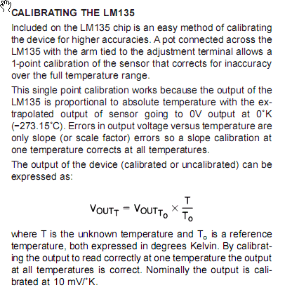

The basic circuit for the LM35 only covers +2C thru +150C.
IIUC the OP wants to go down to -4C.
This can easily be done, but it will require some changes to the LM35/PIC interface.
The LM335 type is in Kelvin, so a little program maths is required.

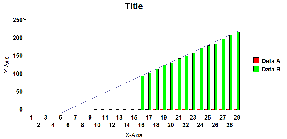

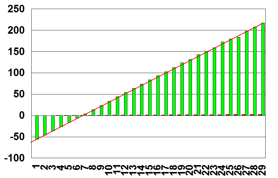

Plotted your 1st resusts.
The slope is OK, nice and linear, BUT the OPA has a -mV error offset.
You will need to add a zero adjust pot circuit.
How did you measure the mV inputs.?
EDIT:
Check the output of the OPA with the inputs shorted, post what you measure.
EDIT2: added a second plot, shows the error more clearly.

how to connect the zero adjust pot circuit? can show me the schematic of the circuit?
hi Ben,
The usual method is a 10K multi turn pot about 10K.
Connect one end of the pot to +V via 47K resistor, the other end of the pot to -V via a 47K.
The wiper of the pot is connected to the INV inp of the OPA via a 10K resistor.
Disconnect the thermocouple, connect the NI inp to 0V via a 1K0, adjust the pot slowly for 0V out from the amp.
Both halves of the dual amp require this zero pot.
