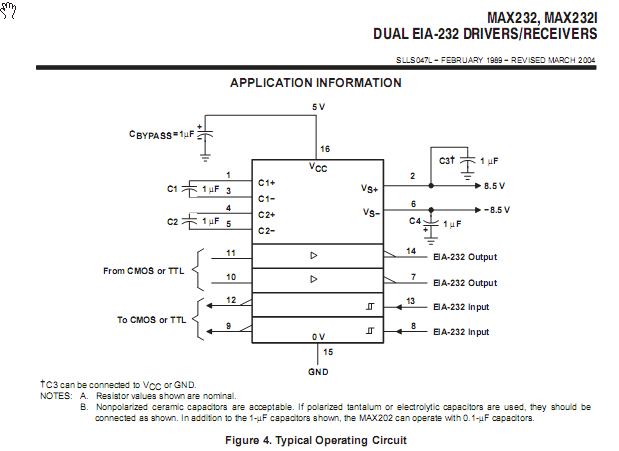

i have connect the pin 5 of the RS232 to ground, about the missing cap at the MAX and PIC, can show me which pin am i need to connect the cap? or do u have any schematic diagram of connecting the thermocouple circuit?

Look at this dwg for the MAX connections.
Do you have a datasheet for the thermocouple that you could post.??
What range of temperatures do you want to measure.?
