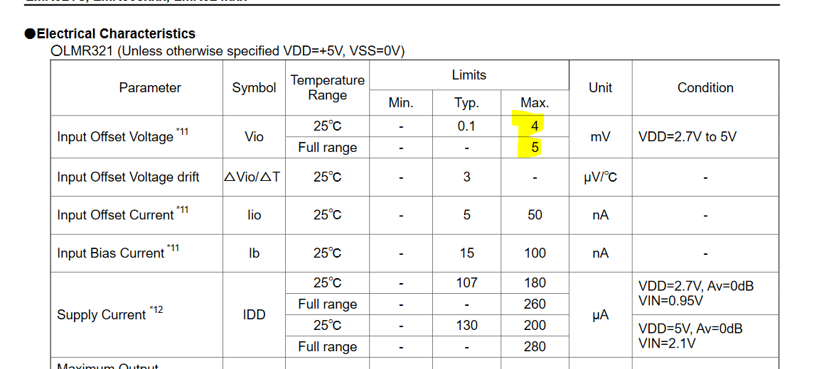

Hello, i want to sense at least 10mA on 0,01R -> 100uV
So i need to choose max input offset 100uV.
Why mouser display typical /average?/ offset from filter settings lower or equal to 100uV?
For instance lm321
Sorry it was silly question. I just select in filter Vos lower than 100uV, but mouser shows op amps with Vos_max higher than needed ,which is unusable i gues.
Some of those parametric selection tools are pretty dumb. I thought Mouser's one was ok though. I think it comes down to some manufacturers quoting maximum values in their general description, and others quote typical..
