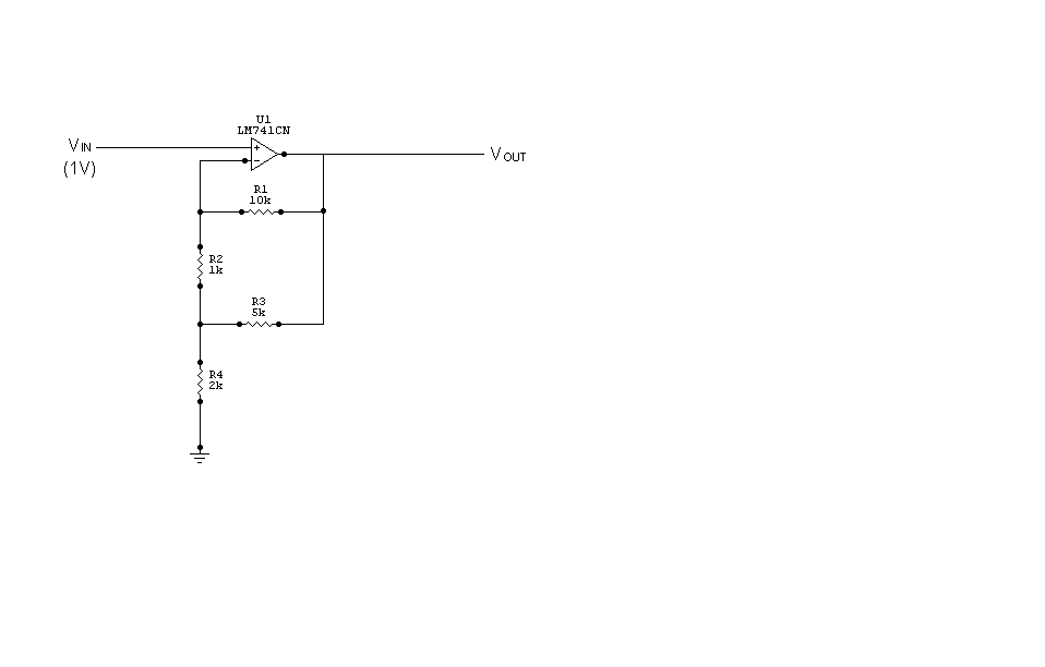

Op Amp Feedback and Design
R3 is the opamp's load that has nothing to do with its output voltage since most opamps can drive a load as low as 2k ohms perfectly. The 5k load is nothing.
The voltage gain is 1+ (R1/R2).
Even if it was a gargantuan value such as 1MΩ, it wouldn't have any effect on the output voltage?

If the load on an opamp is anywhere from 2k ohms to infinity (nothing) then the output signal is not changed.
Interesting, so let's change that resistor to 1k. How would I calculate the output voltage now?
Austin
You must look at the datasheet of the opamp to see how high it can make the voltage on the 1k load resistor. It depends on the supply voltage and how much voltage loss occurs when the output transistors saturate.
If the load resistor is reduced to 1k then the output signal level still will not change (unless the output transistors saturate) because of the extremely high internal voltage gain of an opamp and the resulting very high negative feedback.
Alright then, let's consider another example in which we can solve for Vout.
Austin
Your example is really a resistor divider problem, not a opamp thing... the R1, R2 node is 1V... what is the Vin (output of opamp) needed to make that true? Answer that question and you just solved for the opamp output voltage.
