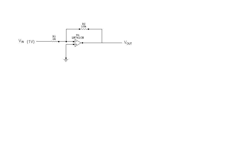

Thanks indulis, I applied a schematic to your example in the attachement. I solved the inverting amplifier using nodal analysis:
Vin = V+ = V- = GND.
I1 = 1V - 0V/1k, I2 = 0V - Vout/10k. Since I1 = I1 (I'm not quite sure how?) The equation becomes ---> -10k/1k = Vout/1V ---> Vout = -10V.
Could you please provide an example with 3 resistors, and show how to solve for the Vout = G * Vin equation?

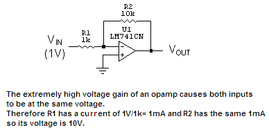

Just use Ohm's Law to calculate the currents and voltages.
The input current is nearly the same as the current in the feedback resistor since the opamp has an extremely low input current (some have no input current) and because the voltage gain of an opamp is extremely high.

In the attachement you have 10V as the output, while it's actually an inverting amp. Thus, -10V should be correct?

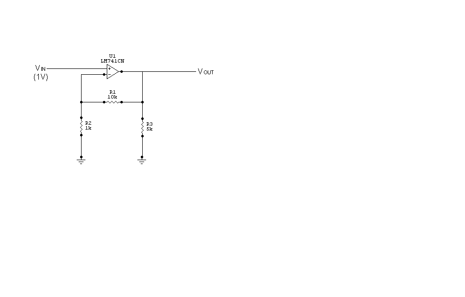

3 Resistor Example
In the attachement is a op amp circuit with 3 resistors. Can someone show me how to calculate the gain and the Vout of the circuit?
I'd appreciate the help tremendously!

Your opamp has positive feedback instead of negative feedback so it will simply latch its output as high as it can go or as low as it can go. it is not an amplifier.
Thanks for pointing that out! It's now fixed.
Austin
R3 is the opamp's load that has nothing to do with its output voltage since most opamps can drive a load as low as 2k ohms perfectly. The 5k load is nothing.
The voltage gain is 1+ (R1/R2).
