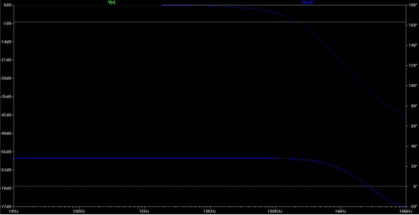

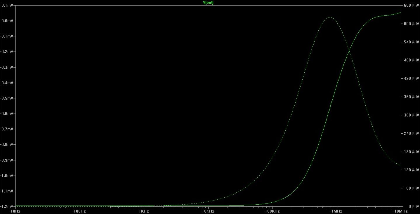

-1.2m is meaningless. Maybe it is -1.2mV?
475 m is also meaningless. Maybe it is 475mV?
Why is the amplitude of your signals so low??
Why don't you correct the negative supply? It shows +15V but its text is -15V. The symbol is also upside down.
i really not sure why my vee got problem.it is connected to -15v.i am really a beginner,maybe i cannot follow your meaning,can you modify the circuit for me?

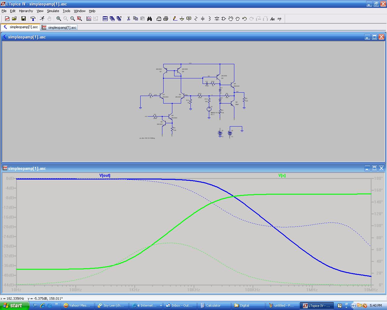

I changed one of your output transistors to a generic PNP, because my LTSpice didn't have a model for yours. That's the only change besides correcting vee. Try running my .asc file. It that doesn't work, then I just don't know.
BTW, your differential stage was OK. I am just used to seeing it drawn differently.
ya,the problem is the pnp.after change it i gt the same waveform like your.by the way,what is the gain of the circuit?seem not achieve gain 4000.
