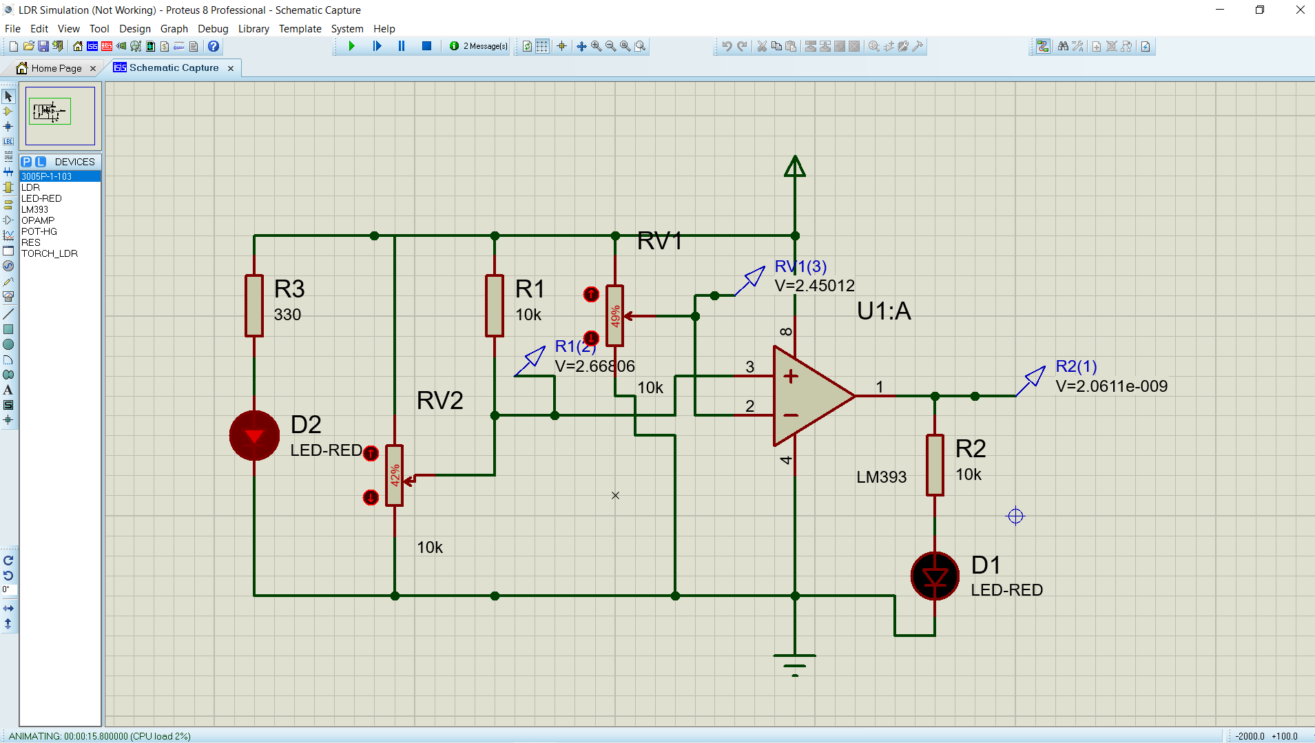

This is my first time doing a project related to Op-Amp comparator. For what i learn from all the books and online tutorial, when the Non-inverting voltage is higher than inverting voltage, the output of the OP-amp will be the +sat voltage(In this case 5V) while when the Inverting voltage is higher than the Non-inverting voltage , the output voltage will be -sat voltage( In this case 0V). But what i get from the simulation is that when the Non-Inverting Voltage is higher than the inverting voltage, the output voltage of the op-amp is almost 0 while when the inverting voltage is higher than the non-inverting voltage, the output voltage is even smaller and closer to 0V. Anyone know what happen or what should i do so that when the Non-inverting voltage is higher than the inverting voltage , the output voltage will be 5V and the LED will light up?
Thanks in advance!

The output of the LM393 is an open collector.
Look at the datasheet:
The LM393 is not an op-amp it is a comparator, there is a difference.

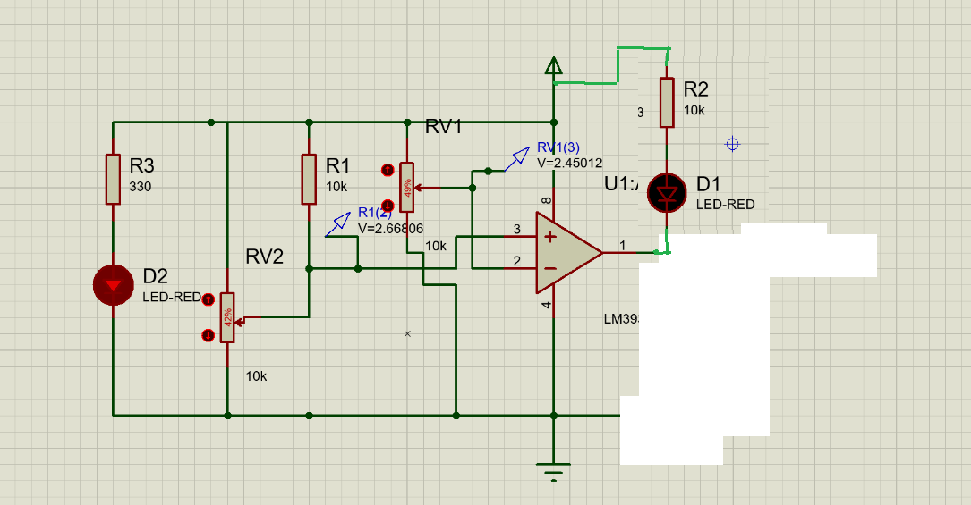

To make it all work, connect it up like this:
Please excuse the scrappy sketch.
