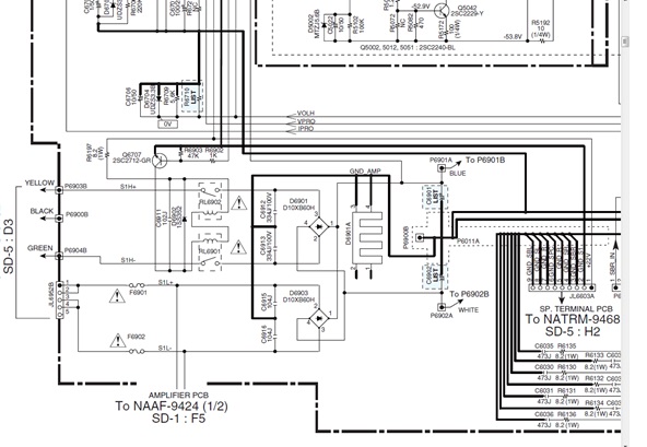

I am working on an Onkyo SR606 amp which has problems with going into protection mode. I have isolated one channel due to shorts on the output transistors but it is still doing it. To make it harder it only does it intermittently, sometime can go 15 min with no issues, other times straight away. This happens with no inputs or speakers connected.

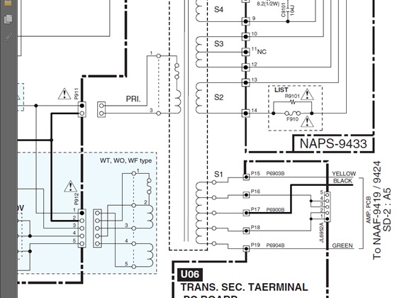

So, I am working through the schematics and have come across something I have not seen before so would like your advice. I am looking at the power supply circuit which I have attached. The voltage from the transformer between the yellow and green cables is 87 Vac and at plug J6952 is 43 Vac. Looking at the drawing both these supply’s go into bridge rectifiers and they are then connected in parallel on the output. So, I was expecting about approximately 87 Vdc on the output, but I am getting 110 Vdc on both rectifier outputs.
Am I missing something? Also, it has a ground amp which looks like it is connected to the center capacitor network on the bridge inputs. I have not seen this before and cannot find much on the net to understand what this is for. Can anyone give so advice on this part of the circuit please.

I got an answer from Mooly on a different forum which I thought I would post here in case any one is interested. i forgot I was measuring in RMS value with the fluke meter below is Mooly's quote
Quote
The 'ground amp' may be a 'virtual ground' that makes the DC supply behave like a true split or dual type supply. The Quad 606 power amp and derivatives use this technique.
However it isn't clear from the diagram snippets that this is definitely the case because the 'ground amp' appears to have no other connections to it other than 'ground'.
This explains virtual grounds for low power devices but the principle is the same:
Virtual Ground Circuits
When you rectify and smooth an AC voltage the resulting DC is approximately 1.414 (root 2) times the AC value.
In other words, 87 volts AC is an RMS quantity, the peak value of which is 123 volts. This peak value is the value the reservoir cap will charge to.
