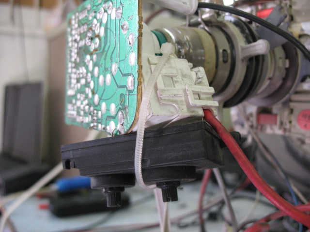

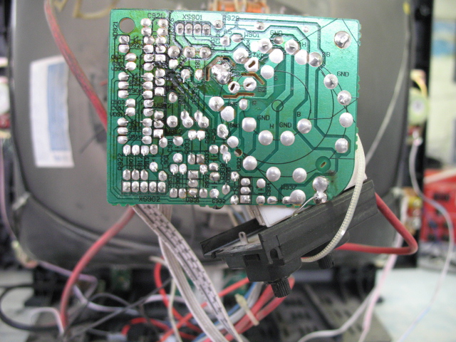

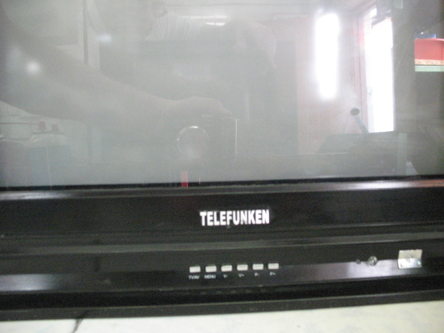

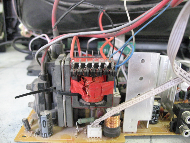

Hi All.
This thing was basically released from a factory somewhere in China. Cabinet and looks are great. 21 Inch flat screen tube as well. TV picture is so..so but will pass if compared to similar sets. Nothing to brag about. Ain't an LG or a Samsung though.
So with interest, I open the thing to see what is inside this beautiful casing. You never know these days anymore with the Chinese dumping all their crap in South Africa with total support from our Guvment. (That's how the masses who buy this stuff both say and spell words).
Anyways, here are a few photo's I took of this abortion earlier this afternoon. I will explain after the photo's.
OK. They loaded.
The first one is of the Tube Base board (factory mod).
The second one is also the Tube Base board (factory mod)
The third is the actual TV. Telefunken. Chinese rip off.
And the fourth photo is a mod to drive the Vertical Scan coils for this absolute abortion of a chassis (factory mod).
Note the cable ties.
To the untrained eye, all looks OK.To the trained eye something is wrong.
All I am saying by posting these pic's is this is the kind of crap (the dregs or very last of bits and pieces) China is pushing down South Africa's throat right now. I fixed the set. In spite of all the "factory" mods.
Maybe many people reading this post would not comprehend. FFS it is sooo difficult to explain sometimes.
If this abortion breaks within our warranty....we have a pile of poo on our hands.
I am up for the task though....I will just modify it further :):D
Make it better than the original factory mess.....
Cheers

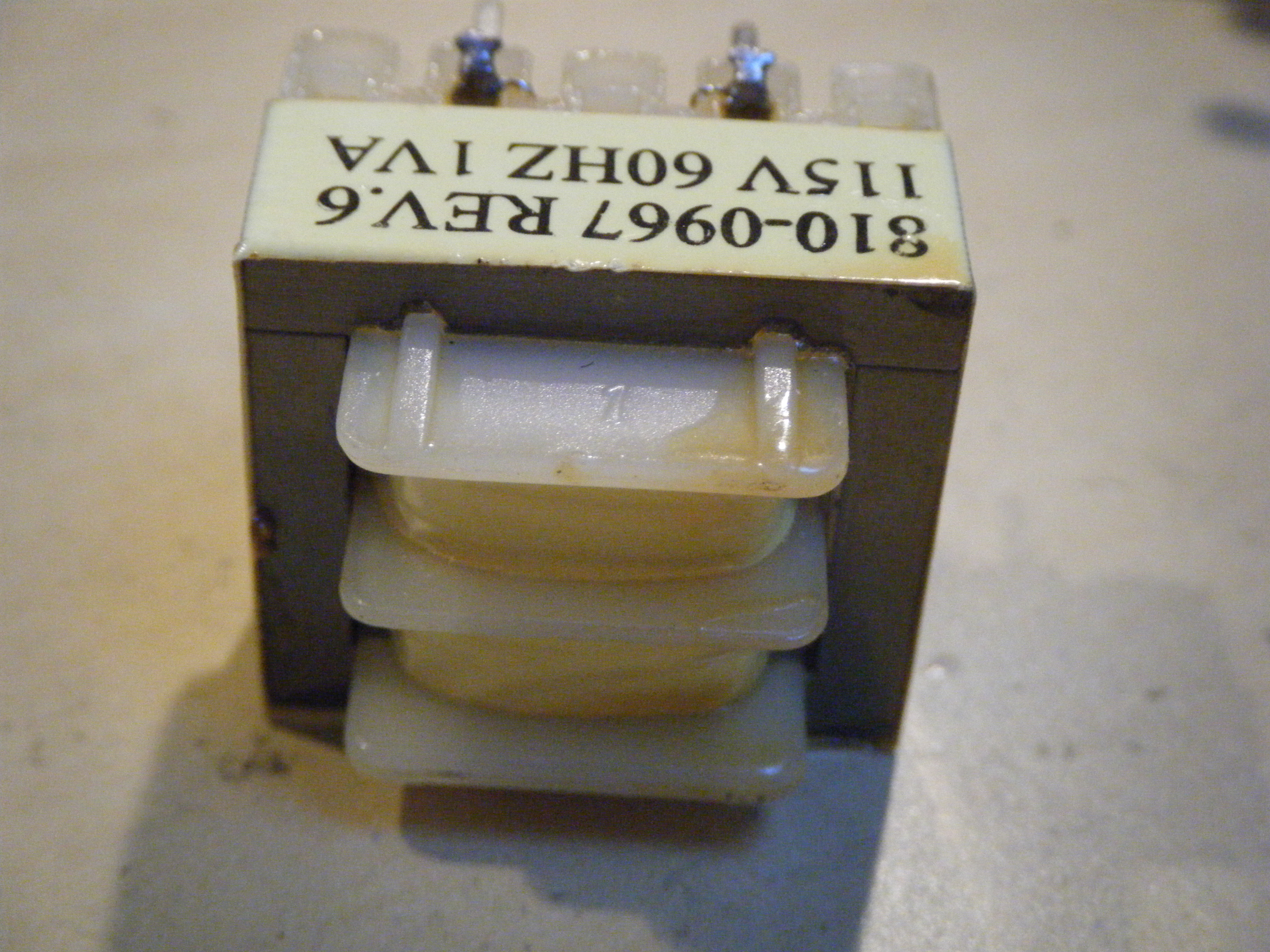

Anyone up for an unprotected transformer connected to mains?!:eek::eek::eek:
Are you sure it's not got an internal thermal fuse?, which will die at the first opportunity.
Probably has one. They are normally embedded in the outermost secondary winding (if I remember correctly). We had issues here years ago with "Techs" breaking open the insulation on Black and White TV transformers and simply bridging the Thermal Fuse out. With wire.
A case of "Hey, the transformer she is not burnt. I will try it....it's working".........
Hectic days. Very luckily (as far as I know) no loss of life.

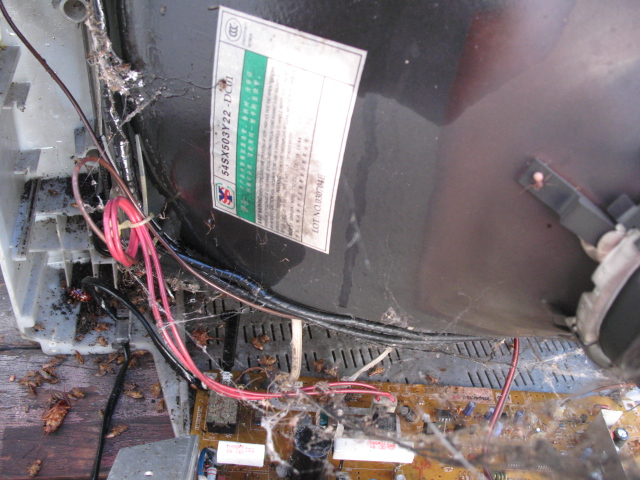

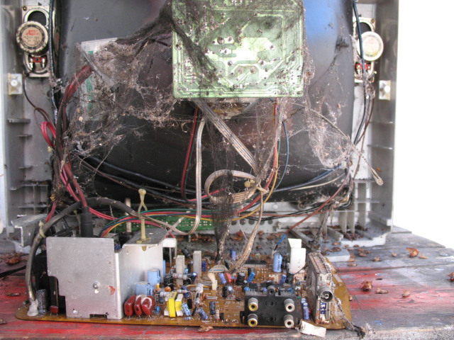

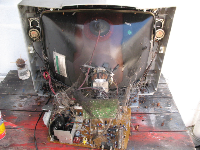

If you are busy preparing food, or have just eaten, or are thinking of eating... better not to view the photo's posted far below. Especially if you have just eaten in someone else's house.....mind you, even visiting them and sitting in their lounge could be a problem. You could start itching for some unknown reason. It's like there are things moving. You can't really see them. But you swear you felt something moving on your arm or leg or even face.
The most common place for a family to gather around when a guest visits is probably the lounge. TV is there. When conversation hits a lull...turn the TV on and all is good.
So, anyway, this set came in today. Please remember people 99% of our repair business comes from Non Whites. This TV also came from a Non White household.
I am going to stop there and explain a few things :)
Whites can be dirty.
Blacks can be dirty.
Humans can be filthy.
In all my years of doing Service Calls for a major service company in South Africa I never once encountered such a nest...ever. Our customers were almost all white.
And yes, I know the drill. Roaches don't really worry me. As a TV tech they are a part of filthy peoples lifestyles. We do all colors here.....
I swear to God above, I have yet to find a Roach in a White persons TV. No matter how poorly they live.
White people like cleanliness. And the stupid blecks running the country now simply don't care.
Here are the pics at last
Can't upload the last one. Oh well. You have probably seen enough.
The photo's don't do justice. Most of the cockroaches had already fled out of the Chassis by the time I grabbed my camera.
And they fled because I sprayed them. With poison. Roaches don't die easily. Disgusting things.
Cheers

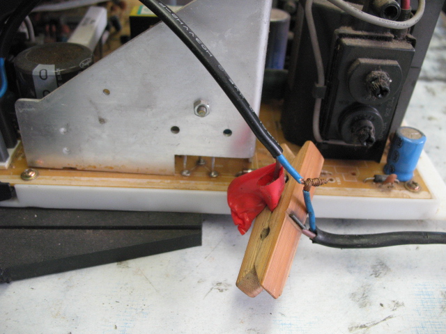

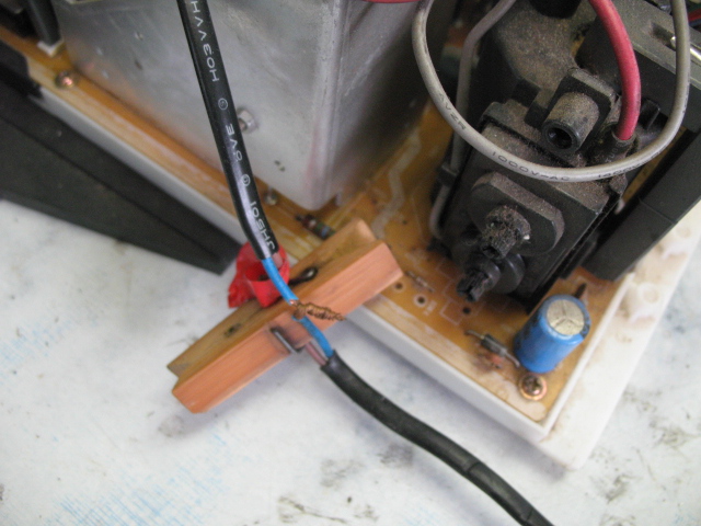

Here is another I found in my archive...
This set came in way back. Clean outside....but a Rocket Scientist found a use for a peg..inside the set. No washing here, just 220VAC.
LOL :D
Cheers
Yip Nigel
Brown is supposed to be Live. Blue is supposed to be Neutral.
And you get a a two prong plug from the factory which can fit anyway around....
So everything can change.....
SMPS are not fussy though.
Cheers
