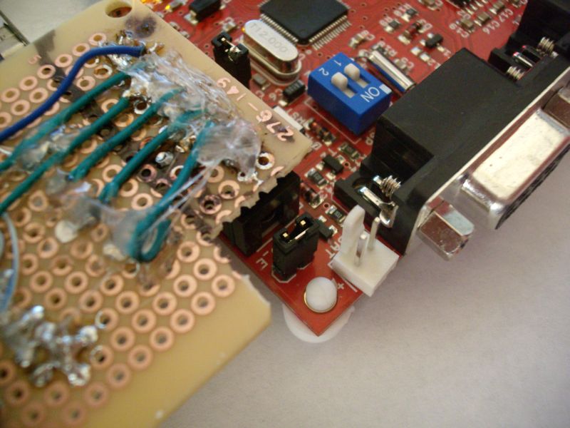

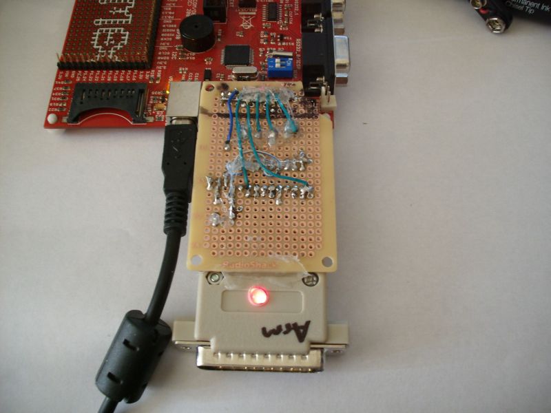

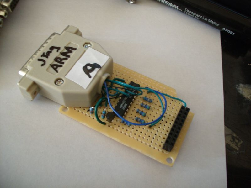

Here are some pics of my ugly but working like a champ! jtag wiggler clone lol
The first image shows how i cut the PCB to enable me to get to the debug jumper.
The other 2 are the top/bottom of the jtag. I added a led to verify it plugged in correctly and ground and vcc are ok from target.
I didnt have a IDC Female connector of 20PIN and no hard drive cables since i use SATA :(

Very cool. I made up a wiggler a long time ago and never ended up using it. I pulled it out a couple months ago, but I think I got the wiring wrong on the JTAG connector.
I'm going to try out an 8pin JTAG connector on my future boards and see how that works out. These 20pin connectors are massive. Even 8pin is gigantic and inconvenient compared to my old 3pin program/debug header.
heh im since i know what to wire i can probably make it into a 2x5 header with no issue. Those would be a lot simpler and cleaner to use :D
A 3 pin omg i think that would be so nice to have. I would make so many different adapters like use a stereo headset jack or tel jack, use cable ect... would be cool!

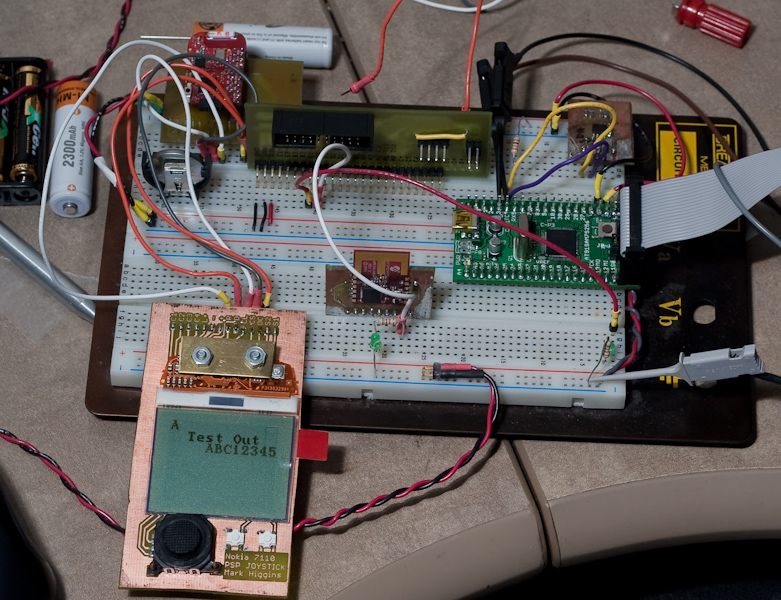

just converted some LCD code for LPC2148 and NOKIA 7110 lcd:

Works!!! yay!

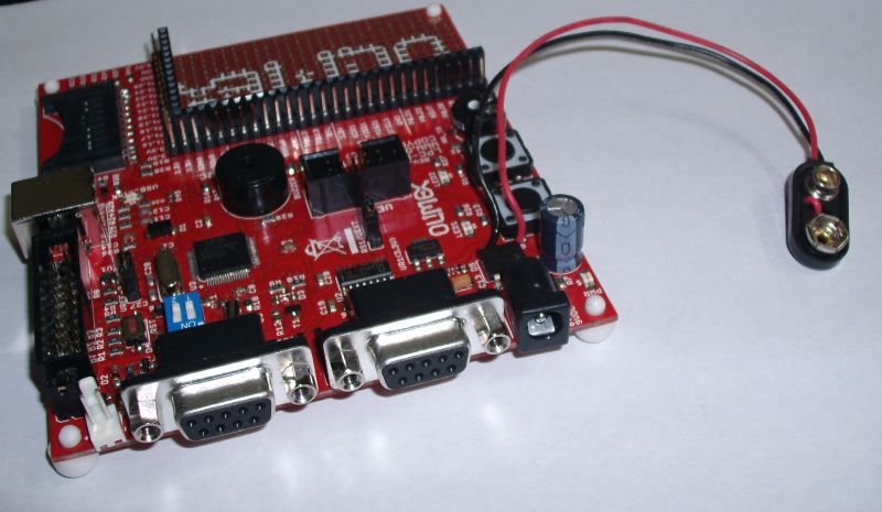

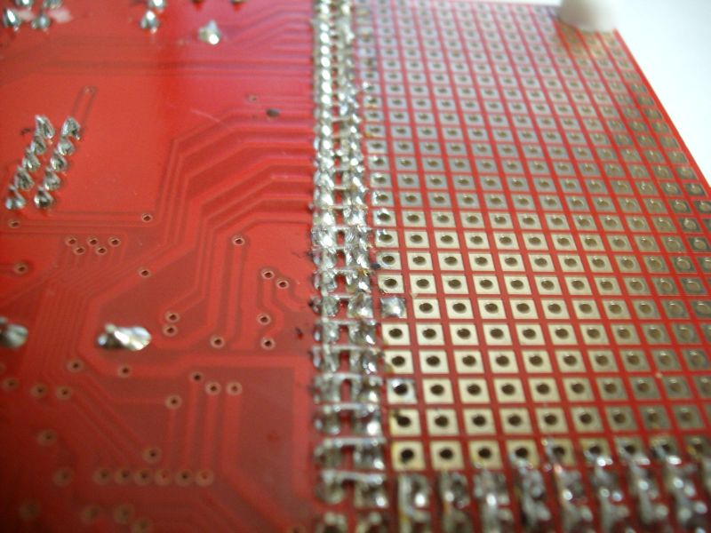

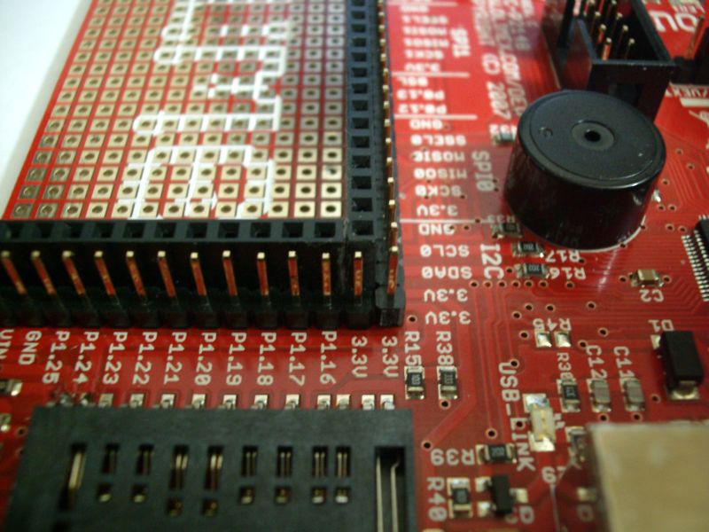

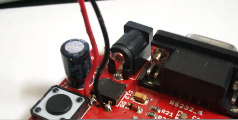

Hey Mark check these mods i added:
MOD 1: Female header added...
Top Side:
mod1-jpg.31305
Circuit Side:
mod1-1-jpg.31306
9v Snap: ( use them with the 4AA holder ) so for me its a 6v Snap :D
Full View:
mod2-jpg.31307
Circuit Side:
mod2-1-jpg.31308

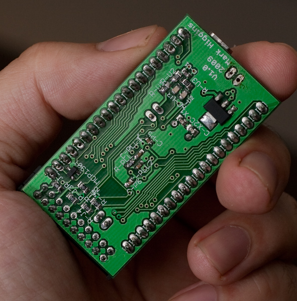

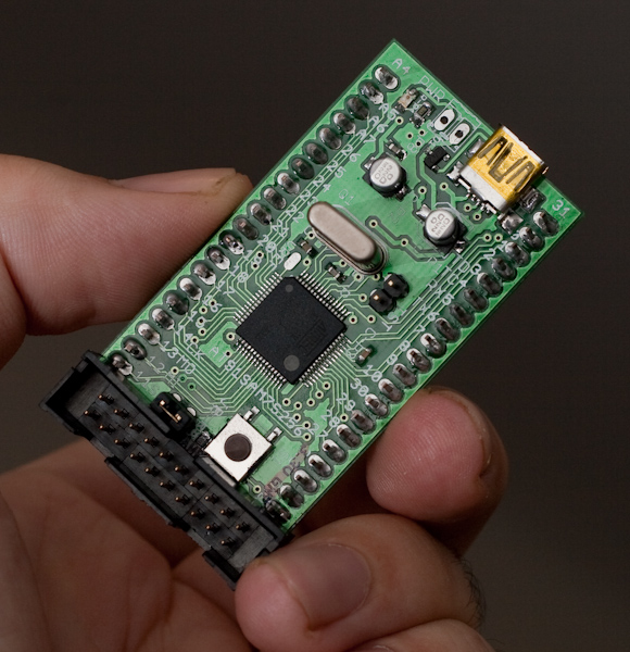

I did the same thing with an old PIC development board I had. In fact I still have it on the shelf. It's pretty ancient. (Ancient by my standards; not by the standards of the old guys who used vacuum tubes here.)
I know you got it as a deal, but I'm not a fan of those development boards with everything on them. They're too bulky. I had to make up my own plug in header board for the SAM7. The pins go above the board as well as below, so I can clip on the logic analyzer test leads.
(firefox is making my images look like crap for some reason.)
heh... firefox on my side shows them well :D Thats a niec board. I havent dont a PCB in a long ...long time and i want to start so bad! Especially with these SMD parts.
I think i would have a ball making small boards like that for testing and using on a breadboard. Then making a final product.
The reason i like these larger boards is mainly because im a lazy guy . If i can save time by having a few buttons, sd card, buzzer, leds, usb, serial stuff already wired up and in a good configuration then i will love it. If anything i can simply copy the schematic with only the parts i need and save tons of time.
I due love those smaller boards because you have more choices of what goes where.
If i was you i would make small Mikro type addon boards. Where you can simple attach a header to that small board and have buttons and ect... ready to use.
Just give me a few weeks to get everything straight and ill try to create a board...
Remember this tho... if its crappy but works its ok but if it looks nice and fails its bad :D
