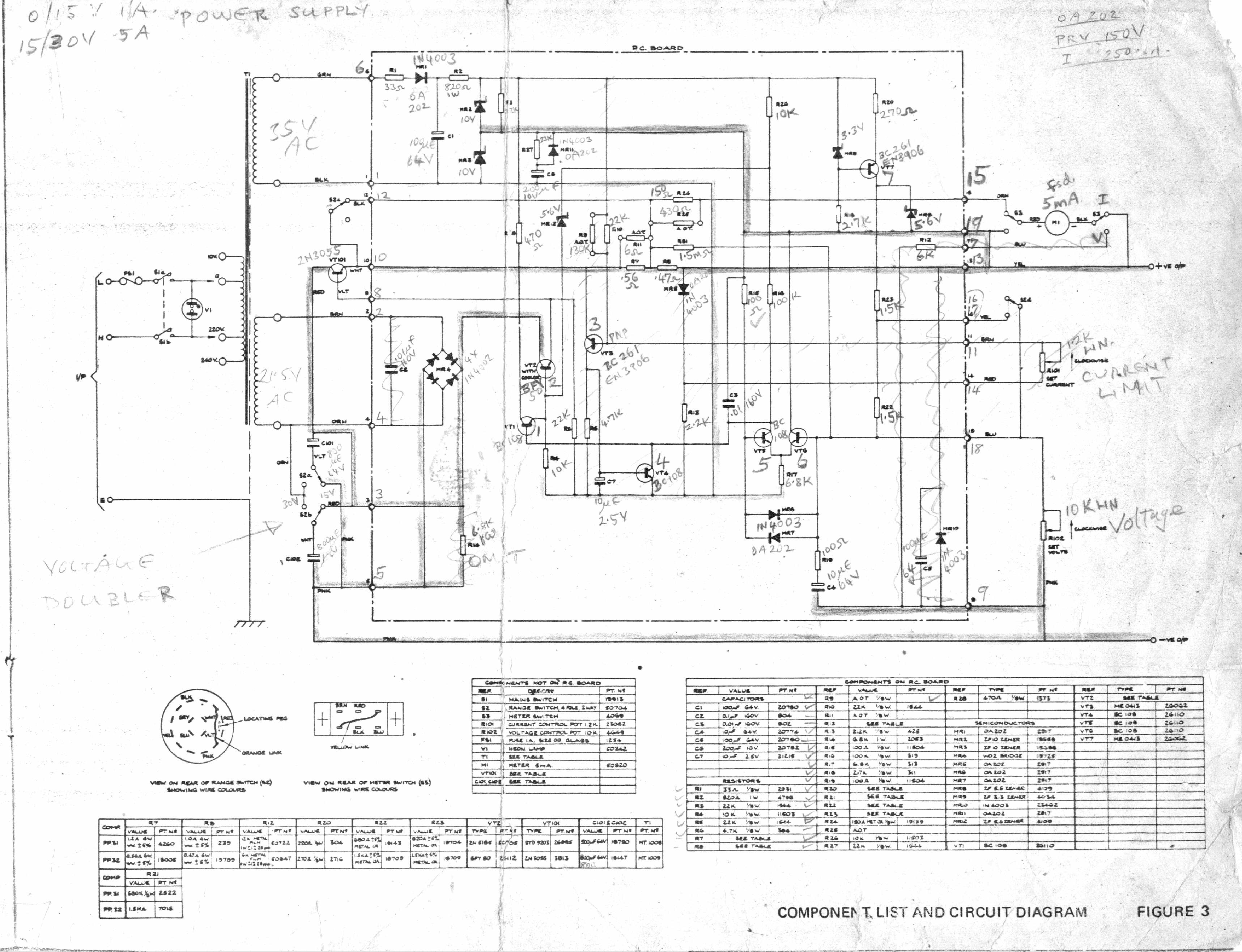

I have an old Farnell bench supply that is working fine, but I would like to improve the internal voltage reference. It uses a transistor/ zener CC source to drive a 5.6V zener.
I have attached the diagram. The part of the circuit I'm referring to is in the top-right side.
Is there an improved arrangement I can build in here without totally going too haywire??
Any input will be appreciated. Thank you!!

I suppose, seeing as he mentioned the 5.6V zener reference, he could replace that with a TL431 precision voltage reference, and a preset to adjust it to 5.6V.
However, the 5.6V zener is already fairly reasonable, as it's chosen for it's close to zero temperature coefficient.
The 3.3 volts zener sets the current (Together with R20) through the 5.6 volt zener. The 5.6 volt zener is the actual voltage reference. How far out is the voltage across the 3.3 volt zener ?

I measured 2,8v across the 3,3V zener.
I even thought if replacing the 3,3V zener with an LED. Rework the resistor values to get the same current as in the schematic?

Probably because it's closer to 3.3V, however, why would you imagine an LED is better than an actual zener?.
2.8V across the 3,3V zener is probably quite normal, the actual voltage depends on the current through it, and on the tolerance of the zener.
If it's 2.8V then the circuit will still work perfectly, just that the constant current will be a little lower (which will make no difference, it's been 'constant' is what matters).
With a supply of that type, you're always setting the output voltage with reference to a meter, so the absolute accuracy of the voltage reference isn't that important. I always set mine with an external digital meter if I care about an accurate voltage.

For what its worth. I noticed that if i decrease the 2k7 in series with 3v3 zener to 1k2, the voltage across the 3v3 zener comes up to 3,3v. Does this mean it is not getting enough current?
Low voltage zener diodes do not have a well defined zener voltage.
The zener voltage varies over quite a large range as the current through the zener diode is varied.
It is most likely that this is the effect which you are seeing.

It means it's not getting enough to give 3.3V across the zener, but as I've already explained it doesn't matter - I'm quite bemused you randomly measured the voltage across the zener in the first place?. The existing resistor is probably calculated to give the desired current from the CCS, so randomly altering it probably isn't a good idea, when you have no idea of the design specifications from when it was designed. Just because it's a 3.3V zener doesn't mean it should have 3.3V across it.
As I mentioned previously, what is the voltage across the 5.6V zener, that's the only one that matters.
Thank you all for your input. I have checked the voltage across the 5V6 zener it is spot on. Even with the lower measured voltage on the 3v3 zener.
Guess I didn’t understand the circuit.
