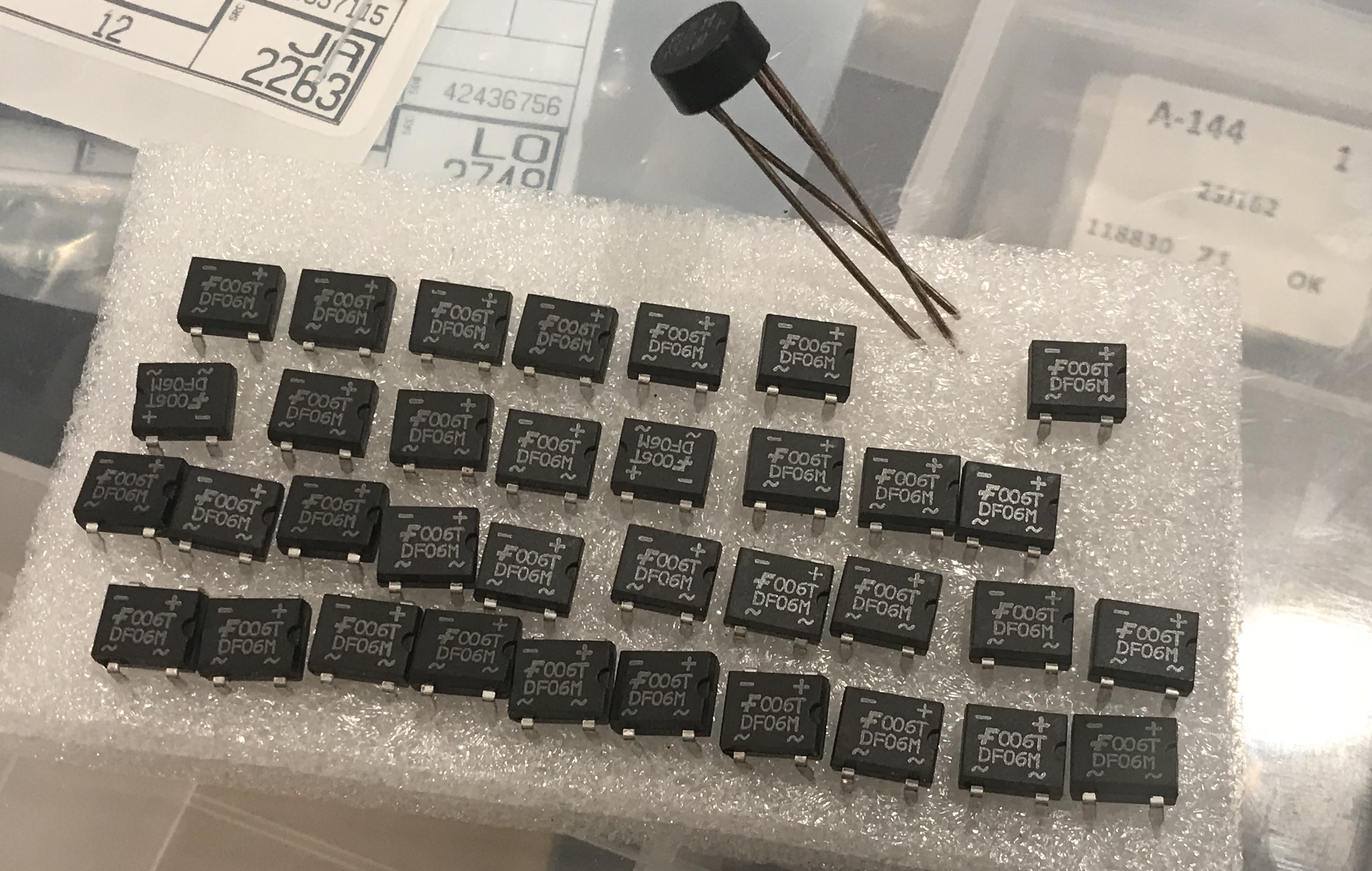

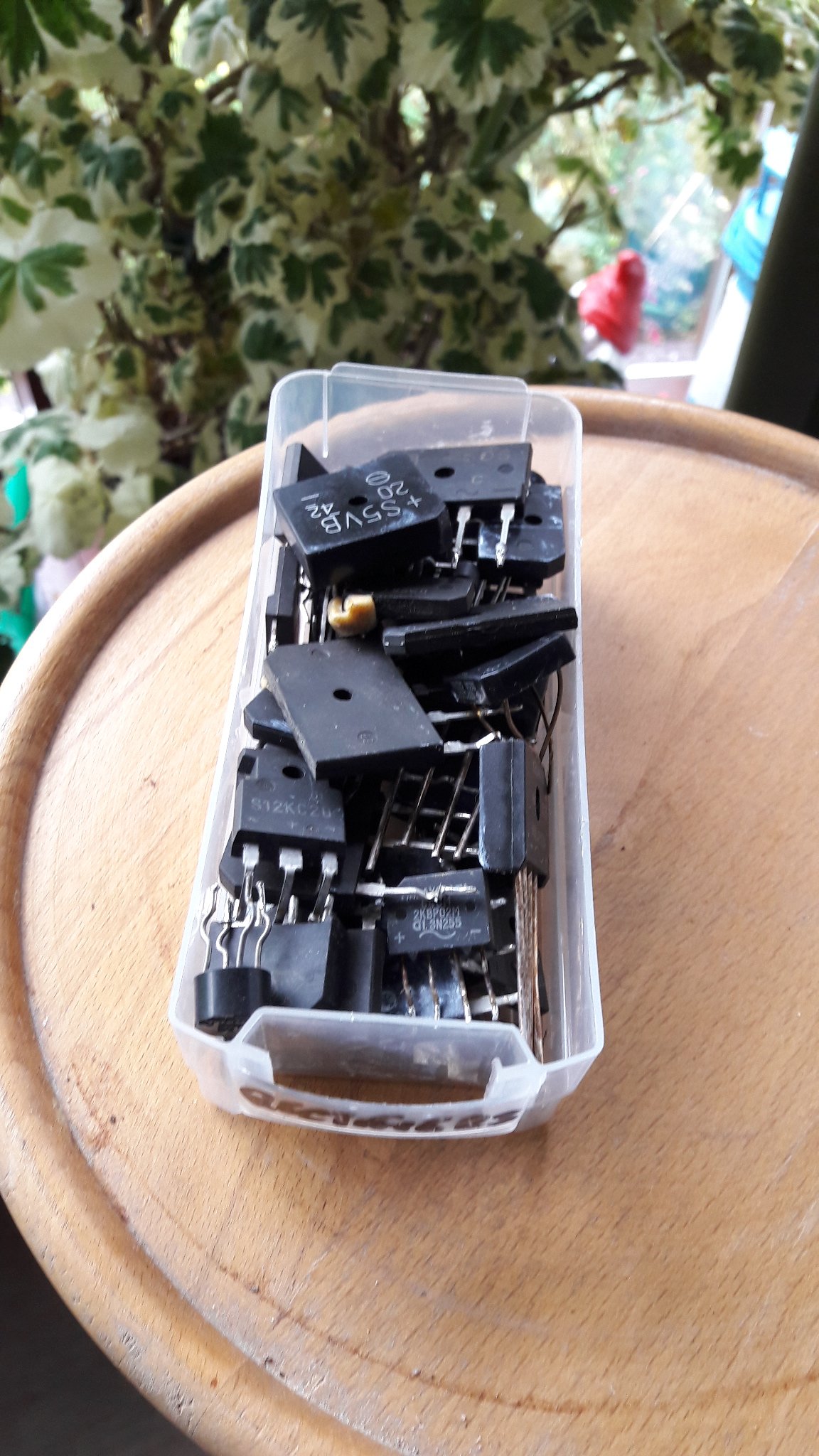

I was going to say I'll send you one of these for nowt, but none are that physical size, plus these are salvaged so could be blown anyway.
