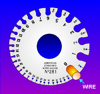

Don't know where the gauge picture came from, but thats not how they're used. You don't put the wire in the hole but instead you put it in the slot. The hole is just clearance to make the slot.
I don't think they was thinking of how you use it. But I slide the wire in the slot and pull it out the hole but just using the slot is good to but.
I have use gauges just like it.
What is this world coming to anyway I post a picture of a wire gauge you can get at home depot and just cause the picture shows the wire in the hole somethings said
you push the wire in the slot and pull it out the hole it makes it easy to use is the way you use one of these.
And some don't have holes.

When i said "some match and some dont" i was referring to the copper wire vs steel wire or sheet steel, not the gauge itself.
I think it's great that you mentioned that thing. I never had one so i used a micrometer for everything then calculate or look up the wire.
Resistance measurement is good, i get 10.3 ohms for 100 feet of #30 AWG copper, and i say that is good because i had obtained some wire that was made from some other material or something maybe with copper plating, and the resistance was wayyyy high. It would not even take solder! I thought my speaker was going bad :)
I never had that kind of gauge, but i do have a similar gauge for spark plug electrode gap setting. It's rounded also, and has varying thickness around the circular edge and a graduated scale to match so you know fairly close what gap you are setting when you place the edge between the center electrode and bent outer electrode. It's graduated in inches though not gauge number, so its' like 0.010, 0.011, etc. Cant remember where i got it though.
It's interesting that AWG #36 seems to be the reference point for AWG gauges. Dont know why they did it that way, but that comes out to an exact diameter of 0.005 inches. The exponent in the formula is zero, so that is what does it, but who or why it was done that way i dont know. Like, why #36 :)
