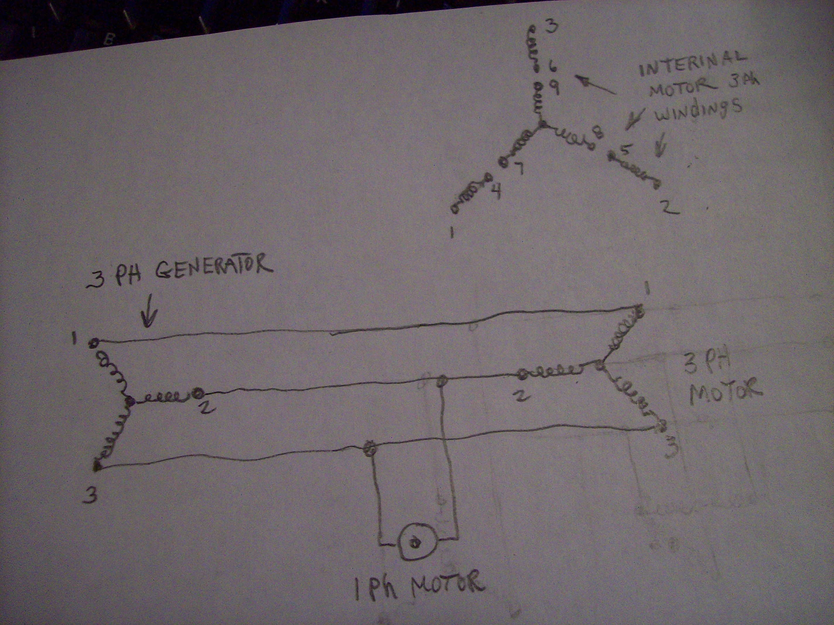

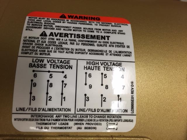

Here is a photo of the tag on a 3 ph motor it can be wired 240v with windings connected in parallel or 480v with windings connected in series.
Here is a drawing I made that shows motors vs a 3ph generator.

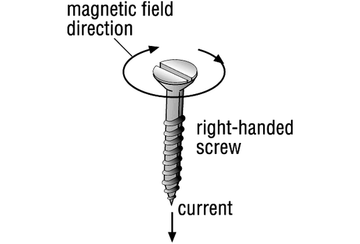

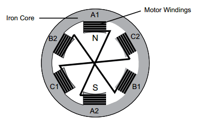

The following picture shows stator windings for a single phase induction motor. We can say that during one half cycle, the upper winding would act like a north pole and in later half cycle, it become a south pole, and so on. It makes sense.
I was watching this video and how the winding is shown doesn't look correct to me. Please watch it from 1:22 to 1:41. It only shows a single loop and it looks wrong how North and South poles are shown. Do you agree? Thank you.
Thinking about magnetic fields makes my head hurt!
But looking at 2:02 in the video and applying the right hand screw rule, I think that the N and S are in the right place.
What is confusing is that the N and S are adjacent to the current indicator arrows on the other wire.
Thank you but I don't get it. The right hand screw rule gives the direction of circular magnetic field and in such a case north and south poles don't really matter. In Figure 2 below, each pole acts like a solenoid. For example, when B1 is north pole, B2 becomes south pole, and B1 and B2 represents a single phase and the wire in wound such a manner that when B1 is north pole, the direction of current in B2 produces south pole. The same goes for the other phases.

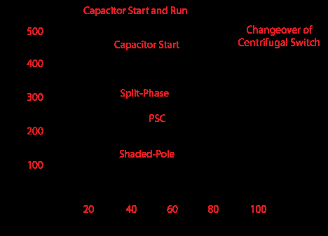

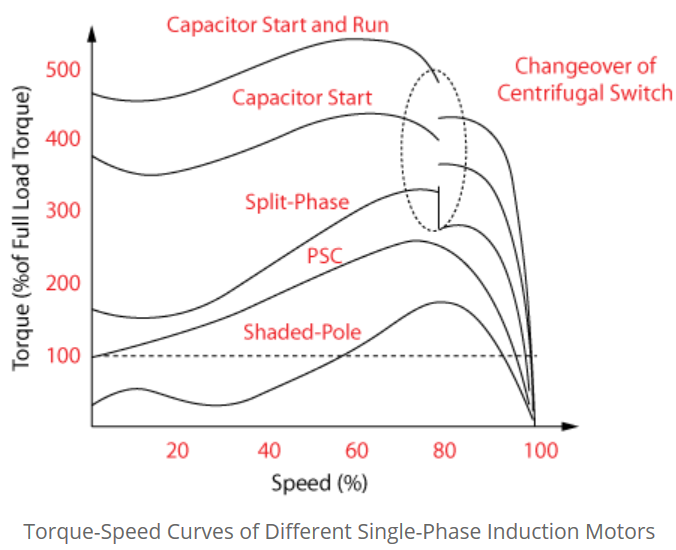

Which one provides more starting torque, capacitor-start motor or capacitor-start-and-capacitor-run motor? The start capacitor is always quite bigger compared to the run capacitor. Two capacitors in parallel give more capacitors or a resultant bigger capacitor, so in my view capacitor-start-and-capacitor-run motor should provide more starting torque. Do you agree? Thanks a lot.
No. The run capacitor adds nothing to the start of the motor. That's why it's called a "run capacitor".
The run cap effect on starting I would describe it as more like an 'insignificant influence' on the starting due to its low value compared to the high value required for the start capacitor.
M.
Thank you!
In my humble opinion, I wouldn't say that it adds nothing to the starting torque.
Agreed. The effect would be insignificant because start capacitor is at least ten times bigger than the run capacitor. Source: https://www.freedomhvacal.com/technical-hvac/blog-start-run-capacitor/
Like Max said it adds so little it is insignificant. It is just like a capacitor start only motors rotating field. The run cap is just helping the run field do it's job better.
