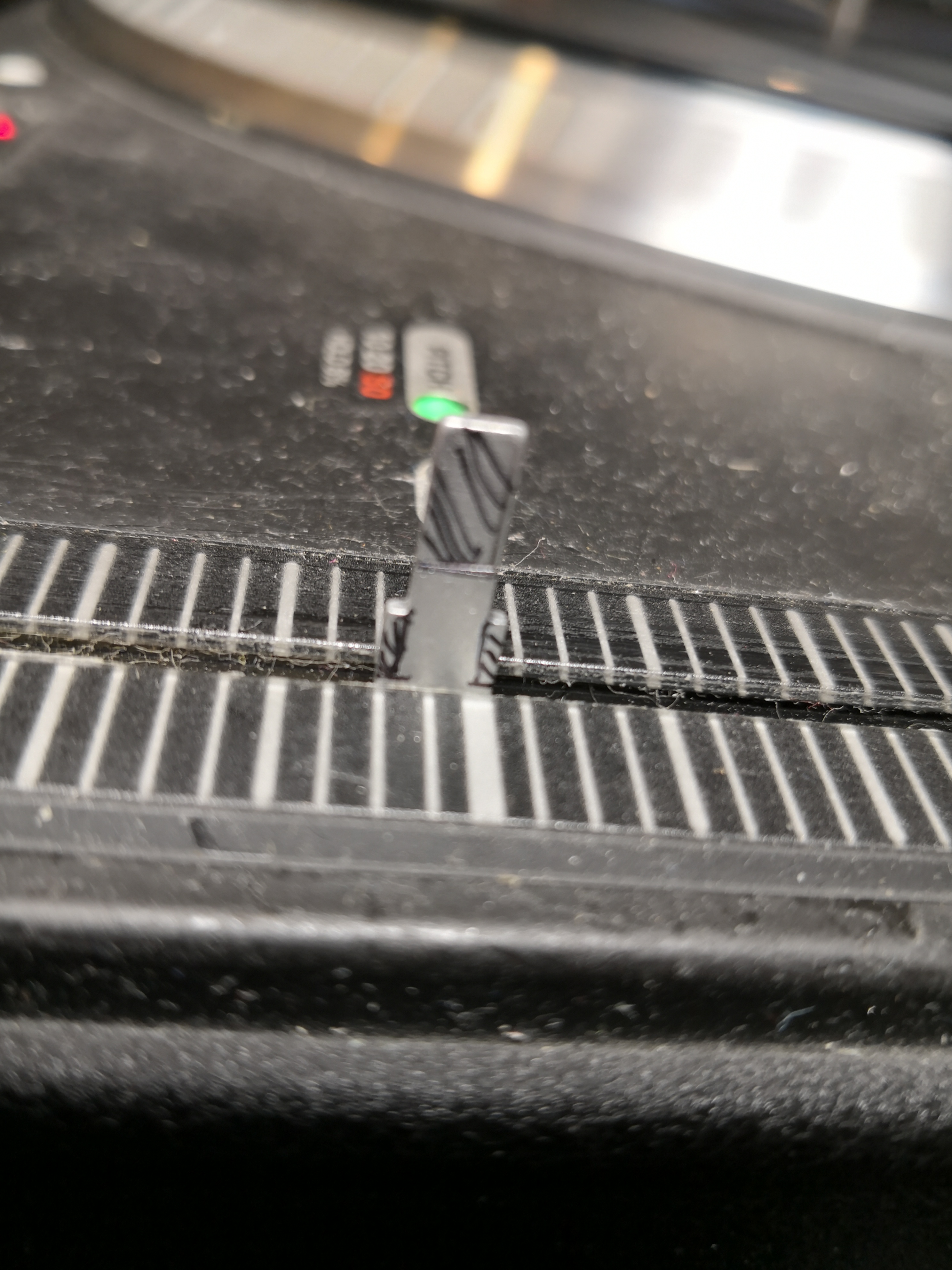

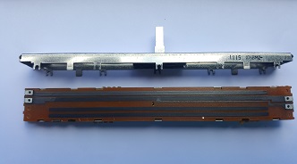

I have two Numark TT500 Turntables and the pitch is not working correctly on both.
The fader that seems to work the best has a change in ohms from 14 to 5 when measured with 10K ohms on millimetre and moving fader. It does not register centre position but more noticeably changes pitch.
The other one registers no ohm changes. so I guess the contact of the brushes is negligible. And will certainly need changing.

The PCB is not part of the "pot"; also the 0105 is almost certainly a manufacturing date or batch code - the value is the "10KB", 10 K Ohms, linear scale.
This should be suitable electrically, if it's a conventional three terminal pot:
The hard part is finding the right size and value with the same shaft type as the original..

I think I may have found a suitable replacement. Based on this very loose Ebay write up in Italian. Been searching a lot today...
I have ordered one to test Has the same number of pins to solder into the PCB, it is same length, same manufacturer - Fingers crossed.

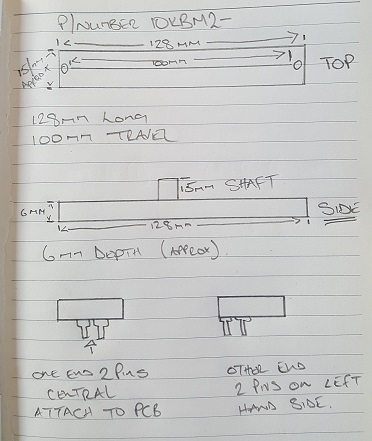

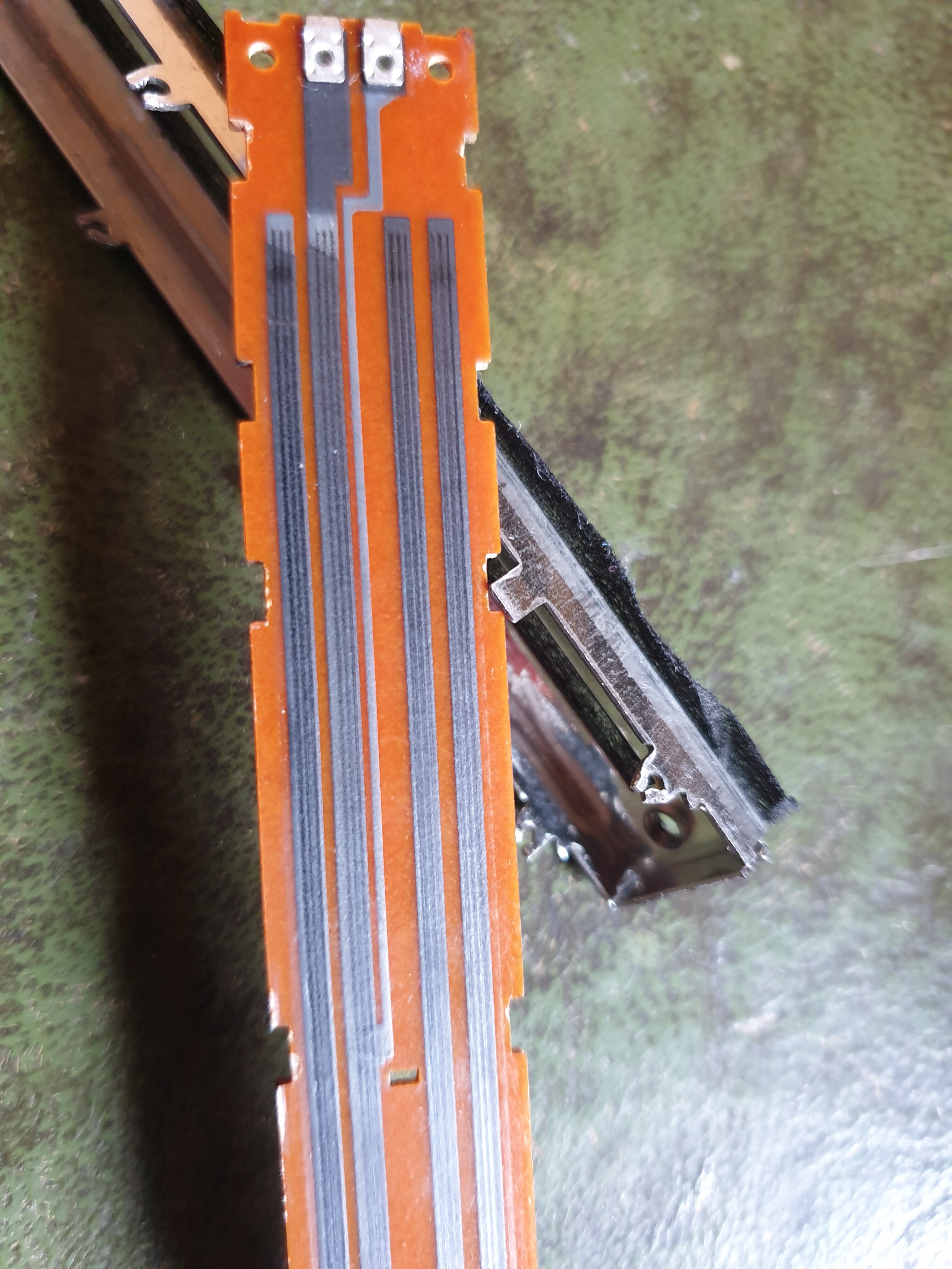

Hi, I am also experiencing the same issue, i've looked everywhere but seem unable to trace replacement pots for these turntables.
I've attached a drawing of the dimensions of the pot alongwith a photo of the carbon tracks inside them.
The main issue that I find when tracing replacements is the fact that they are two gang with a centre tap on the pot, ive tried to clean them with contact cleaner, small eraser to remove deposits etc but nothing has worked.
and to be honest im not wanting to skip the turntables due top this issue.
Any help from anyone will be gratefully received - Thanks Badger (jim)

The issue is probably simply that the pots were specially made for Numark - so the only place they would have been available would be from Numark.
A great many pots were custom jobs, and at one time there were plenty of manufacturers offering such services.

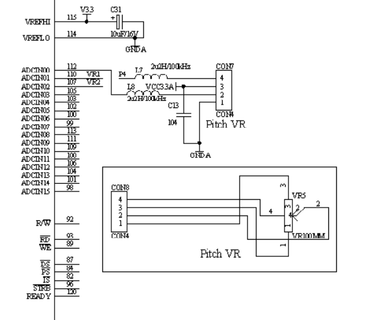

That's interesting - the fourth pin is a centre tap on the main track.
I cannot find a service manual for the TT500, but there is one for the TT200 on the elektrotanya site here:
That uses the same four terminal centre tapped 10K pot.
The tap is connected to the output of a 4000 series shift register used as an expander on the CPU; it selects either 0V or 5V feed to the centre tap !
If the TT500 works the same, it may? be possible to use a normal three terminal pot, either with an extra resistor added from what would be the centre tap terminal to the wiper (if it's an AC or PWM drive) or possibly a couple of analog switch or FETs sections to switch in an extra resistor at one end or the other of the pot, simulating the offset the voltage on the centre tap would cause.
Ideally it needs someone to see what the voltage or signal on that extra terminal actually is while the deck is running at various speeds, with a meter and if necessary an oscilloscope..

I have found solution and it might work for you. See below
Update. Solution
I bought two second-hand TT200 Turntables for cheap. Check pitch fader works if possible.
I de-soldered (very carefully making sure you suck up all excess solder with a de-soldering tool (and not too hot so you don't separate any on the metal from the PCB - there's plenty to solder to if you mess up by scratching the PCB back to metal - even using a little wire bridge if you are totally new to this) and completely took apart the pitch fader - using a pair of needle nose pliers and a point tool like a scriber to open and close tabs. Use a marker to make sure everything stays correctly aligned. Clean everything with contact cleaner. carefully remove any residue in housing. Be careful not damage brushes...
Damaged brushes probably mean you want to replace the track as well. I tried to use the TT500 track, but had to replace with TT200. Worked fine then. More work. So maybe just replace both brushes and track. Try to visually inspect the best brushes if applicable.
The only really difference between the pitch faders on TT200 and TT500 was the PCB - which I have a feeling may be true for all these TT turntables. Something that Numark support don't even know - as they like most modern businesses just want to make money on parts - and not waste resources on repairs.

Here is the pitch fader from the TT500 service manual that I managed to get from Numark...
Interestingly that's labelled as a PWM pin - however, of course that's only one potential use for it, and it 'could' just be used as a normal I/O pin.
Be interesting to try replacing it with a pot without the centre connection, and see what (if any) difference it makes.

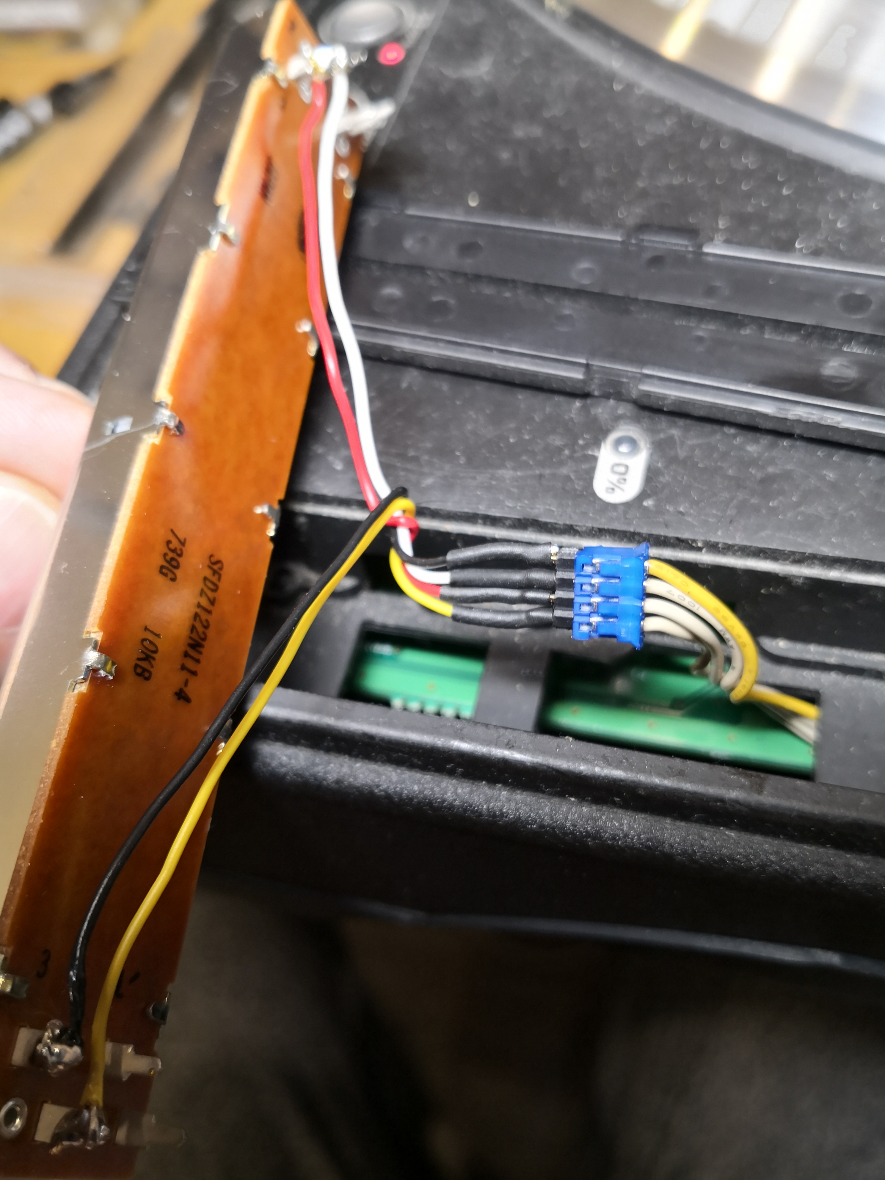

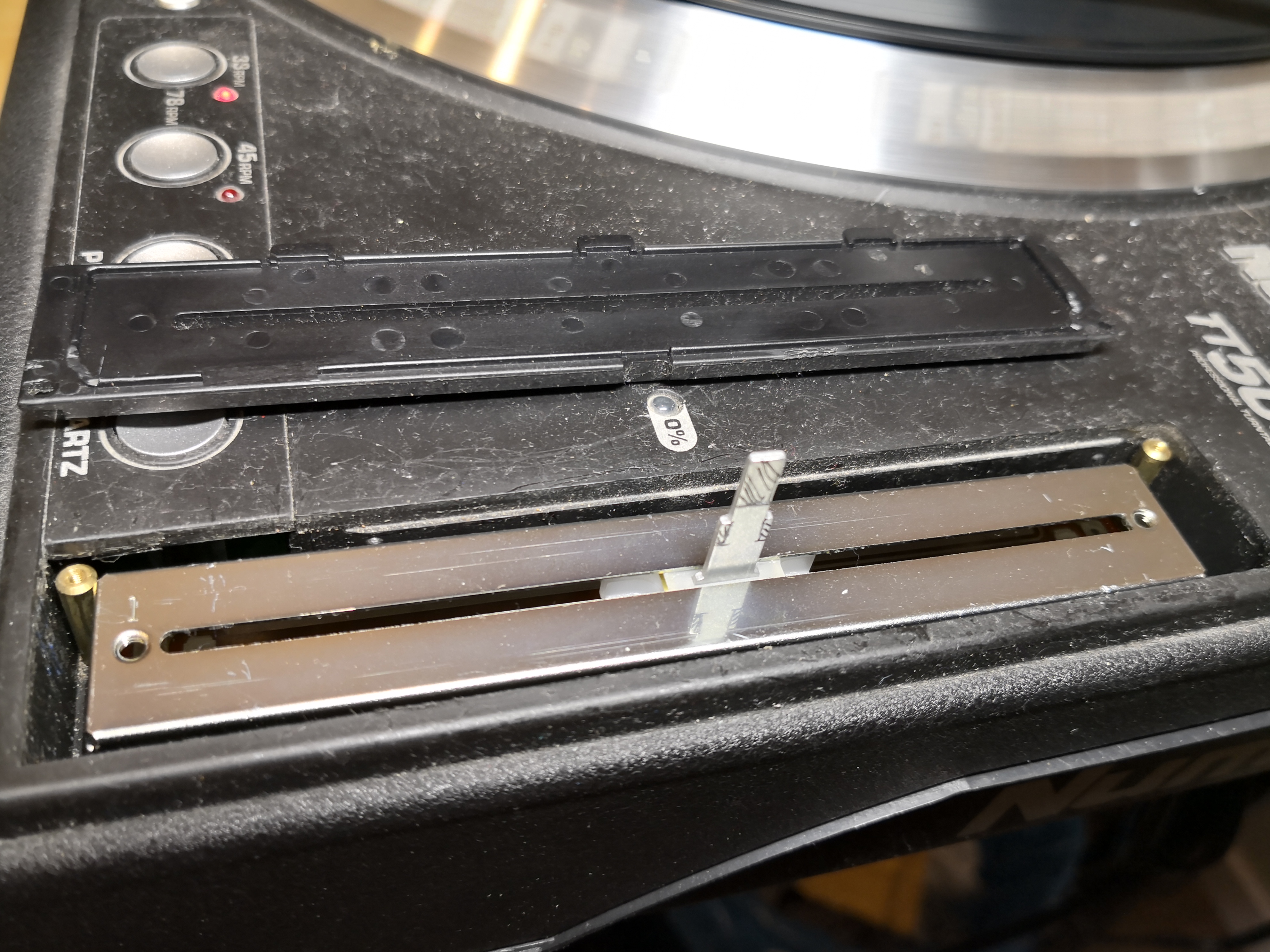

Hi there.
I just had a customer brought to me TT500 with pitch problem. Pitch tracks was dissolved due time wear or some chemicals.
So I was trying to find parts but as all you know original parts is out of stock. Then I replaced with some slider but with no luck.
And then I remembered that I have in stock technics SFDZ122N11-4 pitch that it 10k and 100mm travel. You can find them on ebay.
So.. It worked. It fits perfectly but you need to do some soldering and modify slider shaft.
