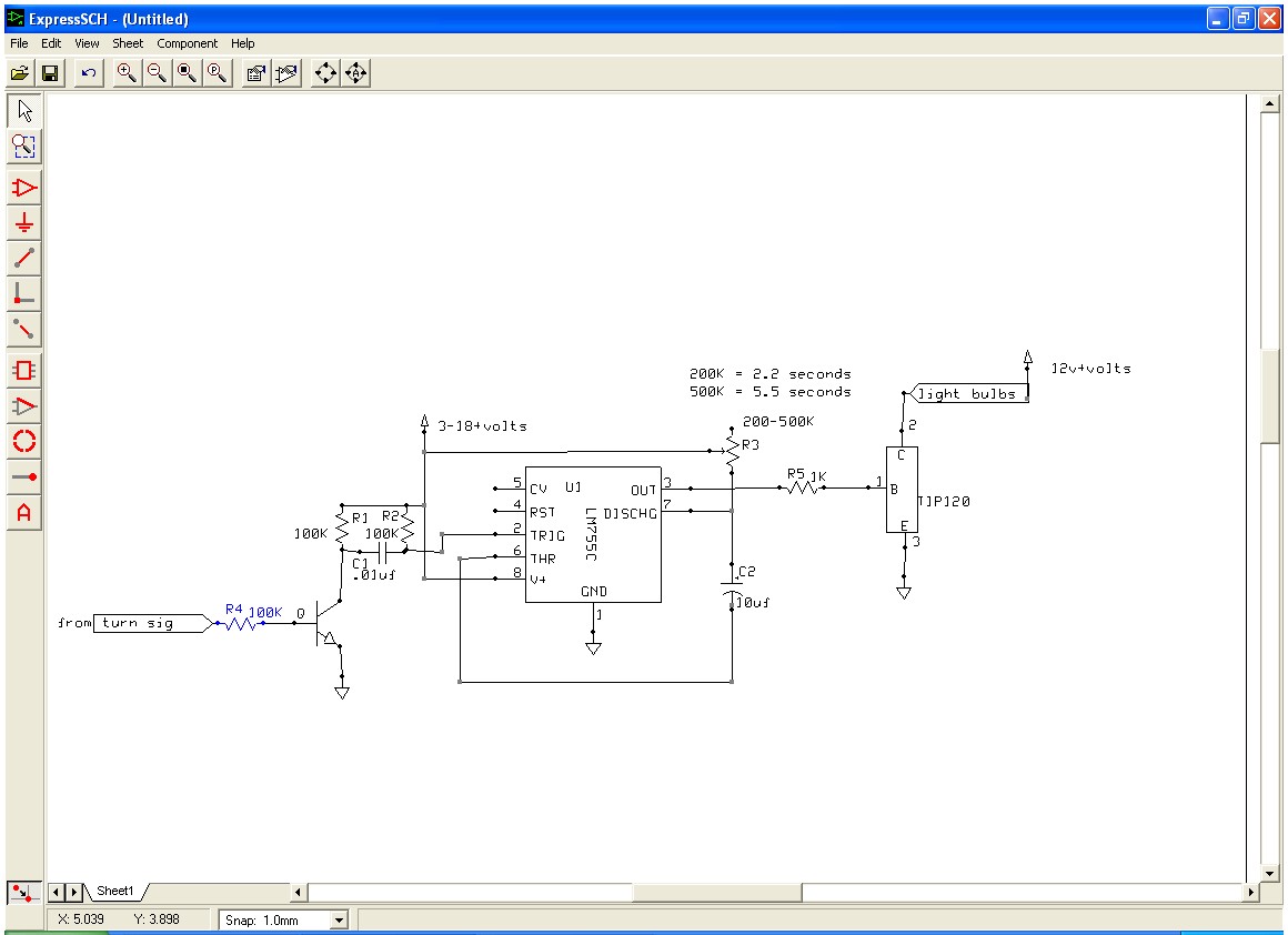

using a 7555 timer
adjust R3 for desired time.
It will retrigger after desired time.
suggest the 2 second time, that way after you make your turn it will shut off because if it takes longer than 2 seconds to make your turm well??
I agree that an scr is too hard to turn off unless you want to spend the $35
the cmos version of the 555 is chosen as it will take up to 18v dc.
an automotive electrical system (read motorcycle) delivers from 12- 14v.
the small transistor can be a 2n2222, all it does is deliver a low signal to the 7555.
the tip will handle I believe 5amps.
You may need to change the base resistor value R5
the circuit should work IMHO

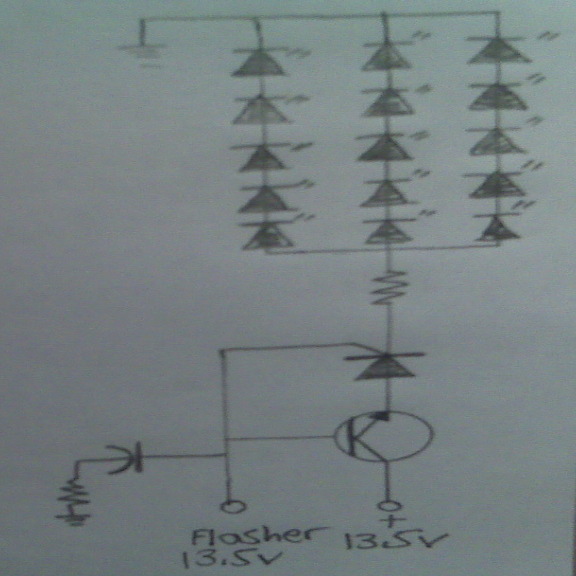

Thanks Mr.Deb for your reply. It's not the $35.00, it's just not what I'm looking for. Is that just a timer circuit that out puts a voltage for a determined amount of time from a one shot pulse. I'm going to attach a drawing of what I had in mind. Keep in mind I have just enough training to make myself think I can do this, but I've also been known to try and re-write the laws of electronics.

Your circuit is all wrong, but that is beside the point.
We need to know how the canceller works. It is time-determined or does it detect something from the steering of the motor-bike?
All wrong? It has everything I need. LOL :D This isn't the first time I've been told that. I believe the canceler works on the tipping motion of cornering. It is in plastic box that contains the whole turn signal apparatus. I thought about cutting in to it but I'm still under warranty and also can't readily get to it.

yes its a one shot pulse BUT!
as long as the turn signal is flashing the timer stays running as the flasher is triggering the circuit.
As soon as the turn signal is cancelled the timer shuts of (thats why I suggest the 2 second time using the 200K / 10uf configuration.

My circuit does all that you want ????
goes from point A to point B but visits point C along the way.-LOL
Can you draw a complete circuit diagram showing how the flasher-unit is connected as a feedback to the 555, as well as the input from the left-turn signal and right-turn signal.
my circuit is an alternative
to a latching relay If I am deciphering this thread correctly.
How many thousands of my circuit will be sold to cycle shops now?
its a cheaper alternative than a relay. perhaps more reliable??

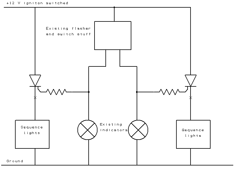

I bought new motorcycle mirrors with sequential turn signals built in. The problem is my flasher wont let them complete. Flasher is an electronic package with built in canceler.
Are you saying that the "on" cycle on the existing flasher on the bike is too short for the sequence of lights on the mirrors?
What I think is happening is this:-
If you power the mirrors from a 12 v battery they flash each of their lights in sequence and then stop.
However, that takes longer than than the "on" cycle of the existing indicators on the bike. You are only getting the start of each of the flash sequence.
You want to provide power to the mirrors until they have finished their sequence.
Is this right?
If so, you could use a thyristor, one for each side of the bike. The circuit assumes that the sequence lights on the mirror stop taking current at the end of the sequence, and that they continually take current when changing from one light to the next. If either of those is wrong, you may need a different circuit.
Also, if you indicate right and then change to left, there is no way of stopping the right mirror finishing its sequence.

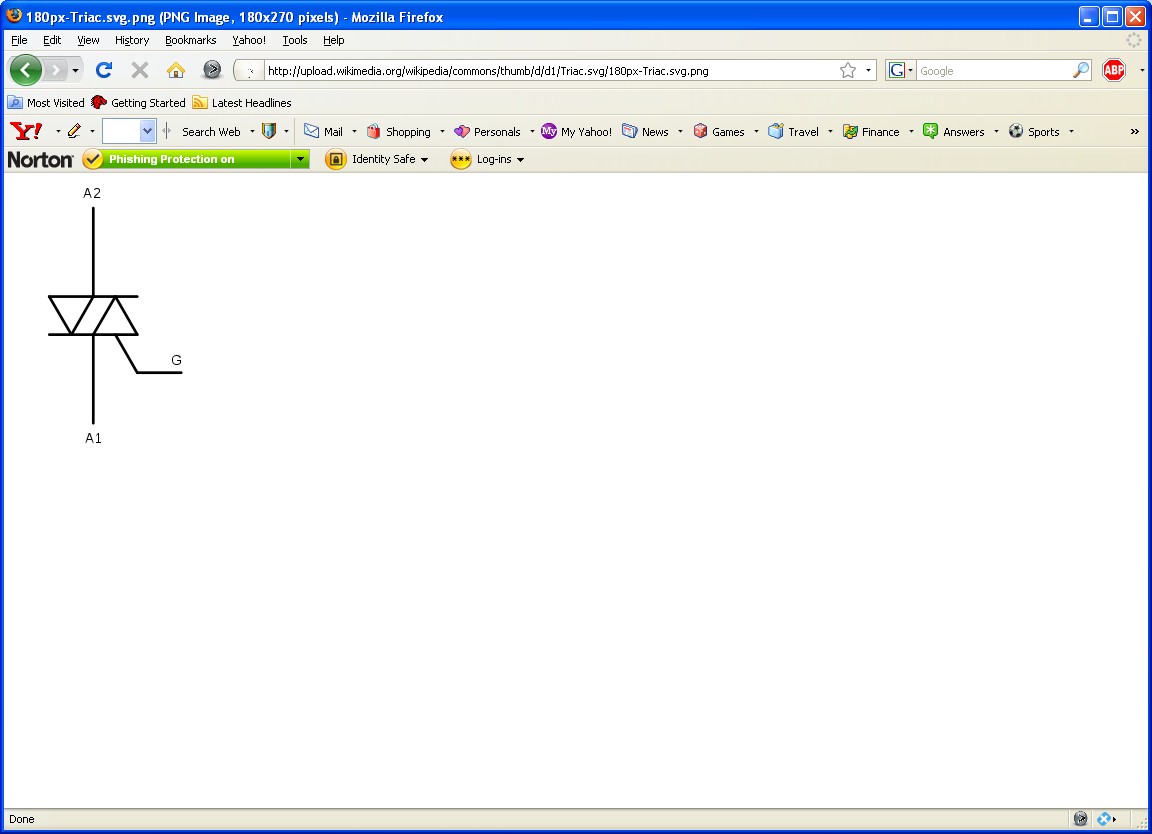

your pic is an SCR
I assume you mean a triac?
the circuit I posted will stop after desired time "on" I would think 2 seconds or less would be sufficient?
a triac can be used for DC.
problem I see is the mirror lights may dim the other lights. you have the lights in parallel. Might cause abnormal blinking??

MrDeb, I'm sorry that is my misteak, the lights have a sequencer circuit in them, they are not in parallel. Dont get me wrong here, I might have to go with your timer circuit as it does what i need. I was hoping to do this without a pc board although it would be small.Diver300 If I connect 12v to the mirrors they sequence until disconnected. Yes the flasher doesn't let it complete the sequence. Does a triac turn of after the signal is gone? I've tried that exact circuit from Diver300, but once on it stays. Unless he meant a triac. Thank you, adown
