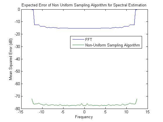

I finished my algorithm, and I've posted my results. The first picture shows the expected mean squared error of the spectral estimation, and the second shows the actual spectral estimation compared to the FFT. Certainly there are better ways to estimate a spectrum than the FFT but I haven't put the time into searching out these methods let alone implement them since its such a quick example. The time domain signal iss(t) = sin(2*pi*10t) + sin(2*pi*8t + phi), sampled at 25 Hz with a time width of 3 seconds. So the fourier transform would be delta functions at +-10 hz and +-8 hz, but note I've not assumed an infinite timewidth or bandwidth, so they're not going to be that exactly.
