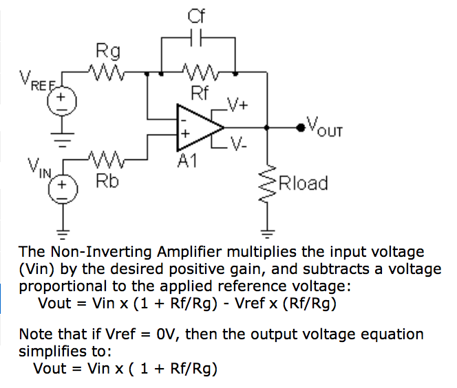

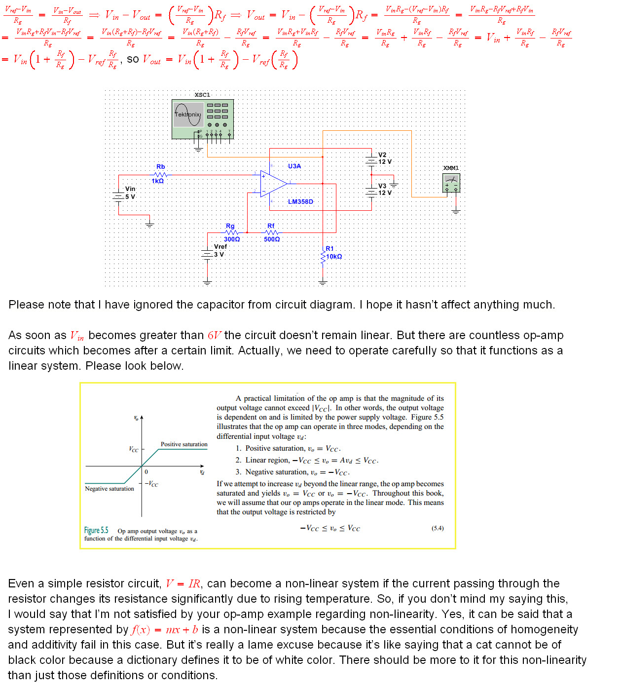

I've attached a picture of a noninverting amplifier. The figure shows the formulas when the voltage reference is nonzero and when the reference voltage is zero. If you look at these formulas closely, you will realize that one of them is a y=mx function and the other is a y=mx+b function. And, that's all there is to it. If your input and output voltages are referenced to ground, and your opamp is referenced to Vref with Vref not equal to zero, then it's a nonlinear circuit, even when the signals are all in the linear range of the opamp itself.
You are quite correct in saying that it's a trap and I have already fallen into this trap and hit my face on a box full of rotten tomatoes! :(
Now, wipe the rotten tomatoes off your face, pick yourself up and pat yourself on the back for learning yet another important lesson. You're on the road to becoming an expert because the person you perceive to be the expert is always the one that keeps getting up and has wiped more tomatoes off his face than you have. :)

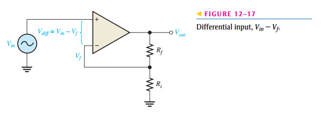

Let's talk about op-amp in general. An op-amp always amplifies the differential voltage of its inputs. I believe it functions as a linear device when it has a negative feedback because then it adjusts its output in such a way that the differential voltage is almost zero, and its input is also almost zero. In short, the negative feedback is what makes it a linear device. It has been quite a while since I took op-amp course so please correct me I'm wrong or missing some other important detail here.

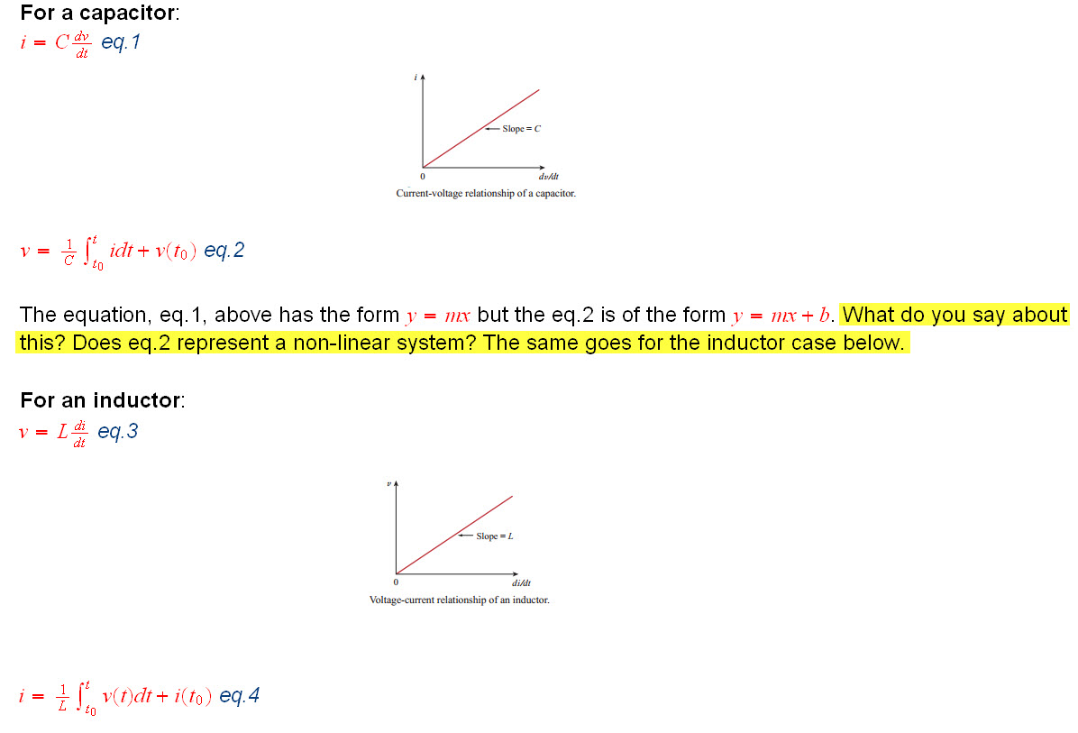

Let's take a look at reactive elements which are mostly considered linear devices. Please have a look here and kindly help me. Thanks.

For the cap and inductor, derivatives and integrals are linear operations. Check it mathematically if you don't see this. These operators are not line functions y=mx+b.
For the OPAMP, I just showed you an OPAMP circuit with feedback that was not strictly linear. But, generally opamps are considered to operate linearly within the power supply range when there is good feedback. However, even when there is good feedback, you must remember that the linearity is only good at low frequency. At high frequency the feedback gain is reduces and you will see the nonlinearity of the opamp circuitry, and OPAMPs also have slew rate limits which is clearly a nonlinearity.

...derivatives and integrals are linear operations.
Yes, they are linear **broken link removed**. But I take linearity of systems and linearity of the operators as entirely different things. Perhaps, I'm missing something.
Moreover, now I think that I came up with bad examples here. Do you think a capacitor or inductor can be looked as systems in themselves? To me, they are devices and not systems. A good example of a system would be an RC circuit made up of two linear devices, a resistor and a capacitor.

An RC circuit in zero-state is a good example of a linear system (likewise, I believe an LC circuit is also a linear system). But I was missing an important term from the definition of a linear system, i.e. "zero-state response".
But an RC circuit which is not in zero-state (i.e. with capacitor charged) is not an example of a linear system.
It has been said that a system represented by a function of type f(x)=mx+b is not a linear system where "m" is slope and "b" is constant. I believe it can also be written as output=m(input)+{output even when the input is zero} where "m" is slope. Please correct me if I'm wrong. By the way, in view of the definitions such a function, f(x)=mx+b, cannot represent a linear system because it contradicts the requirement the system being in zero-state.
OK, you can take them differently if you want. But, you asked about caps and inductors and showed the relations. Those devices are defined by the linear operators (i said operators, not operations).
Do you think what I said above is correct? I'm asking this because I would like to know if I have the fundamental concept correct. It has been quite a while since I studied op-amp.
Sounds fine to me.
Theses are considered to be linear systems. If something causes an offset nonlinearity, or other behavior that appears nonlinear, in these systems, you can easily identify it, in your context, by applying the definition of linearity. Rarely do you need to worry about it in linear circuit theory.
Zero state response is specified to eliminate the natural response to initial conditions. These natural responses are not responses to input signals.
Yes.

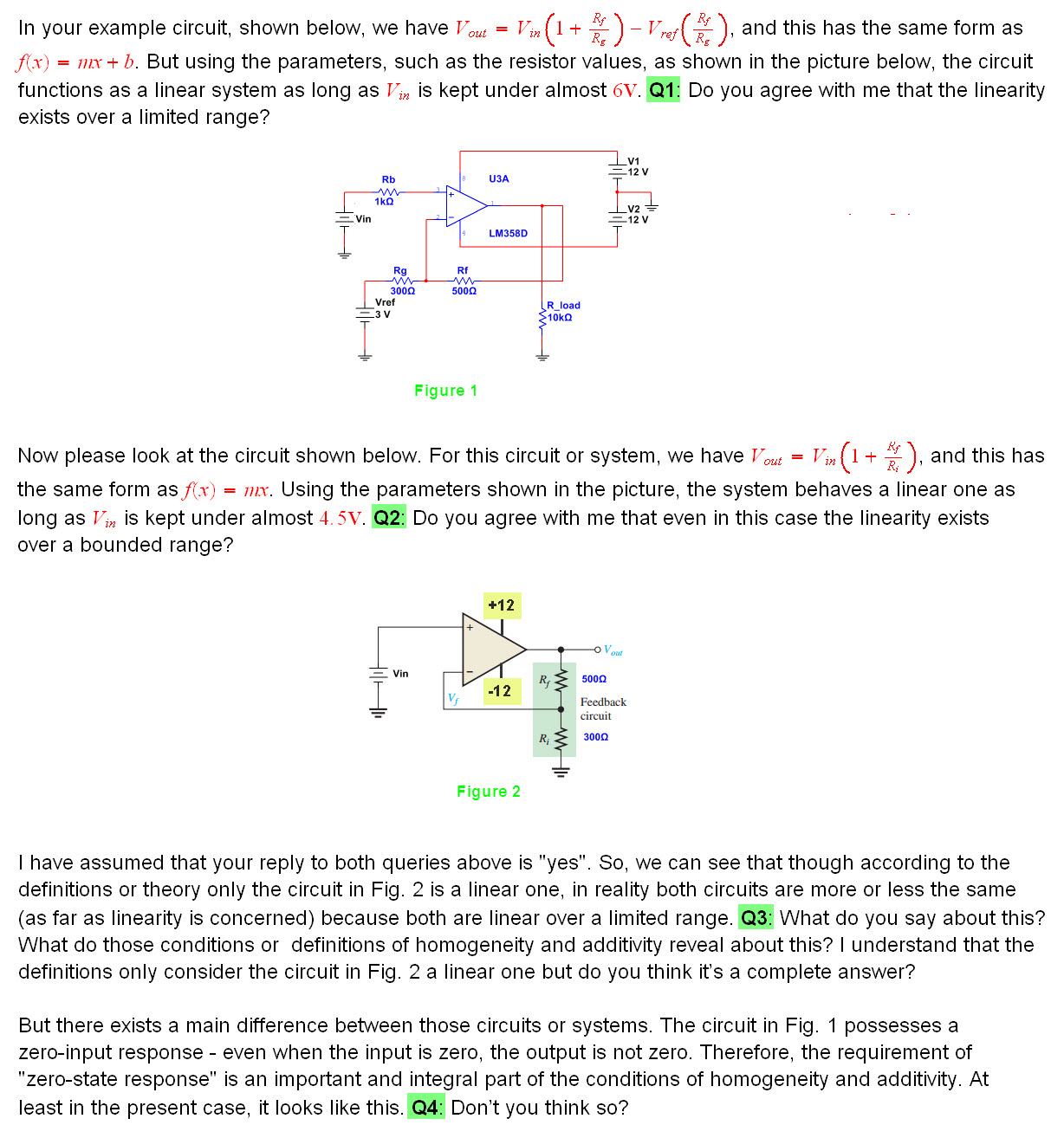

I still need to confirm few details from my previous post because I'm not sure if those have been answered directly. But first I will focus on the main issue.
Please have a look here and kindly help me with these four queries. Thanks.

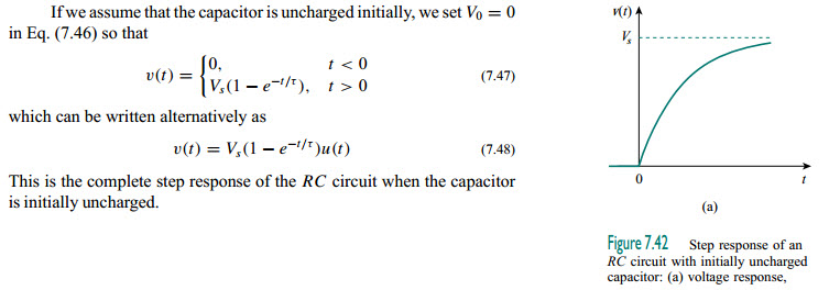

Q6: Almost every circuit has two kinds of responses, transient response and steady state response, where transient response dies away as the time tends to infinity. If it is said that a circuit or electrical system is a linear system, it means that the relationship between input and output is of linear nature. Let's focus on an RC circuit in zero-state with a DC power supply. You can see here that it is a linear system even in view of its transient response in addition to being a linear system in steady state. If an electrical system is a linear one considering its steady state response, then does this mean that it is also linear system when its transient response is considered?
Q7: For an RC circuit the transient response is given as Vout(t)=Vs{1-e^(-t/RC)} where Vs is a DC supply. Let's take R=0, then Vout(t)=Vs{1-1}=0. Could you please tell me that why this is so?

OK, we must be going too fast here. I'm not going to try to answer all these questions until we deal with question #1.
Why do you think my answer to question 1 would be yes? I've already giving that circuit as an example of nonlinearity. I was clear that the nonlinearity is not due to the supply rails but due to the offset from the voltage reference. So, strictly that circuit is nonlinear.
However, if you re-reference the input and output signals to the voltage reference, it is linear again. Also, that circuit is linear to AC signals that operate around a DC operating point.
Until we are clear on this, we can't go any further.
Thank you, Steve.
If for the sake of argument, we can omit the qualifier "strictly" then would you agree that the circuit in Fig. 1 exhibits linearity at least over a short range? It's fine to me even if we don't omit the qualifier because then I would say that the circuit in Fig. 2 is also a non-linear one in strict sense of the word.
I'm not disputing what you have said but rather I'm being a kind of naughty skeptic! :) Thanks.

Your wording is very confusing. When you say 'over short range', what does this mean? Are you talking about AC operating around a DC bias point?
Also, Fig. 2 is non-linear only because of the supply rail limits. Within those limits, it is strictly linear.
So, we are seriously miscommunicating here.I'm not sure that you are getting it yet.
Thanks.
Actually I was just thinking of Vin as a variable DC source in both figures. For Fig. 1, if you vary the voltage between 0V<Vin<6V, the op-amp system functions as a linear system, and for Fig. 2 the range is 0V<Vin<4.5.
I'm sorry if it's still unclear. Please let me know if that's the case so that I can try to ask it differently after giving it some time and more thought.

I still don't understand your basis to say that Fig. 1 is operating as a linear system. I've stated that it isn't linear for the reason that it does not meet the definition of a linear system. I pointed out the two cases (in/out referenced to Vref and AC around a DC operating point) where you can say it's linear. If you are talking about one of the two exceptions I mentioned, then we agree. If you are saying it's linear for another reason, then I don't understand why you think it's linear.
Are we talking about the Figure 1 op amp circuit with Vin and Vref=3v?
That circuit is not linear in the strictest sense, but we often refer to it as linear because it responds with a straight line. It does not meet the mathematical definition but it's still referred to as linear in many cases. It depends how you look at it. If the next stage is also biased for example we might deem the whole circuit linear.

Also, in another post i noticed the question about Vc=1-e^-t/RC and letting R=0, but that's not really possible because that equation assumes a voltage excitation and with R=0 that would mean we would be applying a step change in DC voltage right across a lone capacitor, which gives rise to infinite current so is not allowed really.
If we did allow it in theory though, we would find e^(-t/RC) as R goes to zero to be equal to 0, so we would have:
Vc=1-0=1
not:
Vc=1-1=0
anyway.

The time response of an RC to a voltage is non linear.
Thanks, MrAl. Yes, this is exactly what I had in mind and was trying to convey. Mathematically or according to the system theory, it is not a linear circuit or system because it doesn't comply with the definitions of homogeneity and additivity.

What I have to say is that you shouldn't call a system that responds with a linear function (y=mx+b) a "linear system" unless b=0.
If Q1 is meant to ask if Fig. 1 and Fig. 2 behave as linear functions (and not linear systems), then I will say yes, they are linear functions within the range of the power supply rails. However, Fig. 1 is not a linear system, while Fig. 2 is a linear system (assuming ideal components) provided that the output is within the range of the power supply rails.

Actually what I was trying to say was that the circuit from Fig. 1 is also, loosely speaking, a linear system. I don't see why we can't call it a linear system when the relationship between the input and output is of linear nature. I believe you don't like to agree with what I say because it goes against the definitions. But then I would say that remember your opinion about those "math guys" who love to look at every math detail in strictest sense of math definitions just to frustrate engineers like you.

Anyone is free to create their own definitions and use them as they like. The main problem with this is you can then run into communications problems by not using standard terminology. Having clear definitions is just as useful in engineering as in mathematics. So, when you break tradition and modify definitions, you have a responsibility to clearly define your terms so that people know what you mean.
In system theory, linearity is a critical property that allows great simplifications for analysis because superposition can be applied and Laplace/Fourier theory is much more fruitful in application. So, "speaking loosely" is a very dangerous thing to do for engineering reasons. Why? Because if I do a stability analysis on a system that I think is linear, but really is not, and use linear theory to make conclusions, I may predict adequate stability margins are in place, when in reality, the system may not have good margins. Hence, people could be killed and/or money could be lost. Who will be "frustrated" then?
