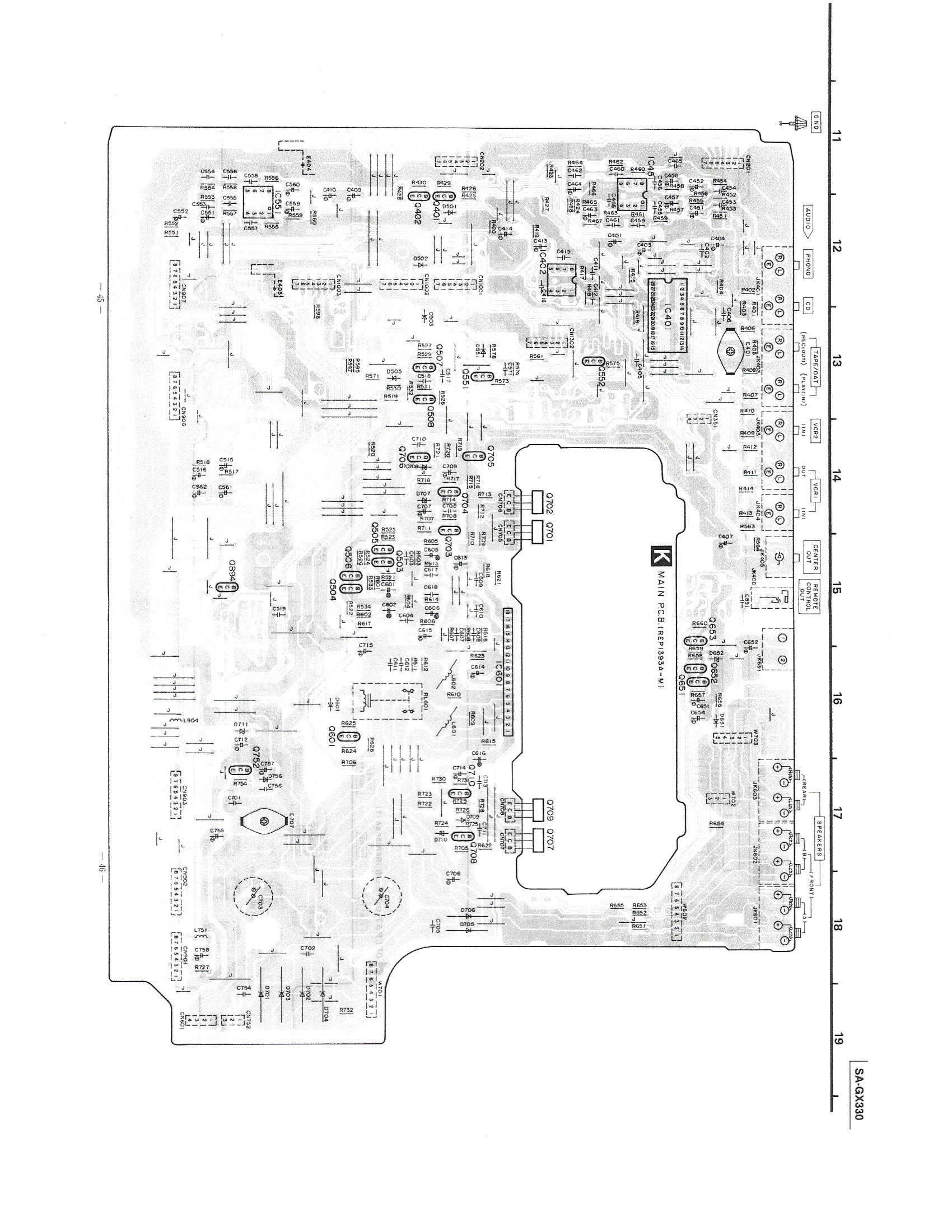

But I have hit a snag. Recapping a 1992 Technics SA GX330 home receiver, and I have found some radial electrolytic caps that look non polarized. Also the board icon shows it looks like a standard ceramic disk cap.

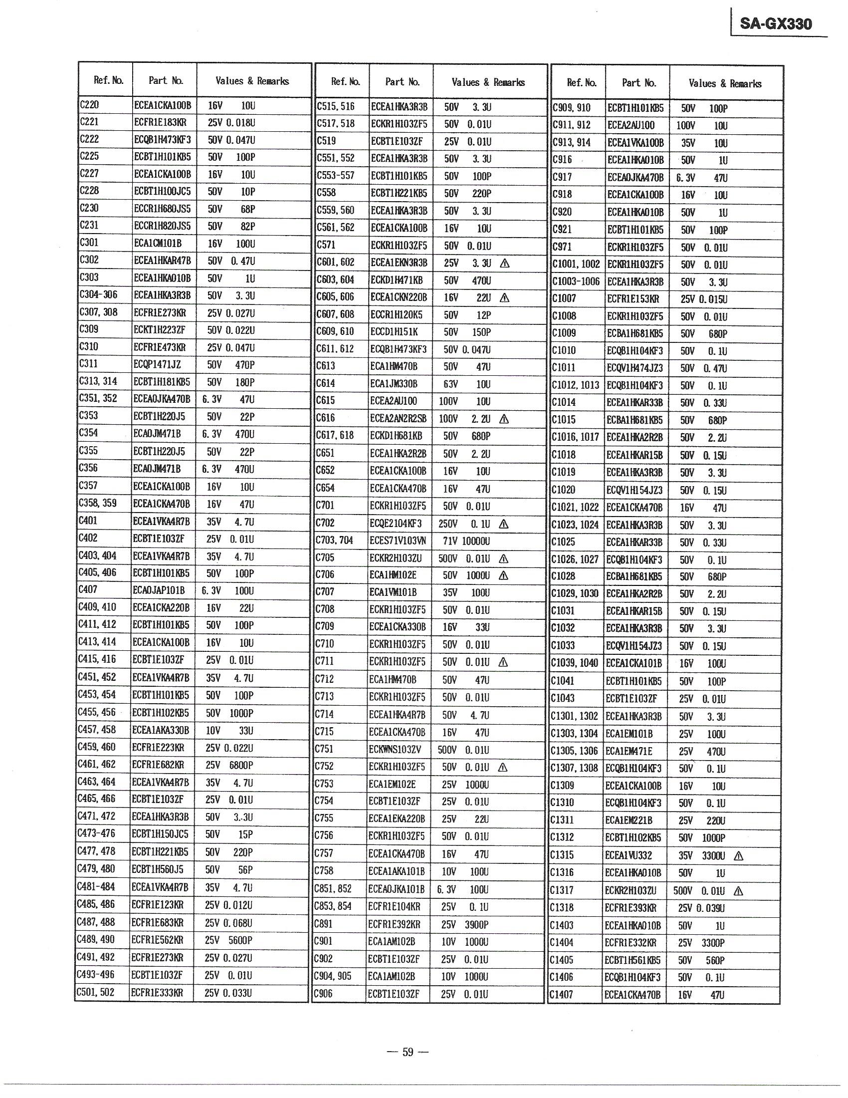

Thank you for all the responses. I now have the correct service manual for this model. I am trying to screen shot a pic of the main PCB schematic I have in my PDF that has the caps in question for those who asked. The schemo symbol is similar to a polarized but slightly different and also has a capital N inside a circle just below it. I assume this means non polarized?
If the power supply is positive and negative then many coupling capacitors should be non-polarized.
Ok, think I got it. Caps in question are C606, 605, 602, 601, 616, and may be 1 or 2 more.

The capacitors you listed have a Note 1 on the parts list. Does Note 1 say that they are non-polarized or say a non-polarized type like a film type?
audioguru, that is an exclamation mark inside of the triangle. The manual specifies that this means that the component is or has fire retardant materials, high quality audio properties and low noise. Parts list says nothing about non polarized caps.
